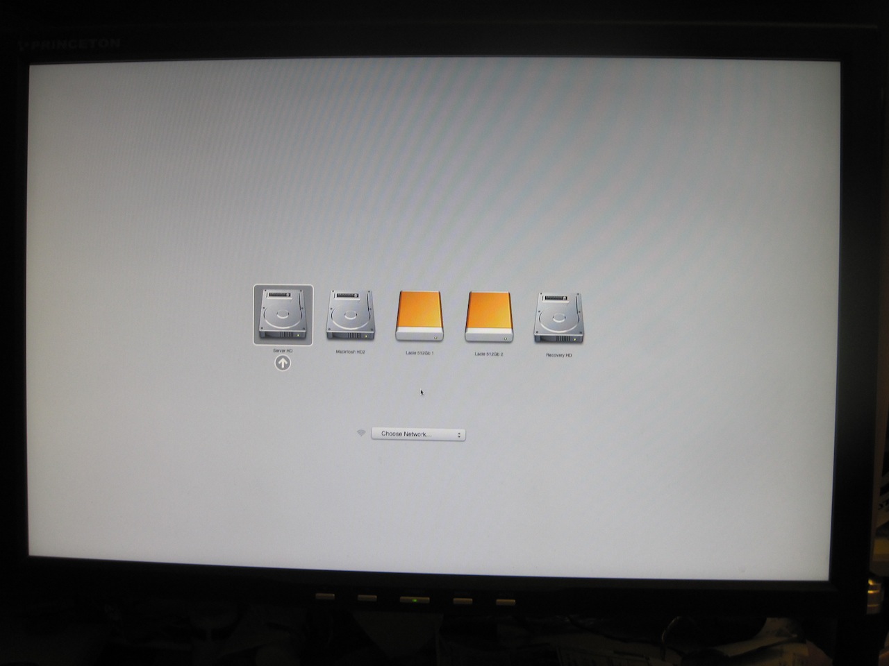

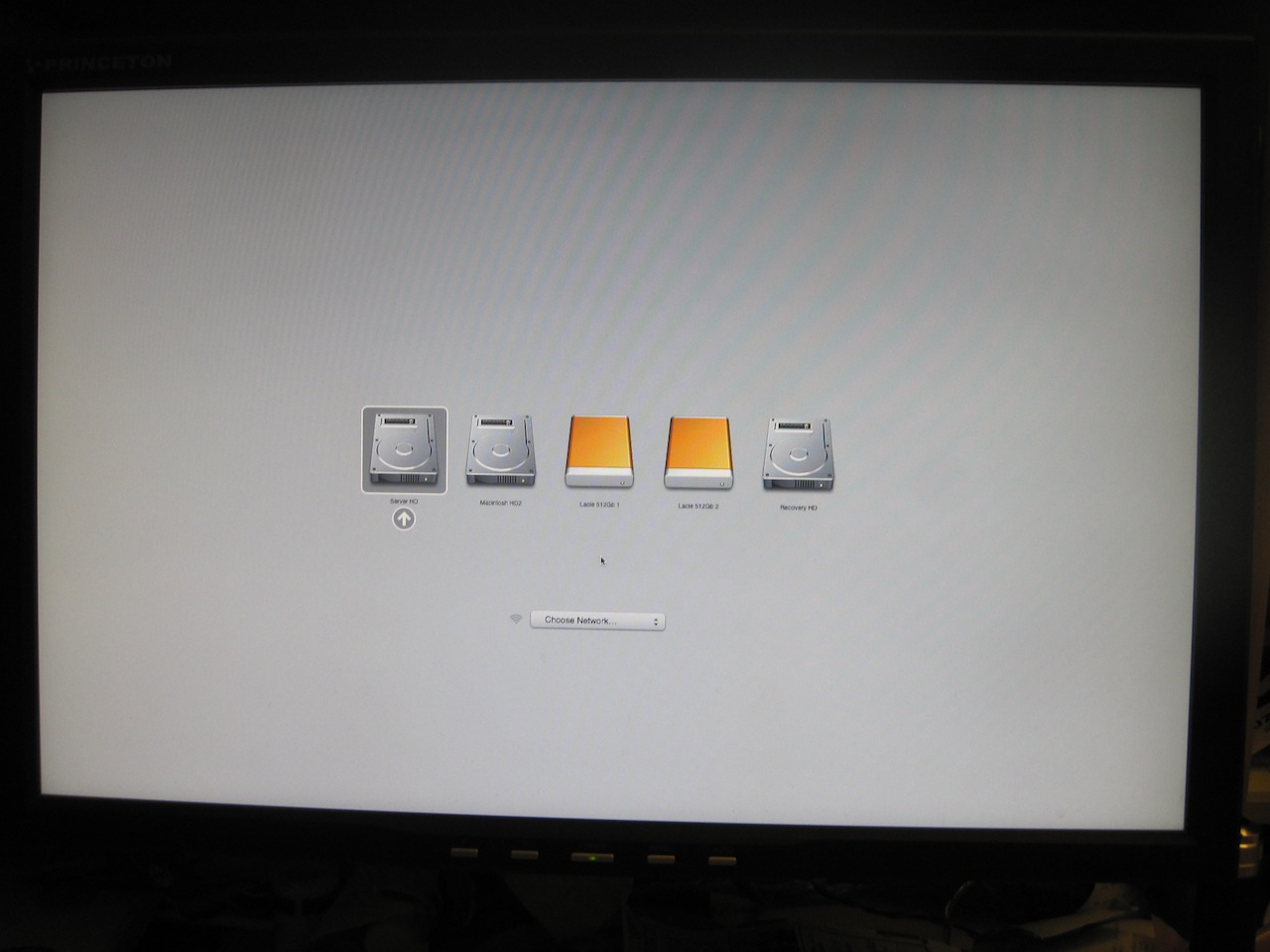

if it is turn it off then boot it with your finger on the option key of your keyboard this should bring you 2 hdds to pick from pick the recovery one and it should let you get in. an other way is attach a lion hdd via usb or fw800 use the option key and pick the usb hdd to boot with.
you pretty much have locked yourself out the 2011 mini server is strict about sign in. I will post a screen shot of what you should get if you boot with the options key pressed.

so you get server and recovery on the screen below?
I could say try over and over and over and over and over and over. Or I could say attach a lion osx made on a 2011 mac mini like I have done below. then pick the osx and boot with it.
if you don't have a hdd with a 2011 mac mini lion osx on it . the osx must be from a 2011 mac mini.
pm me if you are in the usa. if you are over seas go to an apple store.
