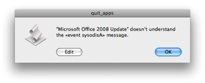

Also, during the installation I got this error in both 12.1.1 and 12.1.2 (it appeared behind the actual installation window so had to move it in order to be able to click anything). The installation wouldn't continue until I clicked OK.

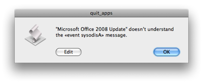

Issues where Installer appears hung (see thread 36) - alert that does not make sense
Due to a recent Apple update, the Apple Installer (which we use for our updaters) will block AppleScripts run in an installer payload from having the Installer bring up a dialog.
Our updaters prior to this current updater used an AppleScript to have the Installer bring up a dialog telling you if still had a Microsoft Application running when you were trying to update.
Therefore, if you have updated Leopard with the latest update (available at the beginning of August) and you try to run the Office 12.1.0 or 12.1.1 updaters while leaving Office Applications running you will see the alert described in Thread 36.
If you continue through the installation (after clicking OK on the alert 3 times or so) there is a chance that your installation will not work right (because you were updating a running application).
It is strongly recommended that you quit all your Microsoft applications prior to running the updater. If you do this, then you will not hit the alert with 12.1.0 and 12.1.1.
We were made aware of Apple's change in the functionality of the Installer too late to make any changes to 12.1.1 and 12.1.0 and still get 12.1.2 out on time, but we are looking to see what we can do there with those patches.
