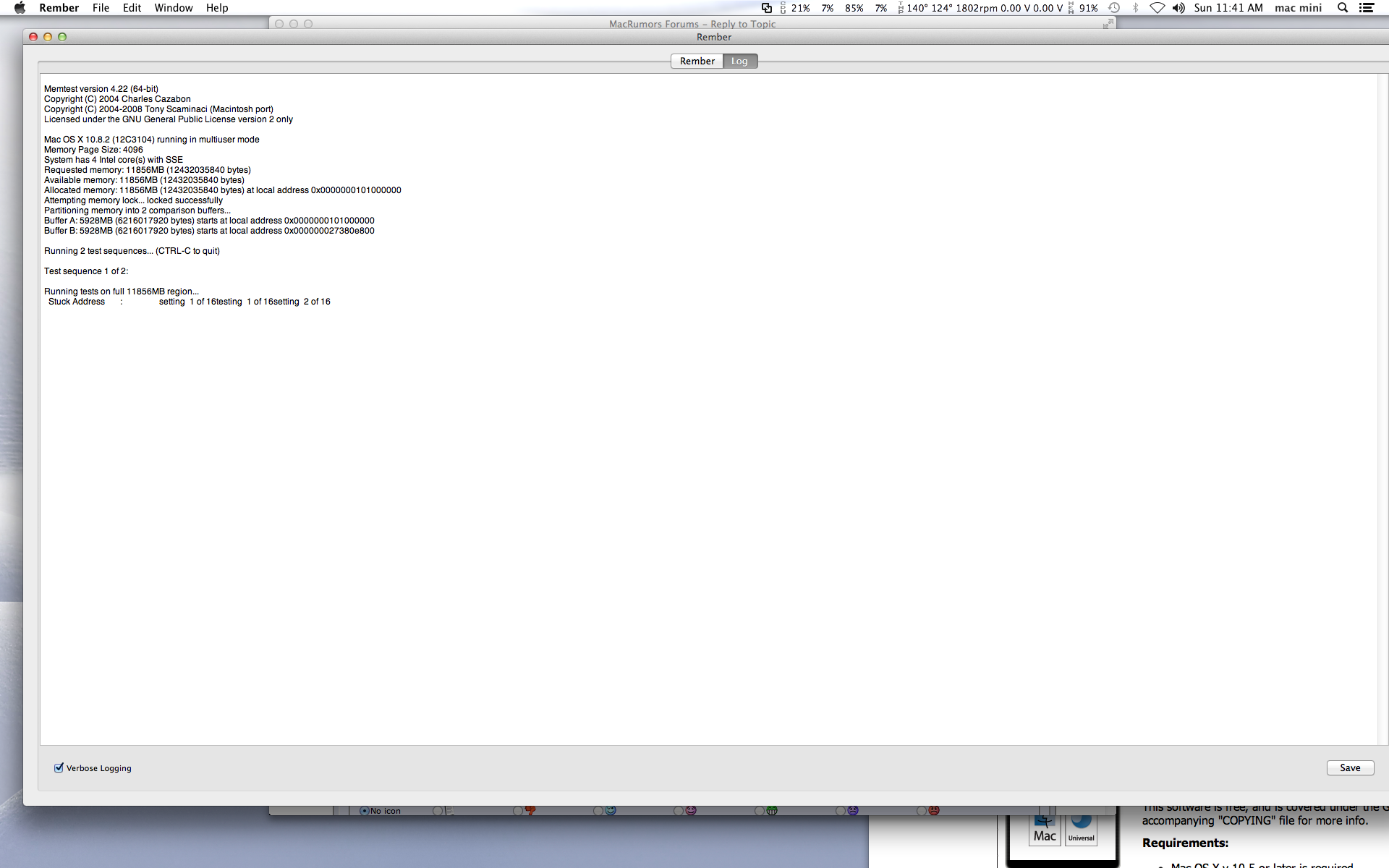

I would test with this program
http://www.kelleycomputing.net/Rember/
all 2010 ram in 2x 4gb would fail to memory lock.
the first thumbnail shows 16gb ram in a 2012 and it passes memory lock.

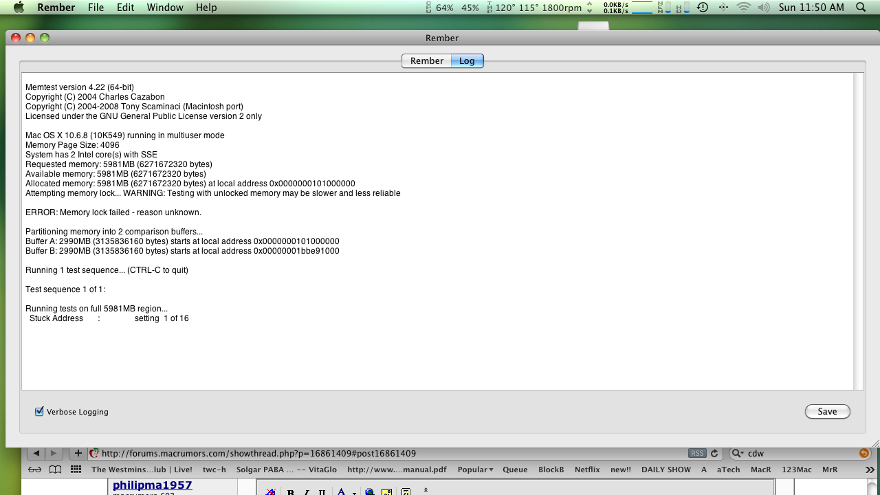

I will walk to a 2010 with 8gb ram and do a thumbnail that will show memory lock fails.
this is true of all 2x 8gb ram in a 2010 mac mini. I do not know exactly why the lock fails but I believe this is what make the 2010 mini so picky with 2x 4gb sticks of ram.
I am now on my 2010 mini with 8gb ram 2x 4gb sticks the second thumbnail shows failed memory lock. I will run an hour ram test to the end and show what a passed test looks like. in the case of this 2010 the only fail allowed is memory lock.
in a 2011 or a 2012 no failures of any kind should happen
