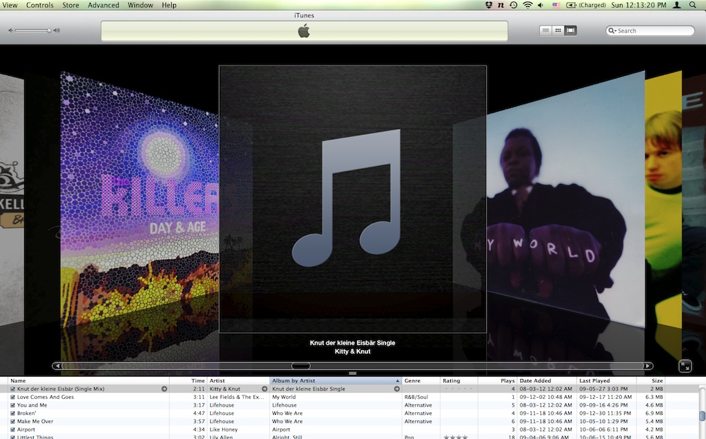

The second problem I've noticed is that Itunes is constantly having trouble rendering album art placeholders correctly(third screen shot attached), and it is even worse than the Top Sites problem as no matter what I do, it won't fix itself. Although the weird patters do change a bit some times.
