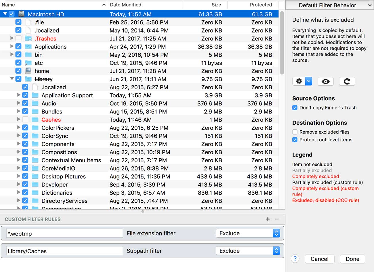

Actually, not necessarily. Most cloning apps (Carbon Copy Cloner and Super Duper) have an option to include/exclude files you want copied/cloned.
I used Carbon Copy Cloner, which had a Finder-like filesystem tree from which I was able to exclude files/folders I didn't want copied over.
