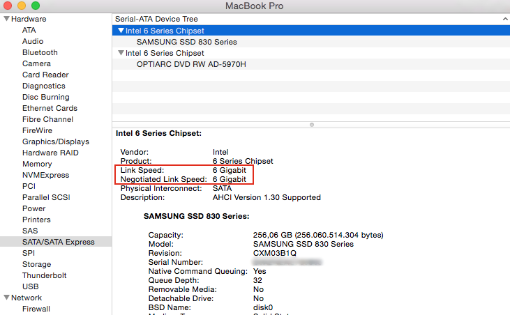

It's also a little strange to me that it says "Not supported" under SMART status for the HDD.
Can you just look here for me, and report what it says about the Apple HDD?

Here you go
Intel 7 Series Chipset:
Vendor: Intel
Product: 7 Series Chipset
Link Speed: 6 Gigabit
Negotiated Link Speed: 3 Gigabit
Physical Interconnect: SATA
Description: AHCI Version 1.30 Supported

- As I suspected, it has negotiated the link speed at SATA II with the hard drive (which is normal and perfectly fine).
It's entirely conceivable that you have a hardware defect that causes problems with SATA III but not with SATA II connections.
Either
1) try your luck with another SATA cable (sourced from a reputable place such as Ifixit), or
2) try the optical bay solution I linked to above.

I got the cable from ifixiteurope today and it detected it 1st time with correct name etc..and now shows 6gb on both
Negotiated Link Speed: 6 Gigabit
Thanks for that, seems either it's counterfeit or i was given an older cable that couldn't detect sata 3, i have emailed apple with pics and the codesto see which
