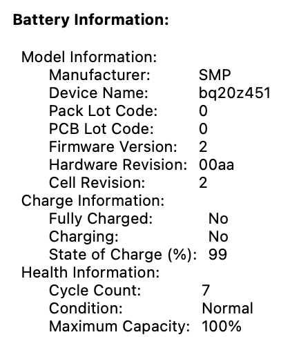

This is my battery info, and the condition says "normal", and it does so in iStat menus ánd Coconut battery. I misjudged the cycle count and it turns out to be 7 and not 40. Could this have something to do with another component in the Mac? I thought I read somewhere that someone had the same issues which were caused by the I/O card? Would it be wise to just get a new machine? Or hang onto it for another month until apple silicon Macs start rolling out?

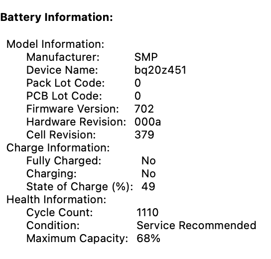

I have a mid-2014 13" with a terrible battery and the cpu still runs at full speed whether it connect to a charger or not.
I doubt the I/O card would have an issue since it is able to charger the battery. The only component I can thing of is the current battery but you won't know for sure until you try another battery.
