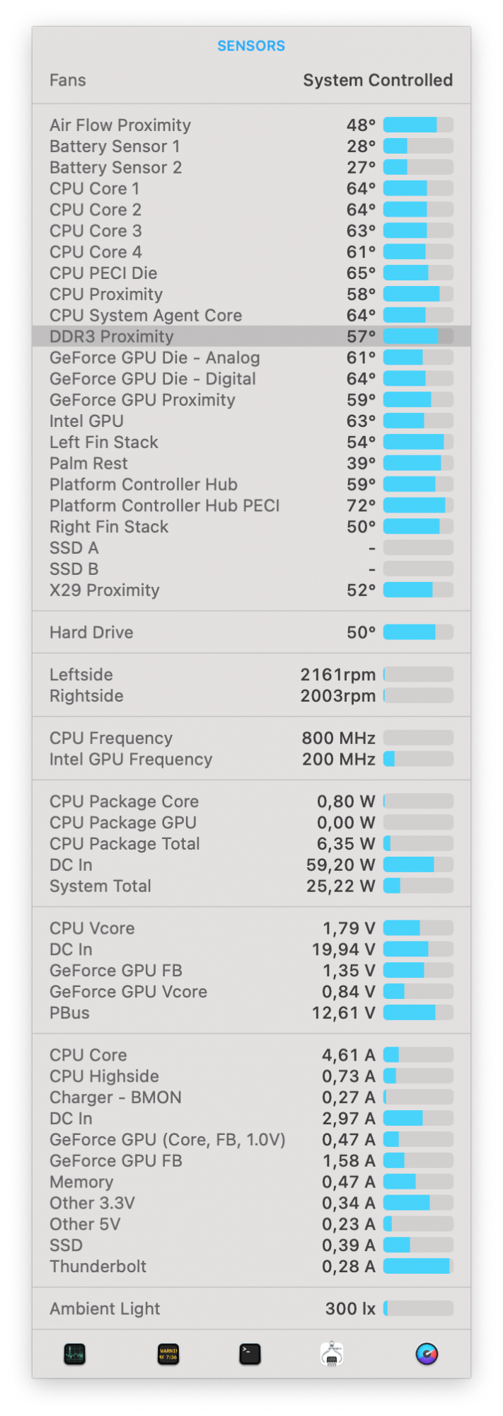

The temps seem normal on every sensor, and the command comes back without a warning and a speed limit of 100. It seems to work OK for now, but every couple of hours it seems to go haywire and gets practically unusable. Even saving a illustrator document is too much for it, and causes everything to crash.
So if a user uses fan control utility to limit the fan speed on their mac, and the dGPU temp spikes, the macOS will order the CPU to throttle to prevent GPU overheat. (As they share the same heatpipe by design) (I learned this first hand trying to silence my Macbook Pro from heating up with external monitor connected. Forced the fan to go slower, it throttles the CPU!)
I use MacsFanControl, but in a different way. I have it set so that when either the CPU or GPU hits 80C the fans go at full speed, and they start ramping up above 50C. My MBP is noisier compared to the stock settings, but gives way better performance.
Leave the pmset command running in the background and keep the monitoring software running. And check the stats as soon as they slowed down again.
Well, after having tried out my original battery, still the same result. I recorded one of these panics with the command in terminal:

I've got no clue what's triggering this. I set the fans via MacsFansControl to fans ramp up to 100% when the dGPU hits 55C and the CPU 85C... If it would be the dedicated graphics, why would my CPU be throttled down to minimum speeds?
For reference, these are the temps recorded by iStatMenus. The only temperatures on the high side are:
- The Air flow proximity. though this is because I'm using the machine in clamshell mode, when I'm using the machine as a normal laptop these temps are lower, and stay low even when it's freaking out at 800MHz.
- The DDR3 proximity. For some reason the RAM proximity is a little toasty, but in my opinion not too hot.
- The left fin stack. Probably also because of the use in clamshell mode.
- The PCH PECI. For some weird reason the chipset is partially cooking itself, but ramping both fans up to 100% has no influence on these temps at all.
I'm clueless as to what the cause of this problem might be. It seems to come out of nowhere. It occurs when I'm just browsing the web on a forum, or doing 3D modelling in Blender. The workload doesn't influence anything.
I really wanted to buy a Mac desktop and have my MBP for the 1 time a week I go to college. Seems like that plan can go out of the window and I'm going to have to buy a new MacBook.
I really wanted to buy a Mac desktop and have my MBP for the 1 time a week I go to college. Seems like that plan can go out of the window and I'm going to have to buy a new MacBook.View attachment 963494
the stats look interesting as even if CPU is at 800 mhz, the temps are still quite high (in the 60s) It's a dumb question, but have you changed the thermal paste in there? or dusted the fans? (As you might have checked already)
I changed the thermal paste 2 times in the last month, first because I also thought that the idle temps were quite high, so I applied Kryonaut to replace the previously installed conductonaut. The temps seemed quite high after the first change so I thought the application wasn't good enough, so I did it again, but the temps stayed the same. I "disassembled" the fans (took the metal cover off) and gave them a good clean, so they are also dust-free.
The screenshot of the temps above is from when the MBP is at 800MHz, and to me nothing seems to be the trigger for it to go haywire...
That's what concerns me. @ 800 mhz I don't think it should ever get that hot. (It's hotter than my rMBP 2015 at normal idle speed)
