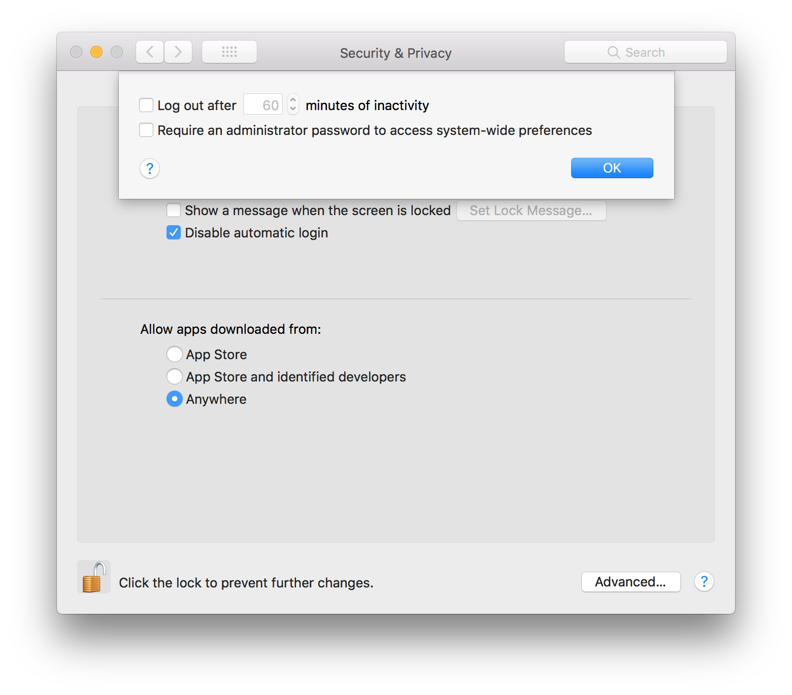

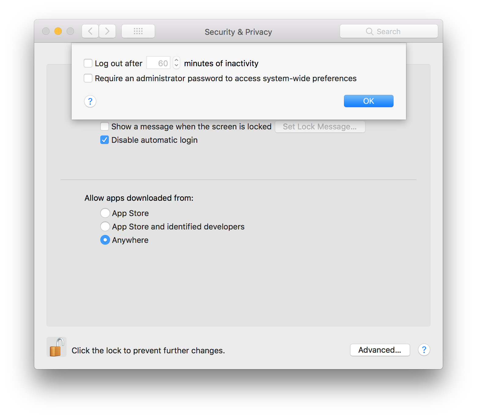

Try checking System Preferences » Security & Privacy » Advanced, and see if "Log out after X minutes of inactivity" is checked. If so, uncheck it and you should stay logged in after your computer goes to sleep.

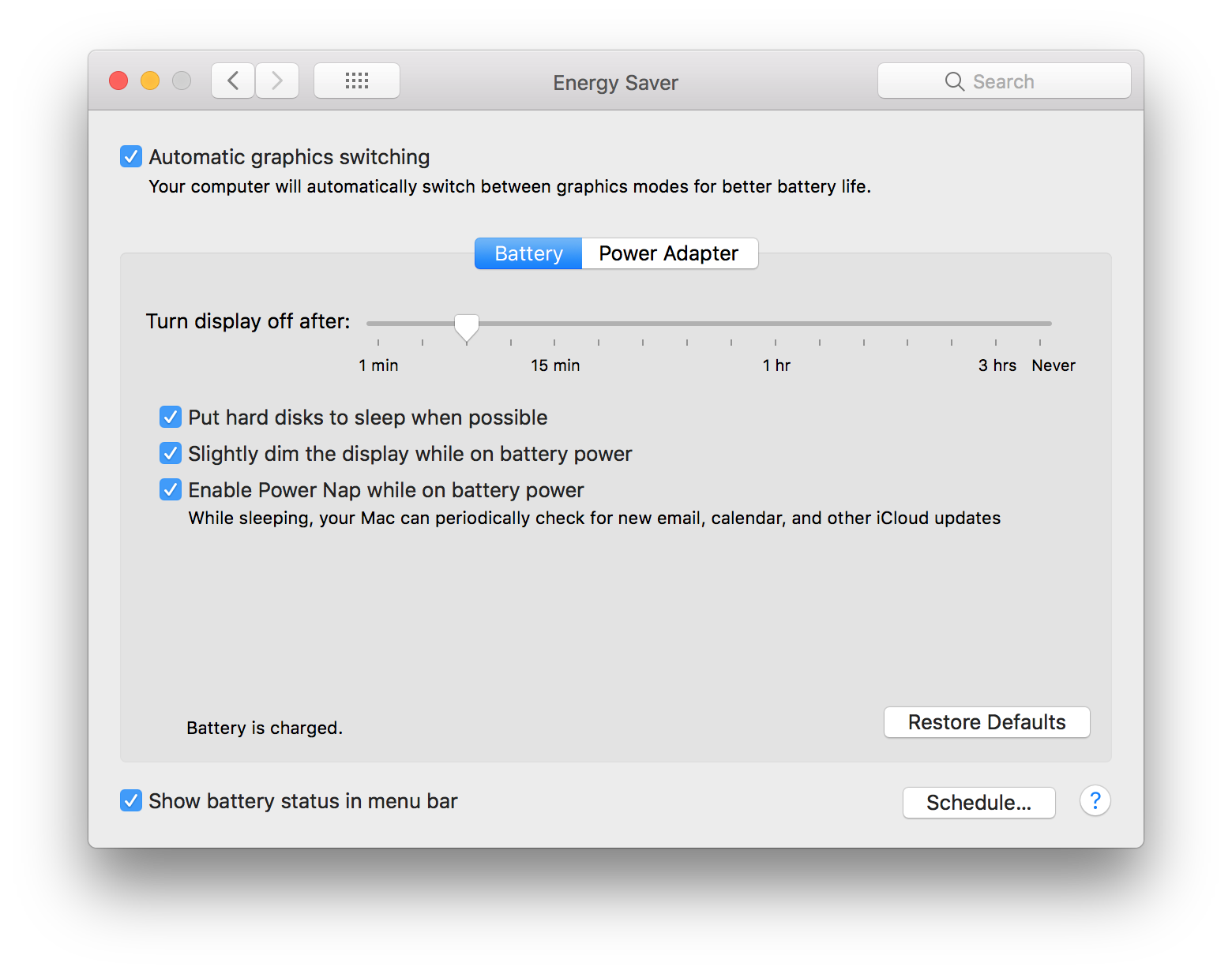

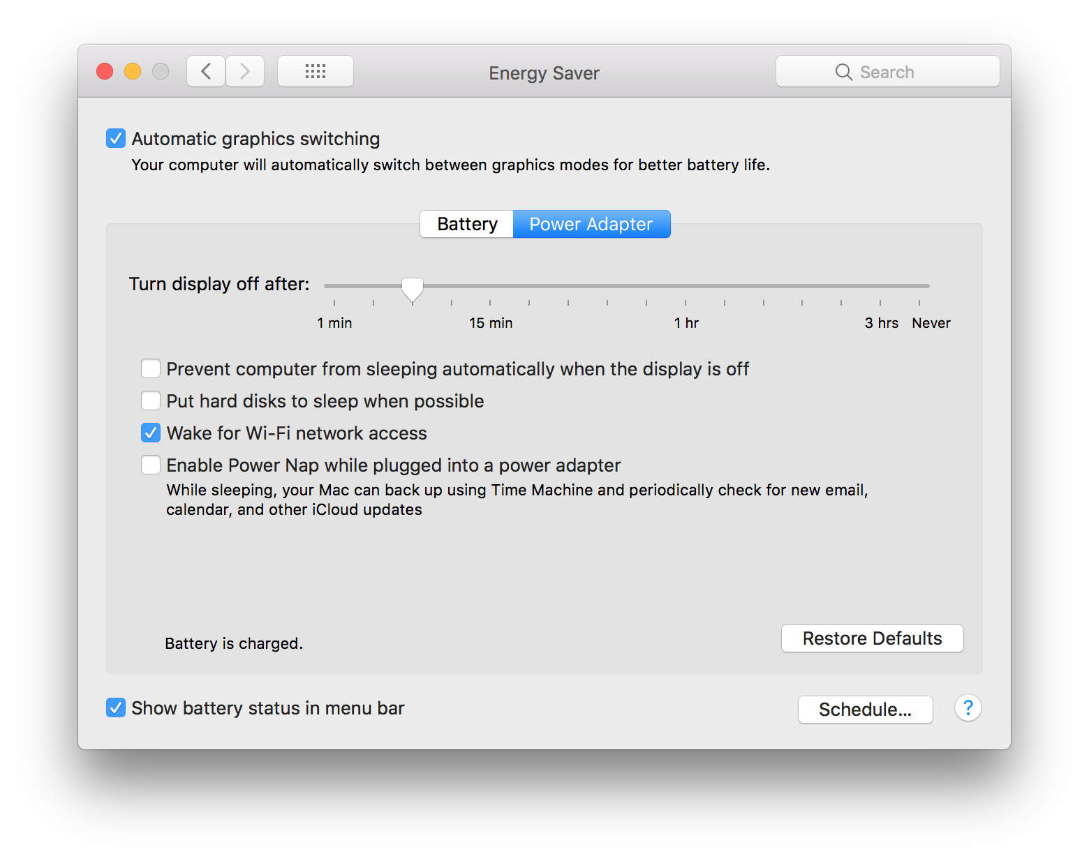

Thanks for the quick response. I have checked that setting and it is not enabled. I also answered you other questions below and uploaded some pictures and a report from EtreCheck Screen Shot 2018-04-12 at 1.04.25 PM.png Screen Shot 2018-04-12 at 1.04.19 PM.png Screen Shot 2018-04-12 at 12.59.54 PM.png
How long are you leaving the computer for when it goes to sleep? (Battery - Display off in 5 min, sleep when possible. Power - Display off in 5 Min)
- Does it always seem to happen, or only when it's been left for a certain amount of time? (Off and On. Minutes - Hours)
- Have you installed macOS 10.13.4? (You can check your macOS version in Apple » About this Mac) (YES ON 10.3.5 Beta, i thought this might fix the issue)
- Do you have FileVault enabled? (No, Should I?)
- If FileVault is enabled, do you see an orange/red checkmark next to your name when you come back?
Thanks for the quick response. I have checked that setting and it is not enabled. I also answered you other questions below and uploaded some pictures and a report from EtreCheckView attachment 758032 View attachment 758031 View attachment 758033
