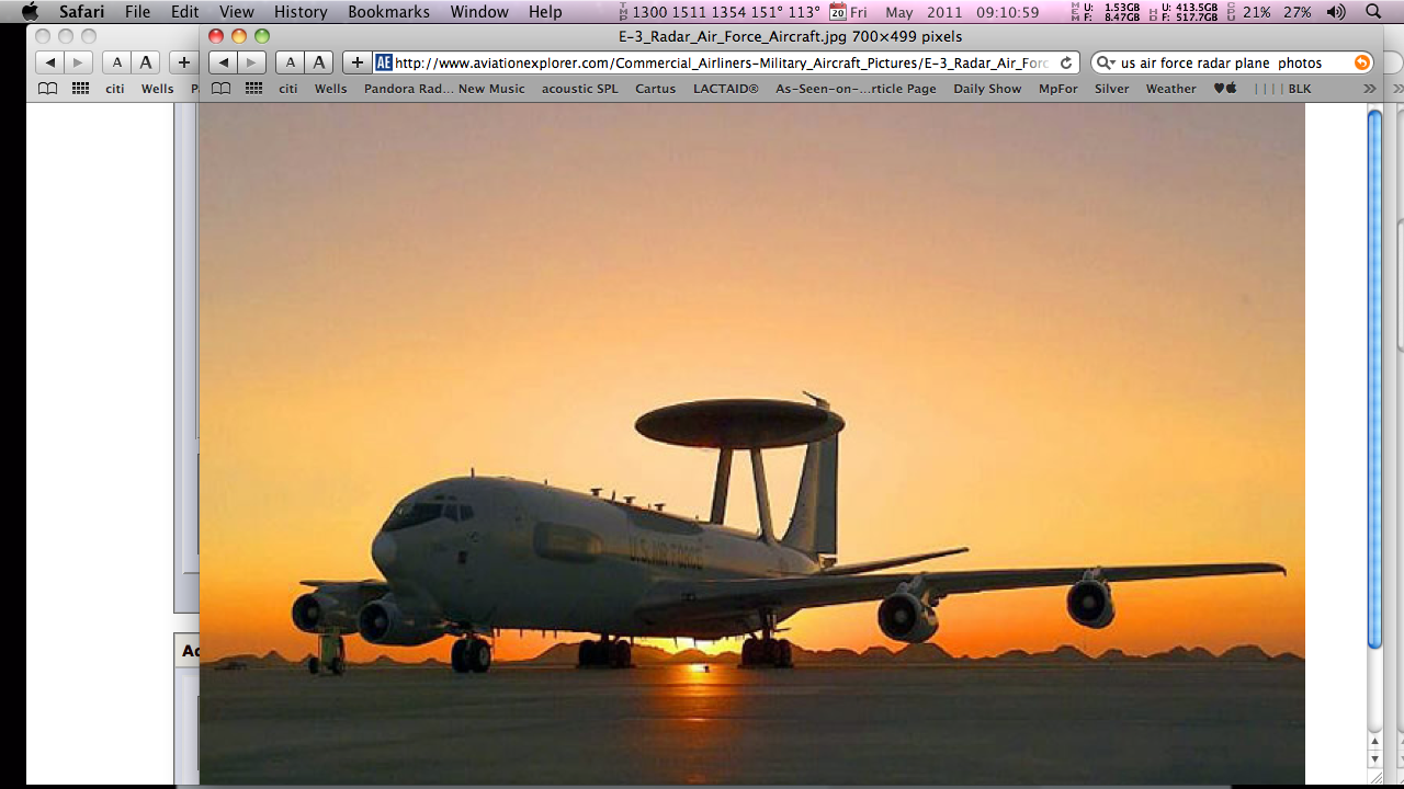

I can't use wireless in my home due to 5 military bases under 35 miles from my home. when that radar plane flies around my home you can just forget wireless! More then 20 flights a month.
