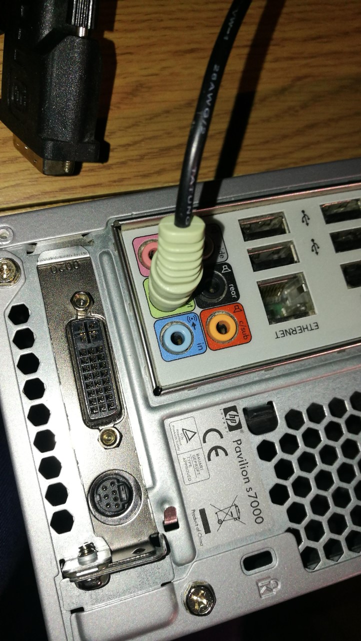

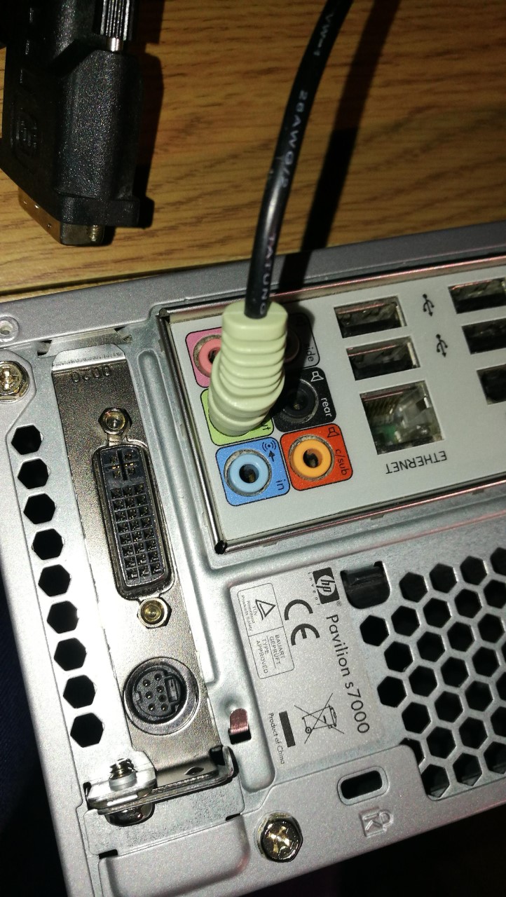

ok so i need to get a new graphics card for my PC 🙁 my HP Slimline S7720uk is over 10 years old but i've modded it to its full capacity with processor, bluray drive, memory, storage etc... the graphics card at the time was a major problem due to the power supply (also upgraded) and dimensions of PC.
Regarding the connections of my GPU from what i remember i had a choice of HDMI or DVI and i chose the latter due to the monitor not having HDMI as it was a matching PC setup (all the same brand) With that said it's still a good PC for what i use it for and don't intend to replace it (yet!) just for this issue.
If anyone has any recommendations of a low profile graphics card that is suitable for my hp slimline that would be most helpful 🙂 i will have a look and check it out too but someone on here might have some experience with low profile GPU's than i do 🙂
thanks in advance
i still had the box for my 9600gt card hopefully this can clarify things. Will i be able to use this card? if you read the specs it will say that it has dual link dvi and one hdmi :/ is this a typo because my card definitely does not have the hdmi connection. Could it be that this is referring to the full size card and not the low profile version?

There's at least two different versions of that 9600 GT Low Profile card. Yours has the HDTV video, and DVI. Another model has the same DVI, and HDMI instead of the HDTV connector. As far as I can tell, all models have dual-link DVI, so it SHOULD work with a dual-link DVI to mini DisplayPort adapter. Again, the adapter will need to be an active (bus or self-powered), and not a simple passive adapter.
Although it should work, you may find out that even with good adapters and cables, it just doesn't work. The connection to get the target display mode to work can be finicky, and finding someone who has actually tested that vid card, coming from a PC, and tried the target display to a Mac --- well, you have to find out for yourself by actual testing.
