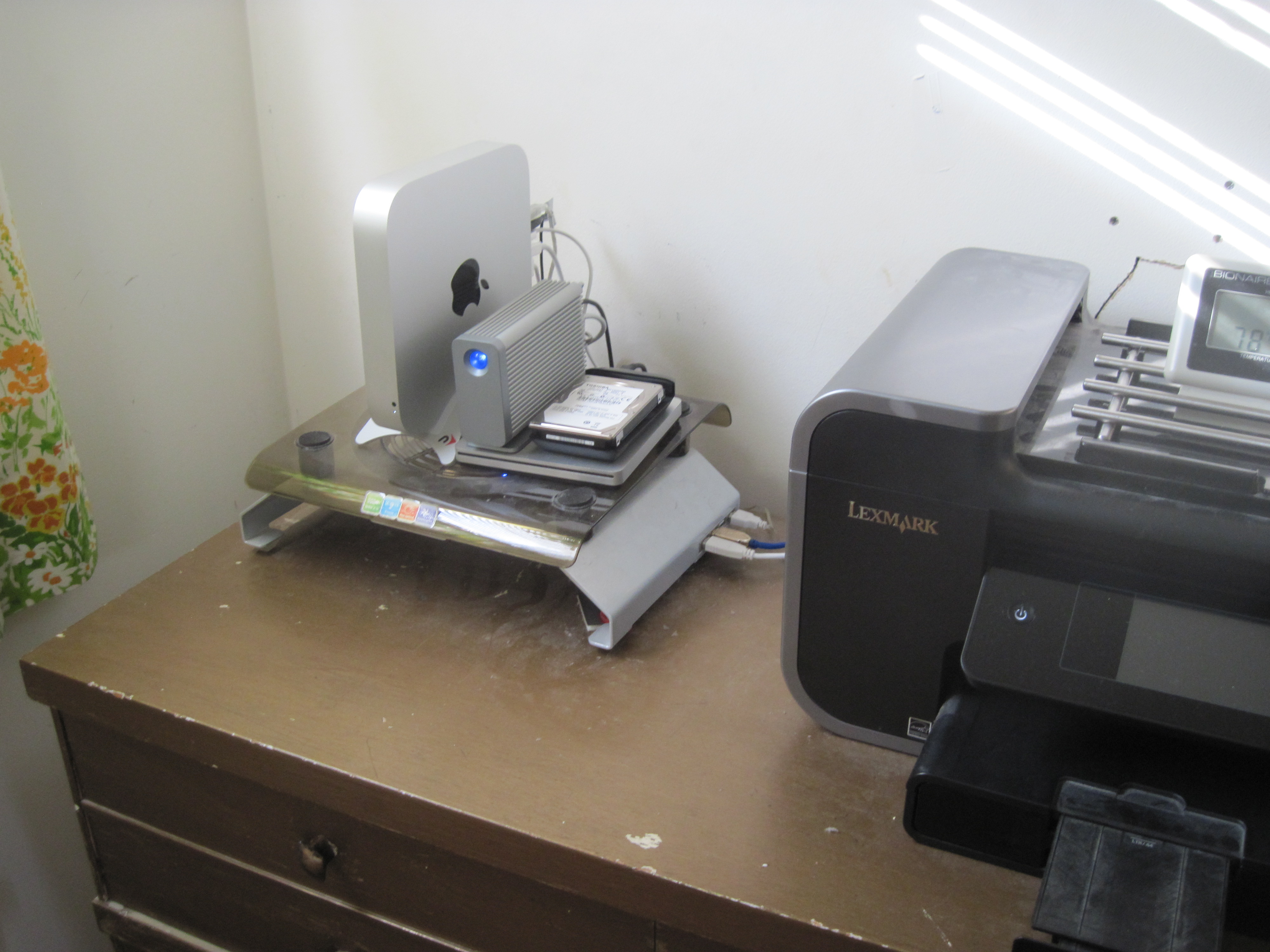

Just wondering: last night, I was capturing a bunch of streaming YouTube videos while watching a movie. So I had safari, jacksta (I think that's what it's called) and VLC Player going at the same time. I'd pause the movie every couple of minutes to search for and play video clips from YouTube. Anyway, I stood up to get a drink and felt the mini which was quite hot. The fans weren't blowing hard so I guess you could say that it wasn't that hot but I thought it was quite hot to the touch.
Does this seem normal that the mini should feel so hot to the touch when it's not doing anything really CPU intensive?
Is it a stupid idea to even think about using those laptop fans under my mini?
Thanks.

Both above have good points. Let your mini breath. cheap solutions are side mount stand
http://eshop.macsales.com/item/NewerTech/NUSTALYMINI/
on sale . use the free app GGJstudios gave you
if you run hot a lot you can buy the second app and set a more aggressive fan speed curve.
if not enough you can get the side mount i linked. i would think setting the fans floor at 2200 vs 1800 fixes most problems
the side mount is worth 2 to 4 c .
setting the fans floor at 2200 vs stock of 1800 is worth 2-4 c.
you can get a laptop blower see photo worth 2-4 c.
but try the free software to see your temps.
if you are at 75c or lower you have no fears.
the mini can push 100c without failing. I have run it for hours at 103c with hard testing that would be almost never done in real world.
I did kill a quad core machine but it was in oct 2012 and if may have been defective in the first place.
In fact after the machine died apple recalled the 10.8.2 2012 mac mini upgrade for about a month stating it was a bad update. We all have heard about the new mini having a hdmi issue which was fixed with a later newer 10.8.2 2012 mac mini upgrade along with 1.7 firmware. Since this newer software upgrade all my high temp testing was just a bit better on all the 2012 mac minis I tested. A few c lower in the case of the quad cores and in the case of the dual core machines I could not get them to reach 100c no matter what heat testing software used.

When I originally got my i7 Mini it consistently hit 96c using the AppleTV3 preset in handbrake.
It was on a desk with nothing on top or within 6 inches of it. Room temp was 24.4c.
I have the Apple 256GB SSD internal, but the encodes are to a USB3 RAID0.
I have since moved it to this stand I originally purchased for my C2D MacBook Pro.
http://www.raindesigninc.com/mstand.html
It was worth 4c and now I run at 92c with the ATV3 preset.
