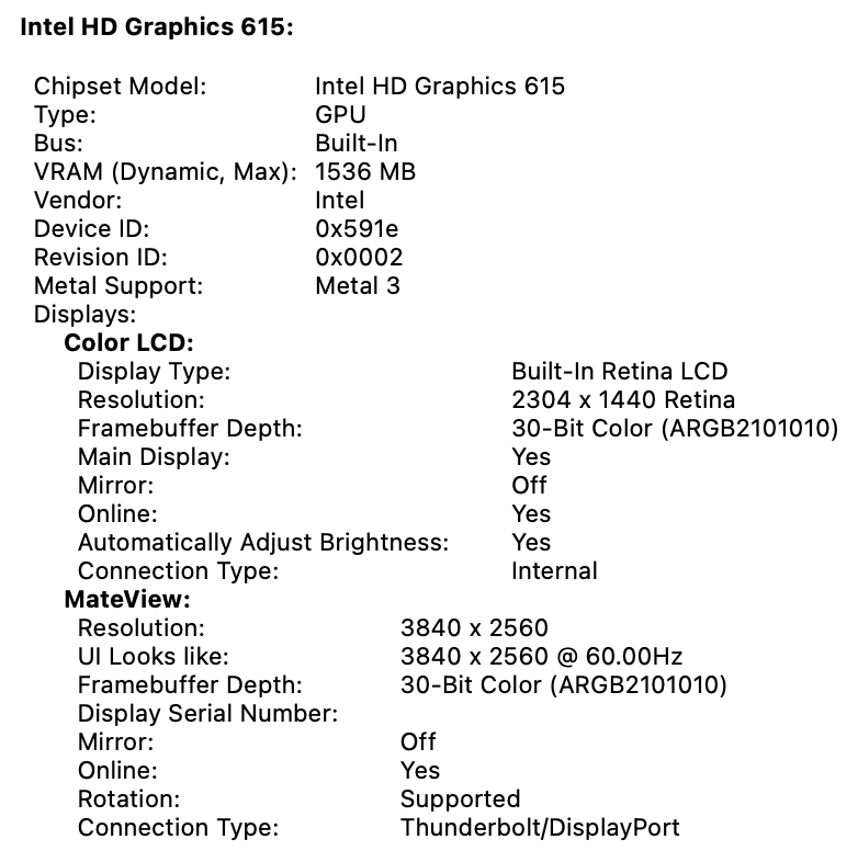

I just checked the specs for my lowly 2017 Core m3 12" MacBook, […]
That’s a Kaby Lake iGPU. If the MateView is indeed driven at 3840×2560 at 60 Hz, the iGPU’s pixel clock limit may be 675 MHz IIRC.

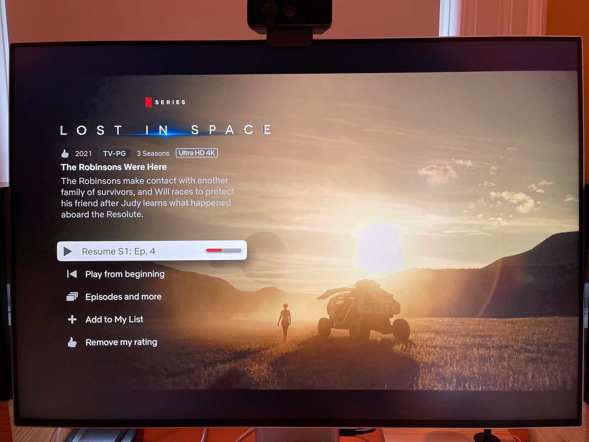

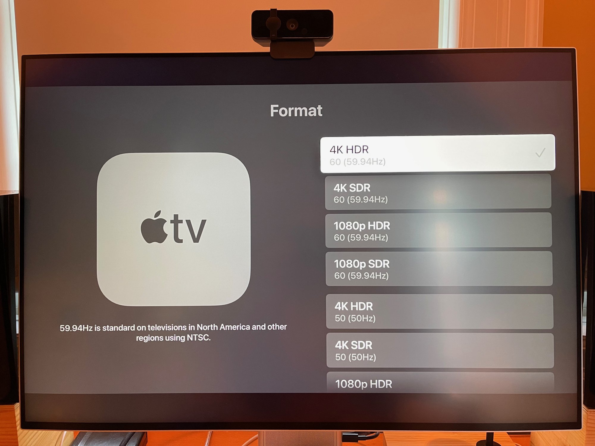

I plugged in my Apple TV 4K (1st gen) into the Huawei MateView 28.2" over HDMI. It connects at 4Kp60 HDR, fully supports 4:2:2 chroma, and streams 4K just fine in Netflix, so HDCP 2.2 is fully supported.
And it looks glorious!
Note the "Ultra HD 4K" logo here from the Apple TV 4K. From my Ventura M1 Mac mini, that logo is missing (both via HDMI and USB-C).
IOW, the inability of the M1 Mac mini to stream DRM'd 4K to the MateView is a compatibility issue, or else macOS / Safari limitation.

BTW, I couldn't test 4:4:4 chroma, because I don't think Apple TV 4K has that option.
Hmm... I couldn't get Disney+ to work at all over HDMI when connected to the M1 Mac mini. It just wouldn't play.
So for M1 + MateView 28, Disney+ in Safari works at HD but not 4K over USB-C, but it doesn't work at all over HDMI.
For Disney+ streaming on the MateView 28
HDMI + Apple TV 4K = 4K
HDMI + M1 Mac mini = No worky
USB-C + M1 Mac mini = HD
Perhaps the MateView 28 only provides HDCP 2.2 over HDMI, but the M1 Mac mini does not in this configuration. Over USB-C, perhaps the MateView 28 + M1 Mac mini only provides HDCP 1.4. If both of these statements are true, then that would explain the above results.
