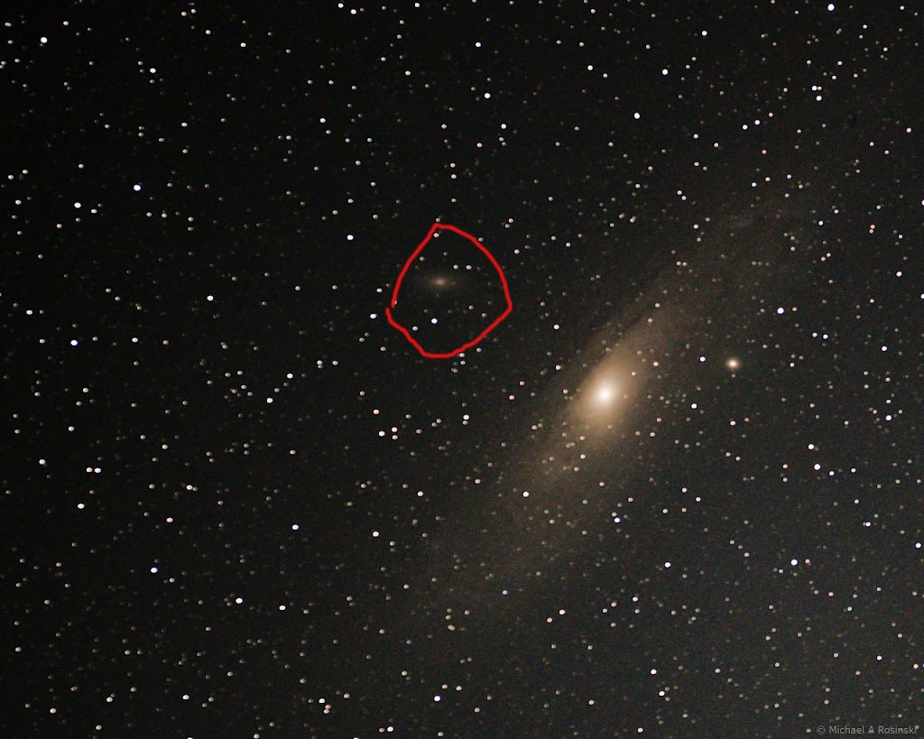

Hey! Sorry for swiping your photo, but is this another galaxy in the background?
Messier 110?
Correct, I see M32 and also M110.
Here's a much better shot of them via wiki:

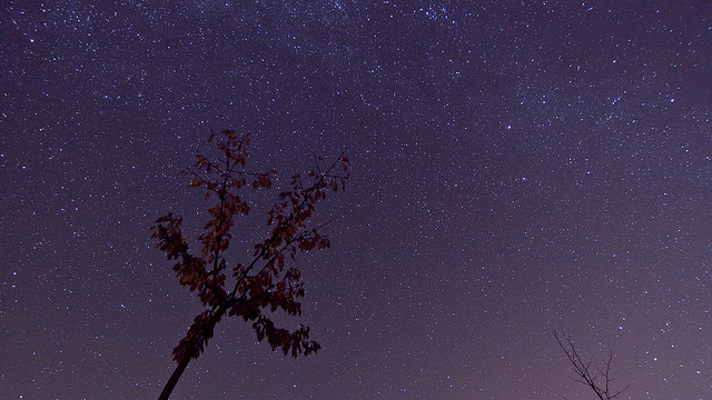

on a trip out to the mountains the other weekend I tried my hand at astrophotography for the first time along with some light painting. I am pretty pleased with the way they came out. Would love your C & C on this.
_DSC0193.jpg by dspector32, on Flickr

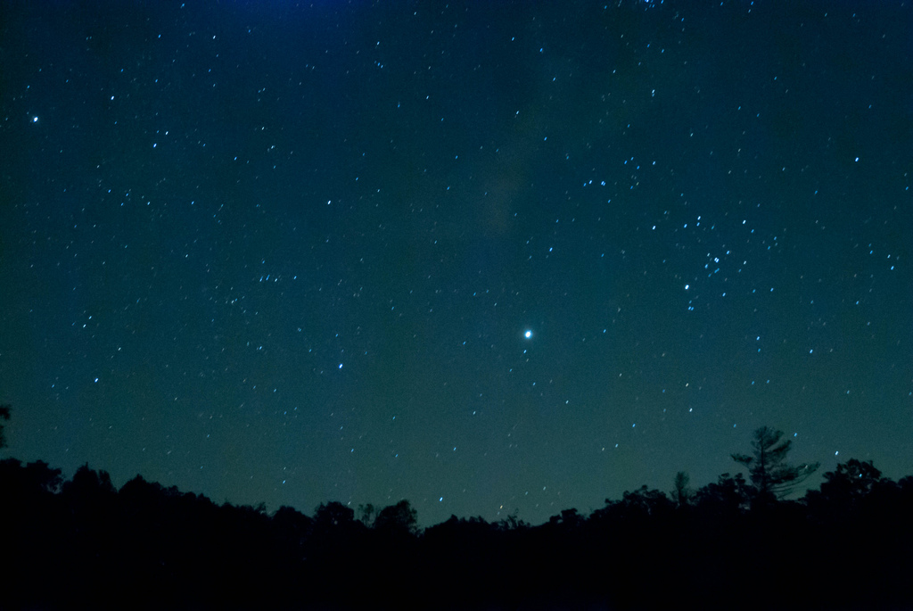

fireman32-kudos for trying this, IMO I'd go for 2/3 sky and 1/3 foreground, the sky sorta gets lost in the surrounding here.

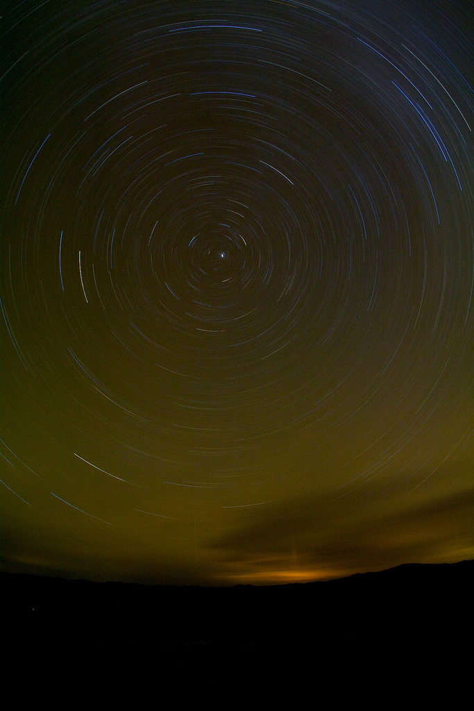

But what really mystified me was that glow in NNE. It was a pitch black night, with absolutely no glow at at all. But the sensor seems to have picked up the lights of Susanville, CA - over 100 miles as the crow flies in that exact direction. Amazing. So one other note to self - find somewhere with no significant lights within a couple hundred miles of the direction in which one is shooting!
Canon 40D, EF15mm 'fisheye', ISO 100, f/8, 90 minutes. White balance "daylight". In-camera long exposure noise reduction, Aperture 3.4.
