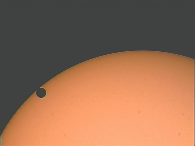

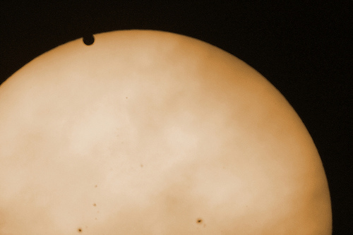

I got close on the teardrop
Close........
I took this with my Mallincam HyperPlus Color. The telescope was a Meade LX200 Classic 10" @f4, using Baader Solar Film, in an offset 3" mask.
Andy

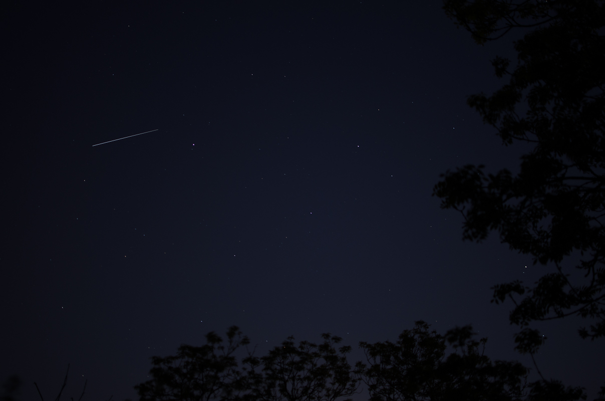

As bonus in the 400+ images taken, there is a iridium satellite flare 1/2 way up and 1/3 way in from LH side, this individual 2 frame composite & crop shows it clearly.
There is a 1 second pause between frames, as can be seen in the image, those flares last very briefly, usually just 3-5 seconds total to the naked eye, camera sensor will show longer.
I've seen just 1 -7mag flare and it was so bright and stunning!
Heavens-above has info to plan and capture them for those interested.

I keep accidentally getting shots of these flares in my time lapse sequences. Here's one from my trip to the UK, taken May 28th. They are really cool to see in person, and I've seen them almost every night that I've done a time lapse. I've also seen a pair of satellites flying overhead a couple times. They look like they're an inch or so (relatively speaking) apart on the same path... anyone know what those two guys are, flying together like that?
