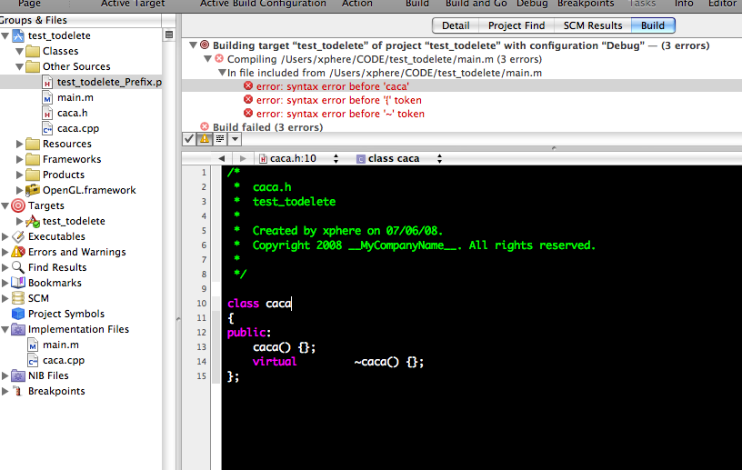

I'm developing a tool with Objective-C/Cocoa, that should use C++ code.
Basically the front end it is in objC, but the core is in C++... the problem is that seems that the code cannot be mixed, at least as I expected... each time I call a CPP '.h' file, it crashes...
I've tried to add Carbon framework without success... I've prepared a small project to illustrate the problem 🙂
Thanks in advance!!

Yup, you need to change main.m to main.mm because it includes the cpp class definition of class caca.You can keep the .cpp extension for caca.cpp though.

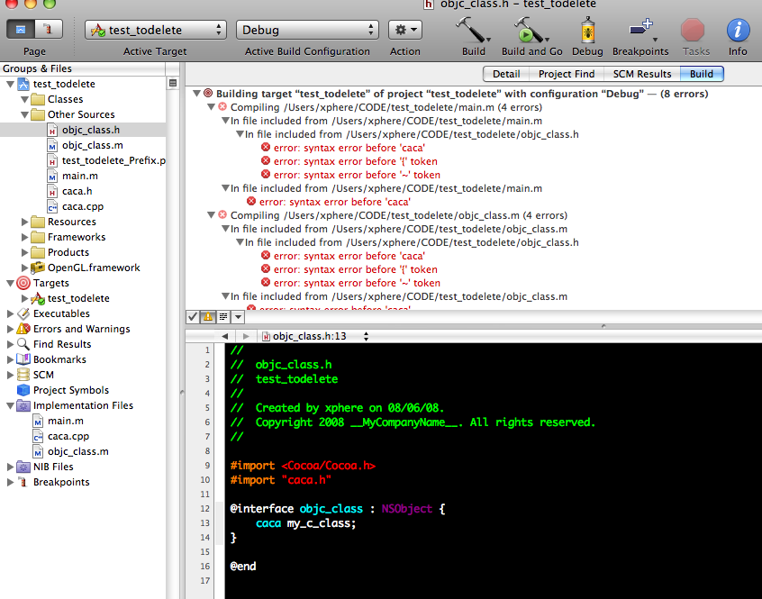

Hi all! thanks for your answers, they were really helpful, but the problem now comes when I try to include a CPP header from an ObjC header.
The CPP core files can be all included with one single header file. So I just need to call this .h (CPP format) from another .h file (in ObjC format).
I've attached a screenshot and the project to illustrate the problem...
In this example you will see that my ObjectiveC class (called 'objc_class') is trying to include a C++ class (called 'caca'), because it should use it (with the variable 'my_c_class').
Any tricks?

Same problem again, any file that includes obj_class.h will have to have a .mm extension. The simplest solution is to give all your source files a .mm extension. Either that or change the preferences to push all .m files through the Objective-C++ compiler.

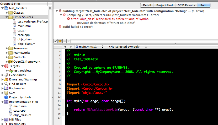

I've tried changing main.m to main.mm, and add an import to my objectivec_class but i get a strange error (see screenshot).
And... if one ObjC header (.h) is calling a C++ header, how can I make that a header is treated with the ObjectiveC++ compiler?
I've tried changing all .m files to .mm ('main.mm' and 'objc_class.mm'), and also changing the 'filetype' in file properties, without any success... 🙁

Couple of things wrong here:-
First you're trying to define a class called objc_class which is already defined by the system as a struct, (spotlight objc_class and you'll see objc.h).
Second, you're defining an instance variable:-
Code:
@interface objc_class : NSObject
	caca my_c_class;
This doesn't work because caca has a virtual destructor. If you make the destructor real then it should be okay. Have a look at page 99 of the Objective-C reference.
b e n
Oh, and rename objc_class.m to objc_class.mm (but you want it something different from objc_class anyway).

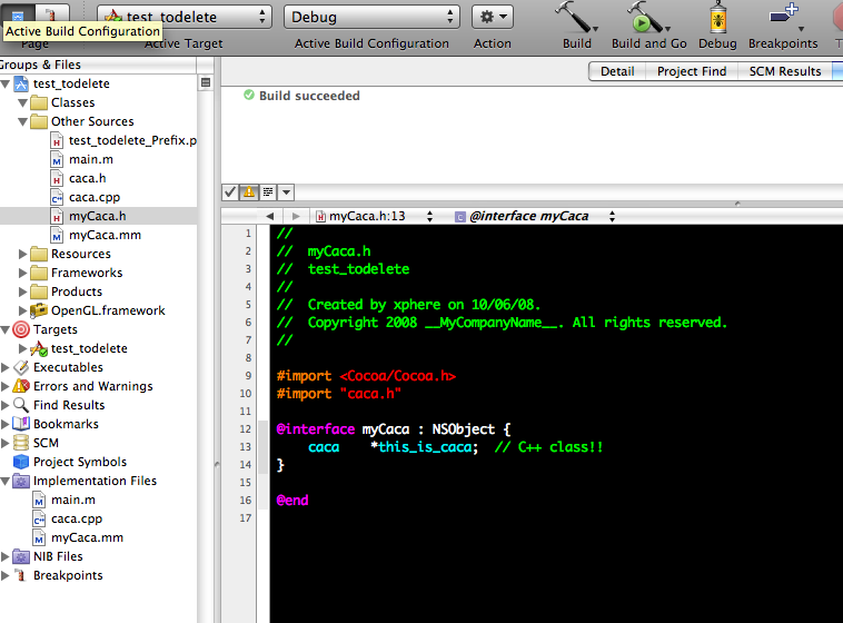

Thank you so much guys!!!
The major issue that I had was what lazydog said: objc_class was an already defined class!!
Now everything is running like a charm!! thank you so much to everyone!!!
