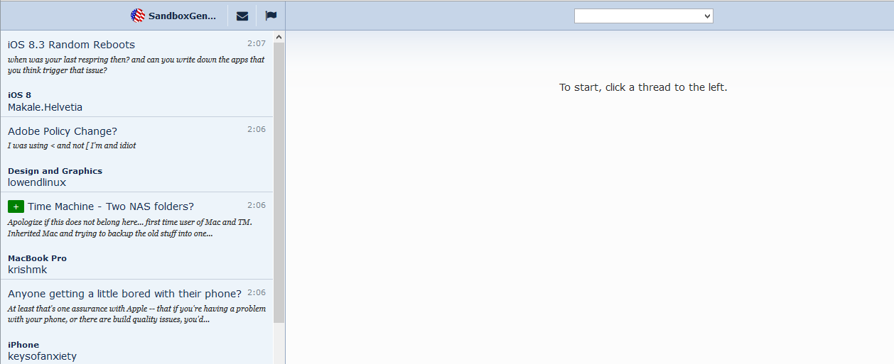

… split screen Spy on one side and thread opens on the right …

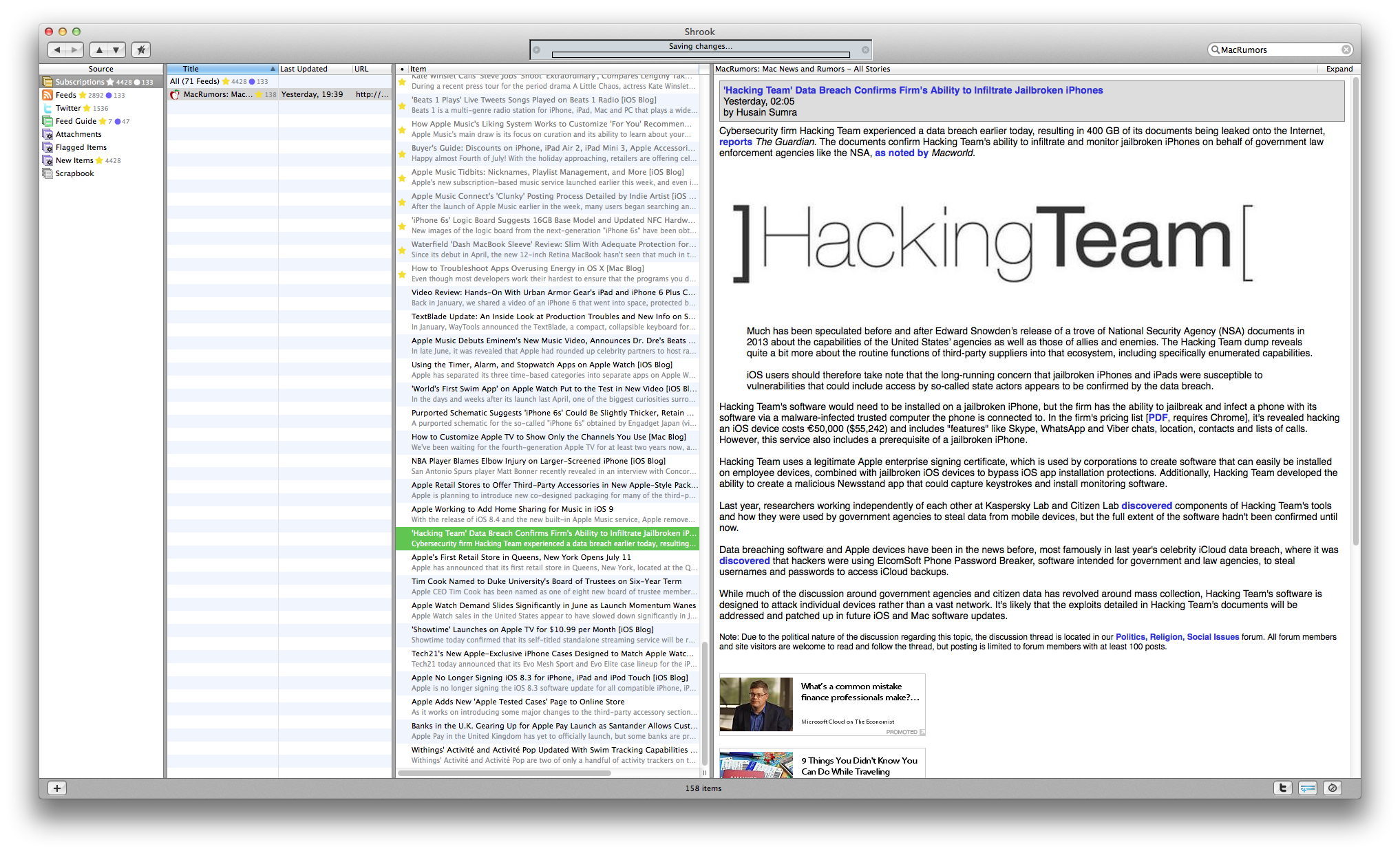

When I first read that, I thought of Shrook 🙂

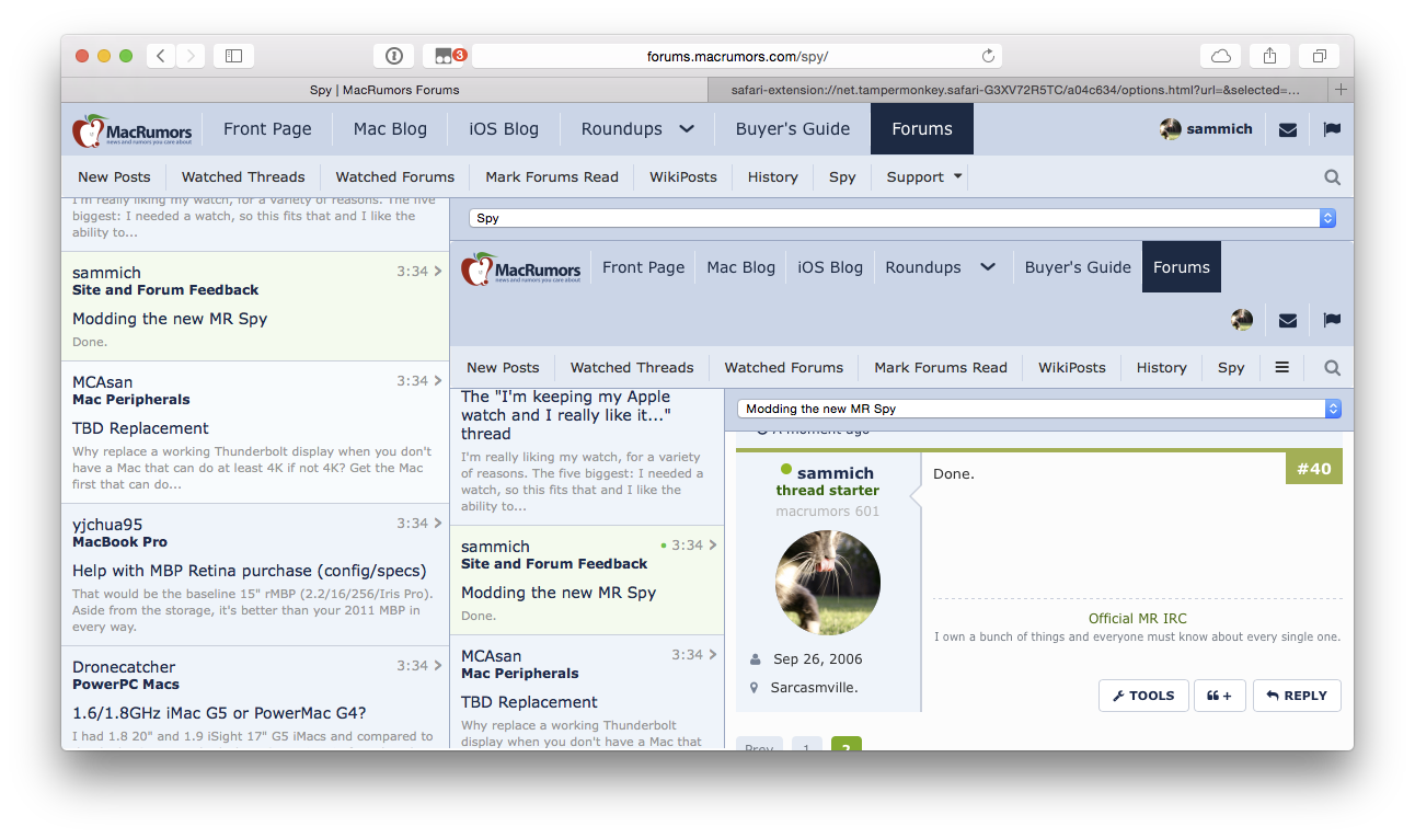

Is there a way to keep the main header of the forum visible, and useable with this?
I'm on Firefox with Windows 8.1 right now and I use the links in the main header a lot.
Instead this is all I see.
BTW, great work on this, it's really cool.
Reactions: grahamperrin

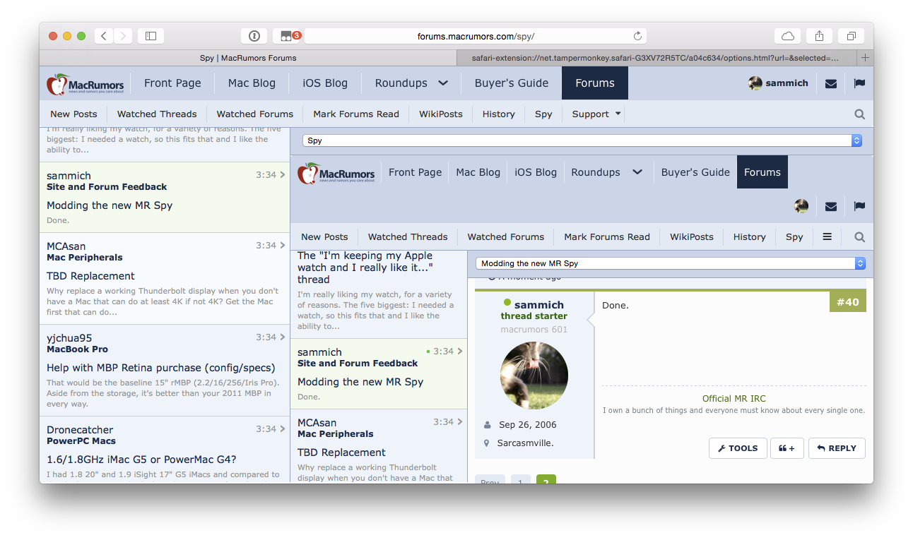

Done.
If the screenshot looks confusing, let me explain: the header links are opening in the 'detail view' as well. I opened Spy from the header and it opens a Spy in a Spy. Simple.
Done.

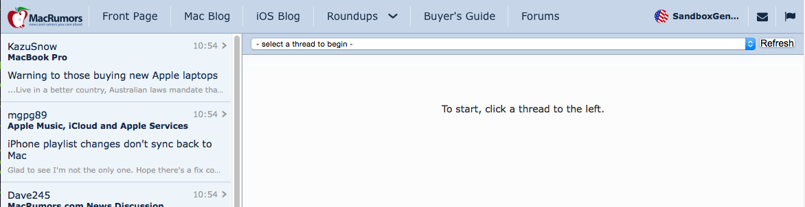

New split view: https://github.com/sammich/macrumors-spy-mod/raw/master/split.user.js (clicking on the link will ask for the update/install to occur).
There's a new version with some experimental changes as well as some hopefully useful ones:
  • removed the secondary navbar. You can bring it up by hovering over the main navbar for a moment
  • added a refresh button to the right
  • opening a link will modify your location bar so you can grab the url if you want to from there
  • pressing back in your browser will actually go back in your spy browsing history (although it's a little buggy)
  • turned off snippet line wrapping

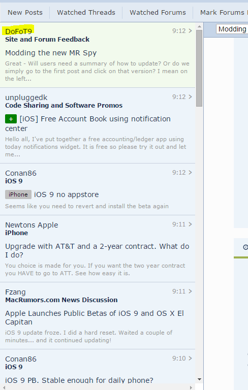

Great - Will users need a summary of how to update? Or do we simply go to the first post and click on that version?
  1. Your replies are green...the little green dot is for a post you've opened
I mean on the left hand bar, if I reply to a post I can see my username and whatnot, but no indication that it's me (apart from my username). Picture to follow.
Edit: Please see picture: There is not much of an indicator that I replied.

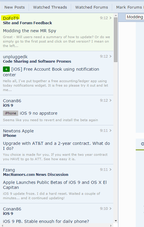

I just updated to this version and lost the bottom half of the main forum menu bar. (right now I'm on Safari with Yosemite)
Also, I noticed yesterday (on Firefox for Windows 8.1), that new alerts wouldn't show up in the little flag and I had to get out of the custom Spy screen to a normal MR page to get to the alerts.
He only develops for Chrome and doesn't care about us Safari/FireFox users 😛
It's in my release notes post - I've hidden it by default and you can show it again by hovering over the main navbar.
