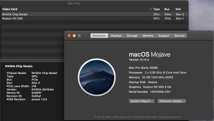

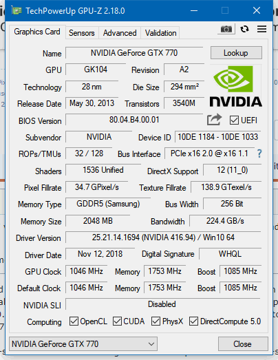

So I found something interesting-and fun, metal acceleration on both a GTX770 and RX580 and hardware acceleration as well as I know to test it in both Mojave 10.14.3 and Win10-just no display in Mojave via the RX580.

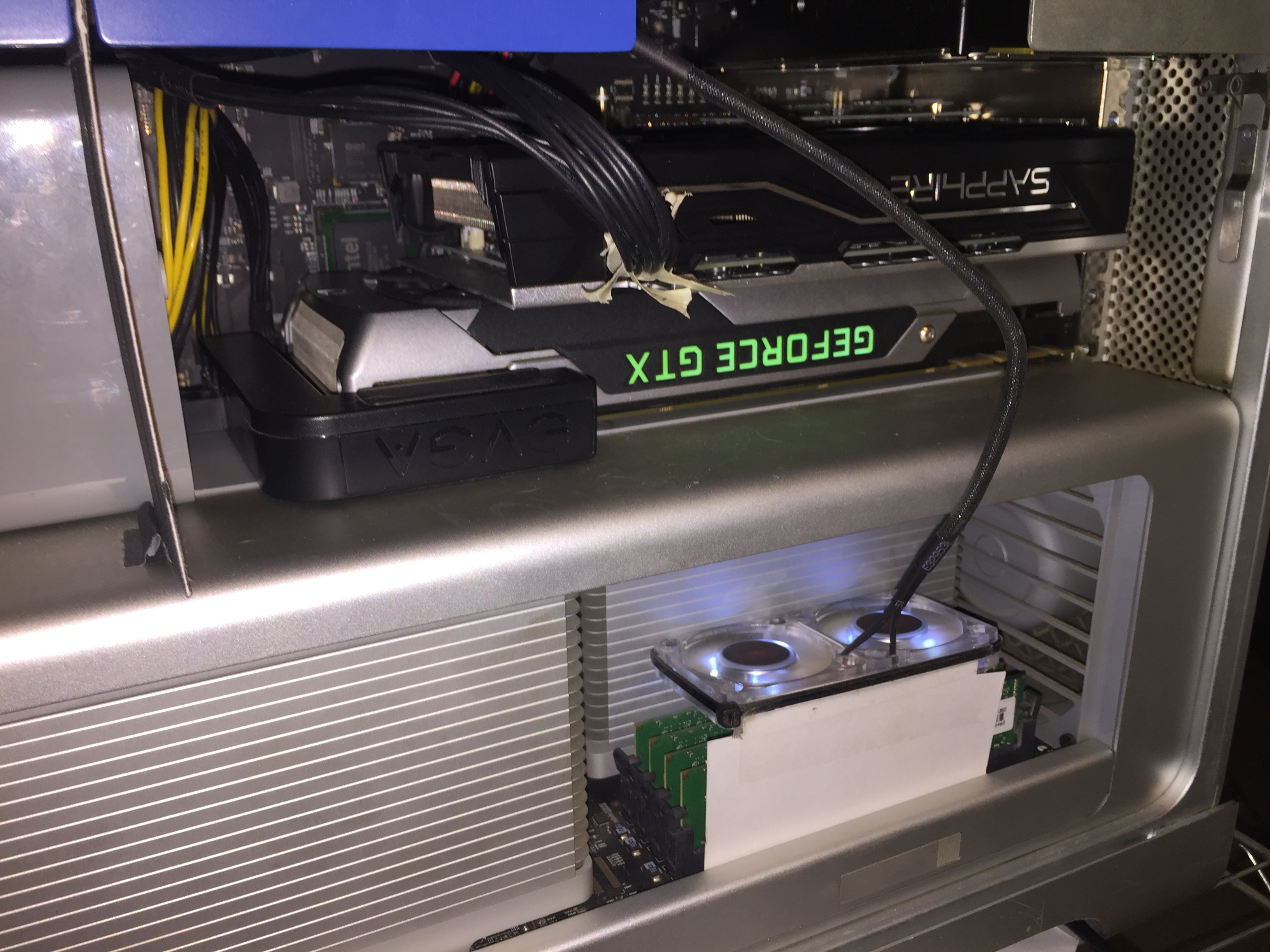

My NVIDIA GPU is a MVC flashed GTX 770 Founders Edition 2GB-and reports correctly as a 770 since I purchased in 2016 from eBay. Doubtful a MVC original-but the bios is locked reports as such; I got it from an east coast seller. Possible it was just re-sold to me though.
I've been told the Quadro 4000 hangs on boot if attempting to boot Mojave with a Polaris:
...if I select to boot into Mojave, it gets stuck at the progress bar, most the time around half full or 3/4 full. Mojave will boot even with just the Quadro 4000 in, but there are graphic glitches.

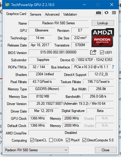

My AMD GPU is a Sapphire Pulse RX580 8GB standard dual bios OOTB, using the primary bios. I was very happy with this setup's overall perfomance in both macOS and Window but sorely missed Bootscreen and PhysX in Windows.

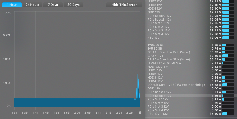

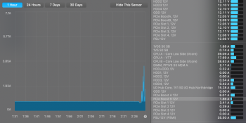

Use caution-you can still trigger shutdowns if only using the PCIe boosters (i.e., DO NOT attempt from the Aux Boosters ALONE as any rendering will likely trigger a shutdown). Have a plan to provide power before even considering dual GPU's of any configuration long-term.

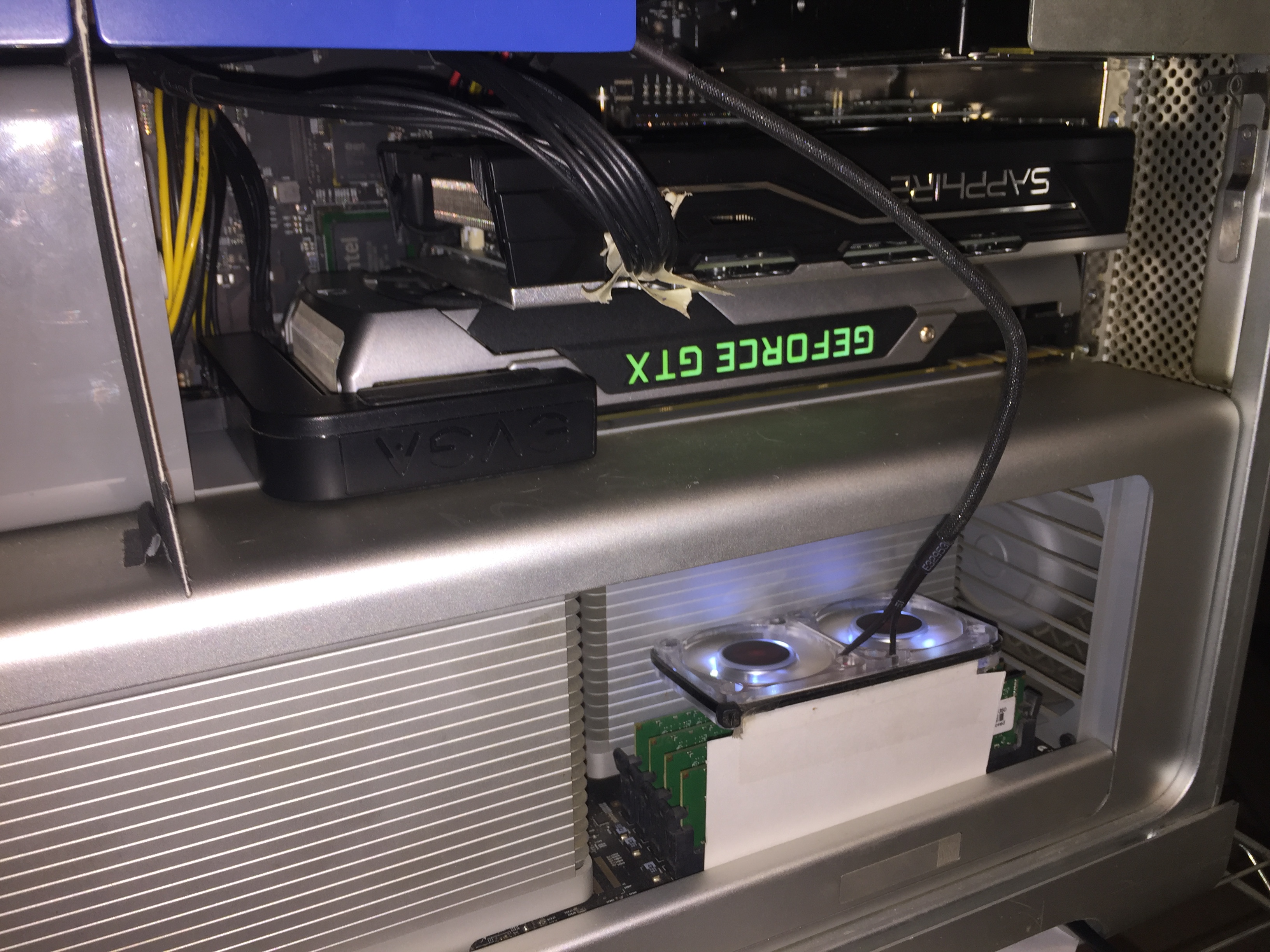

After getting both a cards running self regulated with the GTX additional power via the Aux Boosters and a Powerlink, and the RX580 via a Pixlas mod. I had planned running the GTX 770 from the Pixlas mod, but found shutdowns were still triggered even under Bootcamp boot unless power limted in Afterburner in kernal mode. Returning the GTX 770 to the PCIe Aux Boosters and Powerlink, and routing direct power to the RX 580 from the PSU solder points fixed the need to limit the power and allows full rendering in both OS's. In my personal opinion-a single lane solution such the Quadro 4000 for Mac (Fermi but I am unsure of Metal capability) or flashed single lane Kepler would be far closer to the spec power envelope for a standard workstation application but this is what I have tested and worked in limited function.
The RX580 in slot 1 was my first attempt, which worked-but with the same limitations I have currently, but the RX580 would run hotter due to Chill engaging (but not getting hot enough to trigger the fans). The 580 in slot 1 idles at 42 deg C, but in slot 2 it will idle at 38 deg C (prob cause the GTX FE's fan is circulating right next to the RX580's heatsink). Also, the GTX required a stand-off when in slot 2 to prevent the RX's fan's from clipping the solder-point's on my GTX which does not have a backplate.
A secondary case and PSU could be warranted-but even without display in macOS, the RX580 is providing accelerated compute that is visible by both app and monitor which are the main reason most of us use them and is why I absolutely consider this a success.

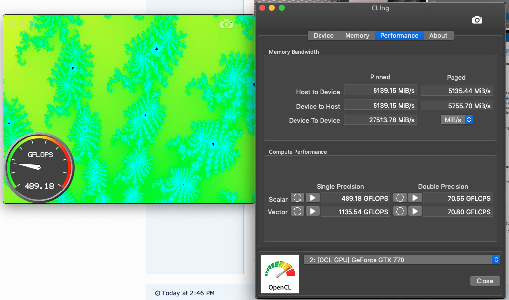

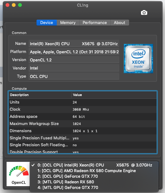

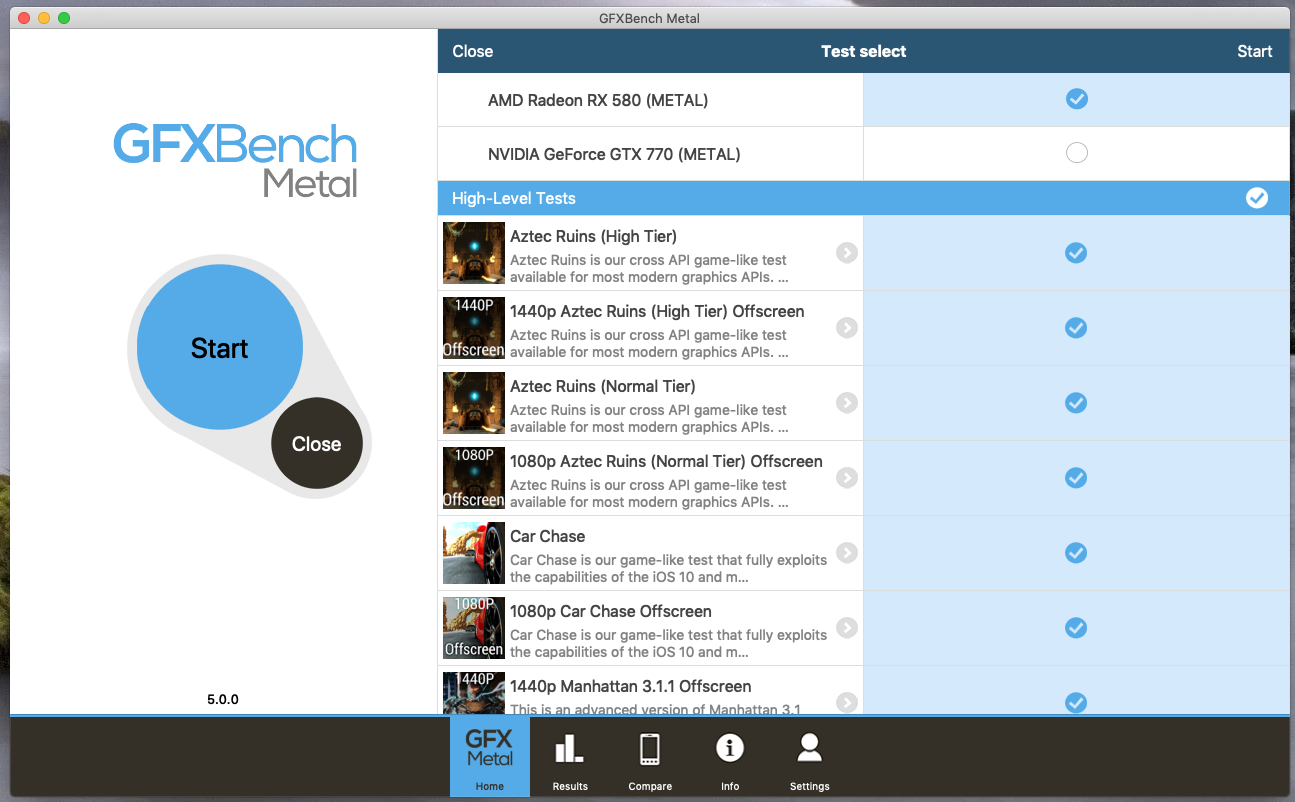

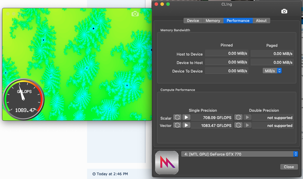

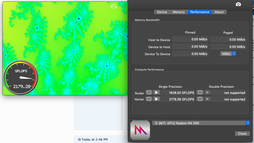

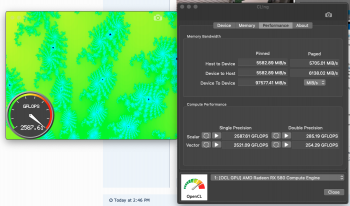

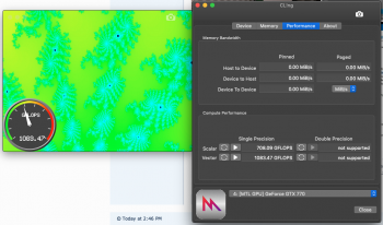

6) CLing is reporting Metal acceleration in both GPU's
7) FCPX does not appear to use the RX580, but Compressor does as a booster GPU.
8) Heaven/Valley uses only the GTX770, but recognizes the RX580's presence (or I have just not been successful in engaging the RX580 yet).

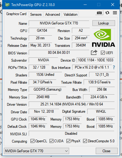

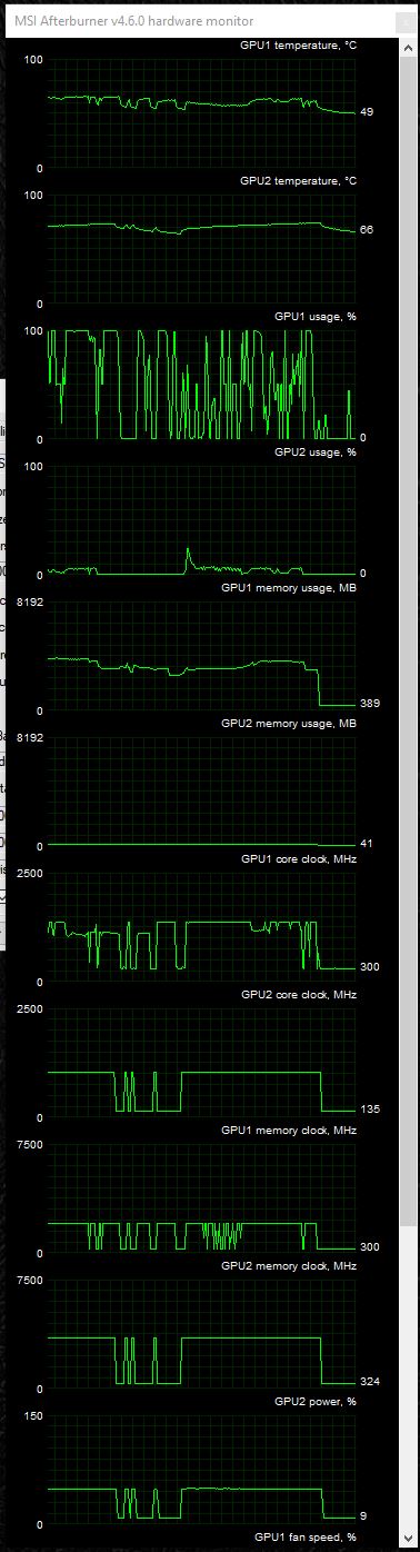

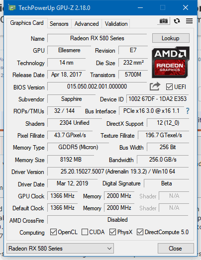

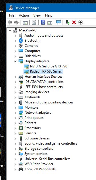

In Win10:
10) Best to use the RX580 as primary-both cards are usable.
10) GTX770 functions perfectly as a dedicated PhysX/CUDA card when using RX580's DP.
12) Certain settings on each AMD/NVIDIA control panel are only accessible when a monitor is connected to each manufacturer's card, so PhysX must be set to the GTX in the NVIDIA Control Panel prior to swapping to RX580 for use in Windows. It only needs to be done once usually, unless you move the cards slot location.
13) Ensure your cards are properly powered by getting a second PSU or provide power in an adequate manor.
I have a mDP switch that I've re-purposed (previously was buggy at times when using w/ my MBP, so I don't recommend it by name brand), that's working well for now between GPU's. When setting up I was just swapping the DP cable by hand once booted to Windows between the GTX/RX where hot-swaps aren't a problem. They aren't a problem in macOS, but again-you just don't have a display via the RX580 in Mojave.
I am planning a Pixlas mod to eventually power the RX580, or secondary PSU for both (undecided)-but wanted to share this setups viability for those that already have those bases covered. I personally favor a secondary PSU for longer-term use, but this is certainly viable for my use in Testing.

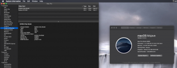

Screenshot 2019-03-15 21.22.25.png Screenshot 2019-03-15 21.22.03.png Screenshot 2019-03-15 21.20.57.png Screenshot 2019-03-15 21.20.34.png Screenshot 2019-03-15 14.32.07.png Screenshot 2019-03-15 09.11.59.png Dual GPU PhysX in-action Capture Win10 .JPG Dual GPU Capture Win10.JPG IMG_6640.JPG
Is there a reason you want/need to run both GPUs simultaneously? Between the two cards, the RX580 8GB will have much better macOS performance in Mojave, assuming your GTX 770 FE 2GB is GK104 (basically same as GTX 680 Mac Edition 2GB).
You can try swapping PCIe slots to see if it impacts macOS priority. Used to act this way with mixed GPUs, unsure if it still does.

Bootscreen access and the added benefit of CUDA and PhysX in Windows, basically. In windows the 770 doesn't even hit the 120w power limiter, so I'm thinking the boosters and my Powerlink should be fine for testing since it hardly ever hit peak in macOS. I would rather use the RX580 in macOS, but I haven't achieved display yet. But even with only using the 770 in macOS there are considerable perfomance pickups-just like if I had web-drivers engaged.; it's fast.
Thinking a secondary display should set it up perfectly, for my application-since it should engage both. I just may not have dual monitors in Mojave-which I'm ok with. Biggest drawback so far is I had to pull my USB-C card to gain full access for the second GPU. I'm exploring transplanting options-some of which we've discussed previously.

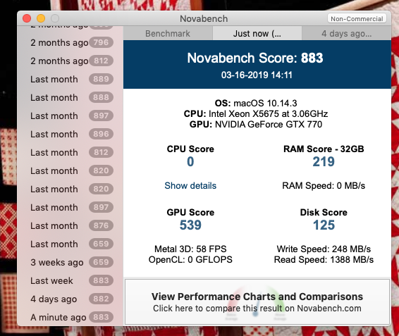

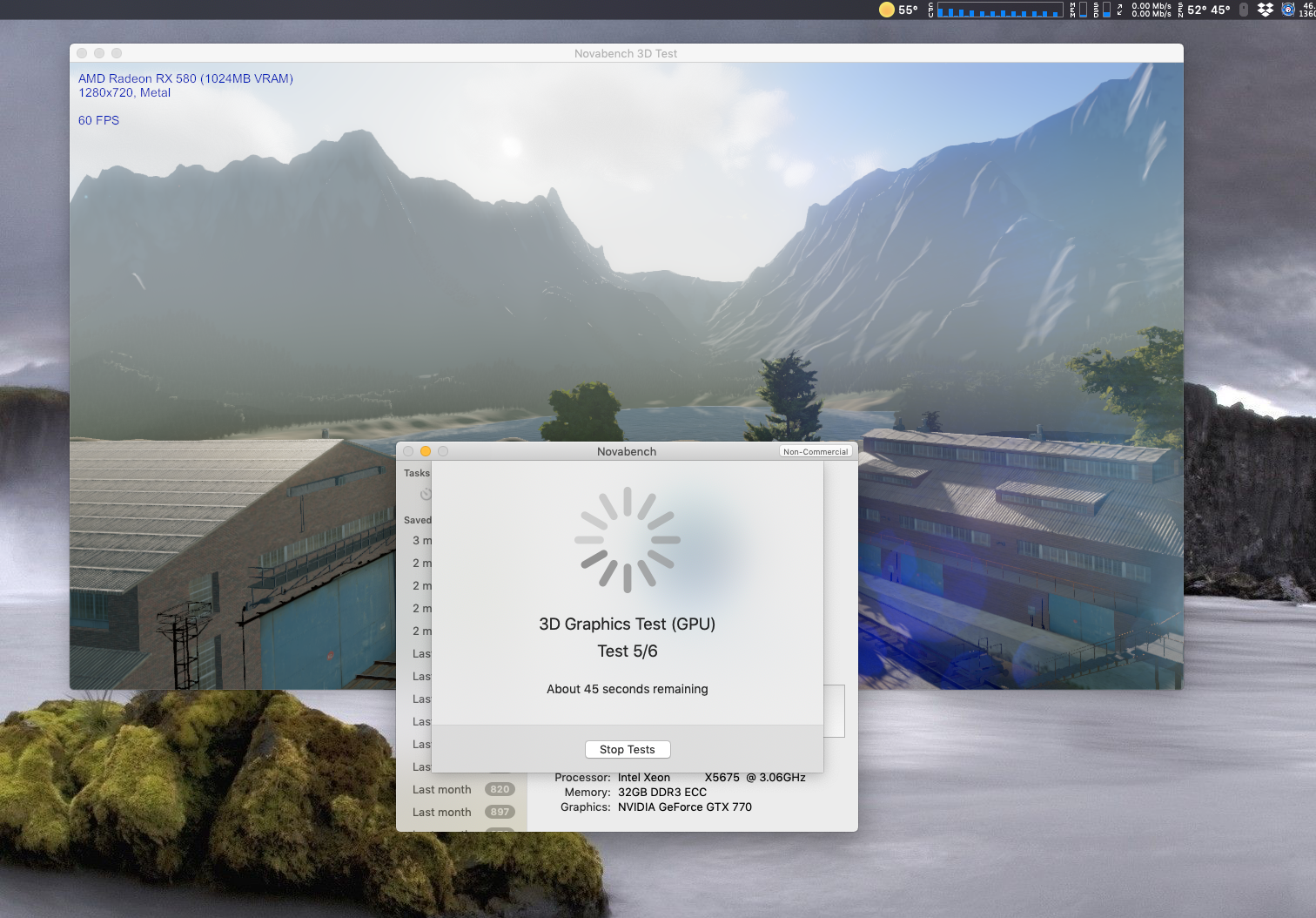

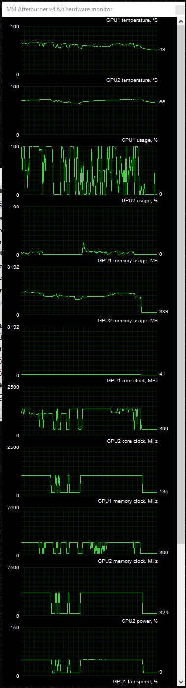

Screenshot 2019-03-17 11.58.43.pngScreenshot 2019-03-17 11.58.57.png Screenshot 2019-03-16 14.12.47.png Screenshot 2019-03-16 14.11.38.png

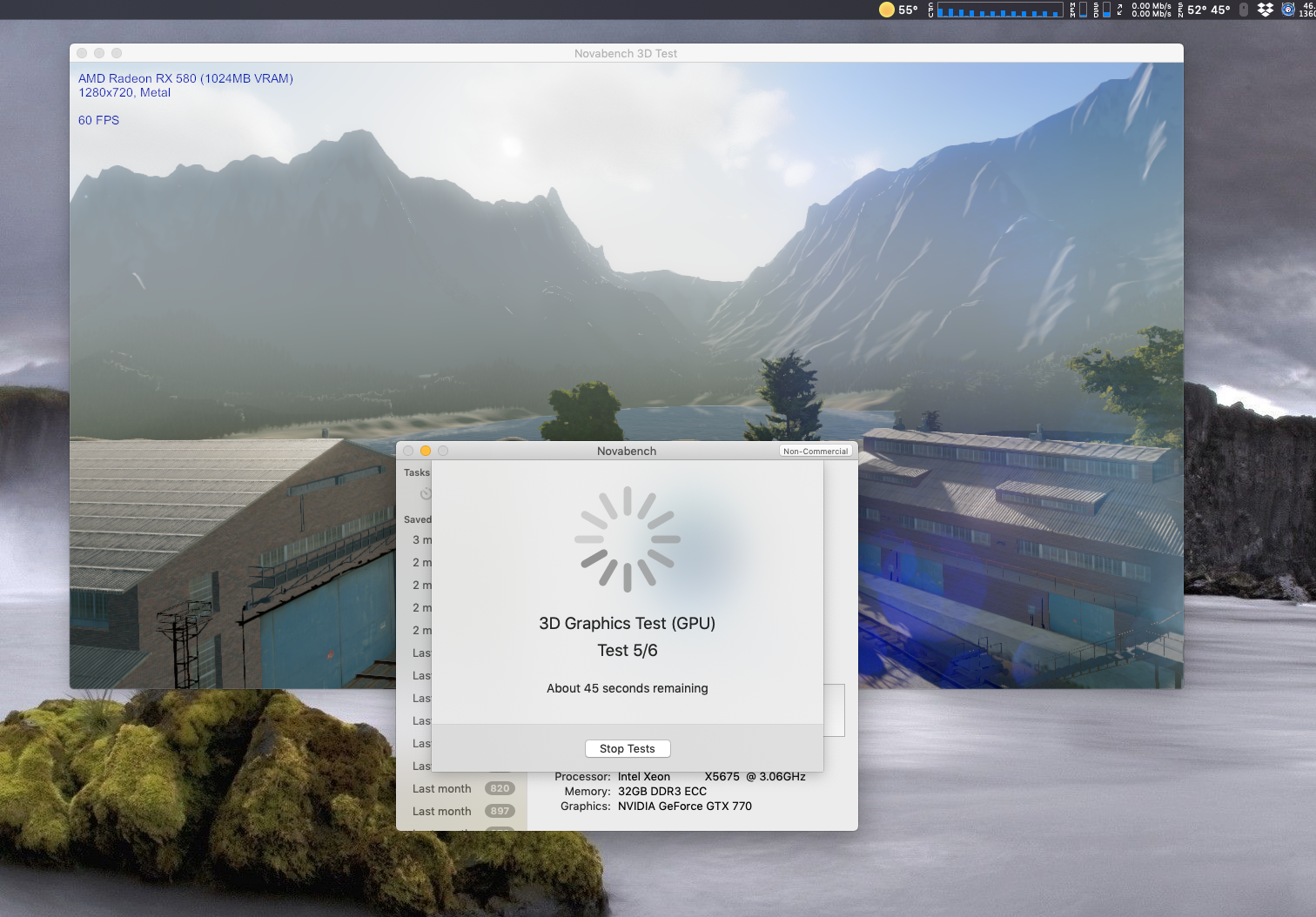

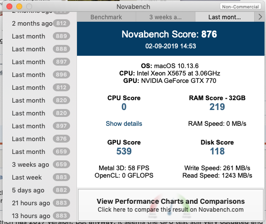

First two are previous shots, one in HS, and the other after upgrading to Mojave.
The second two are new shot's are in Mojave showing rendering on the RX580 while installed alongside the flashed GTX770-but it's only reporting as 1GB (likely a Novabench reporting error, macOS recognizes the full 8GB in System Information).
View attachment 826691 View attachment 826692
New shot's showing rendering on the RX580 while installed alongside the flashed GTX770-but it's only reporting as 1GB (likely a Novabench reporting error, macOS recognizes the full 8GB in System Information).

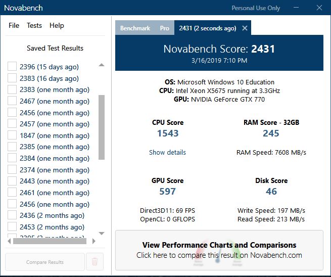

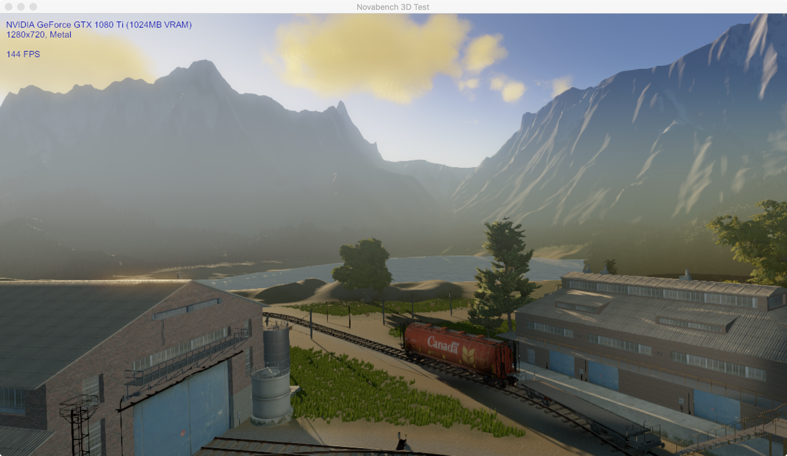

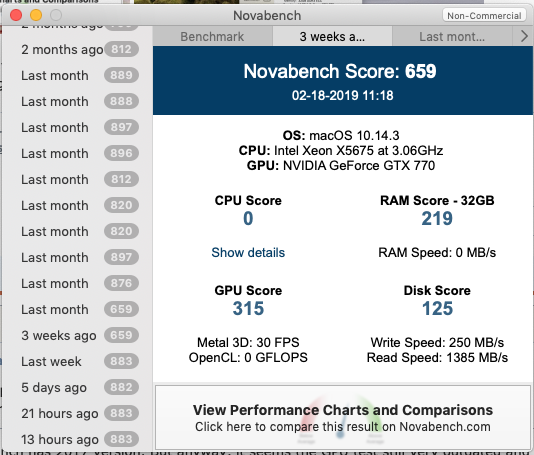

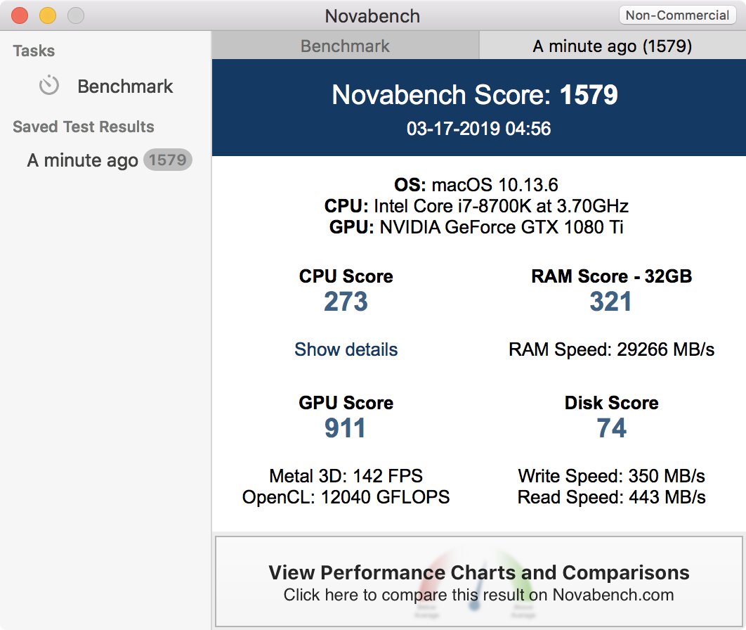

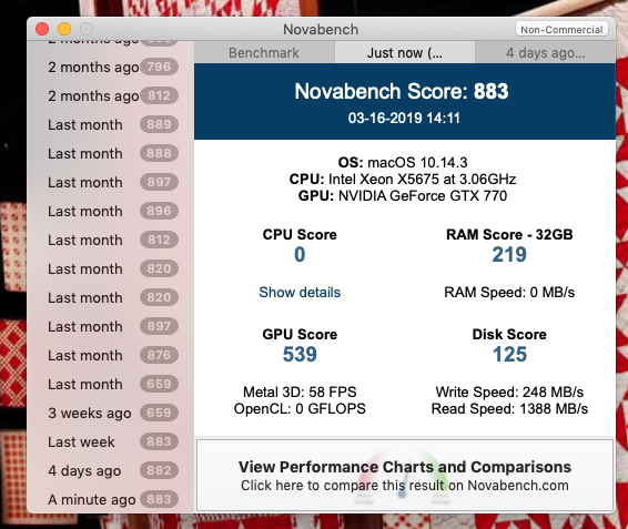

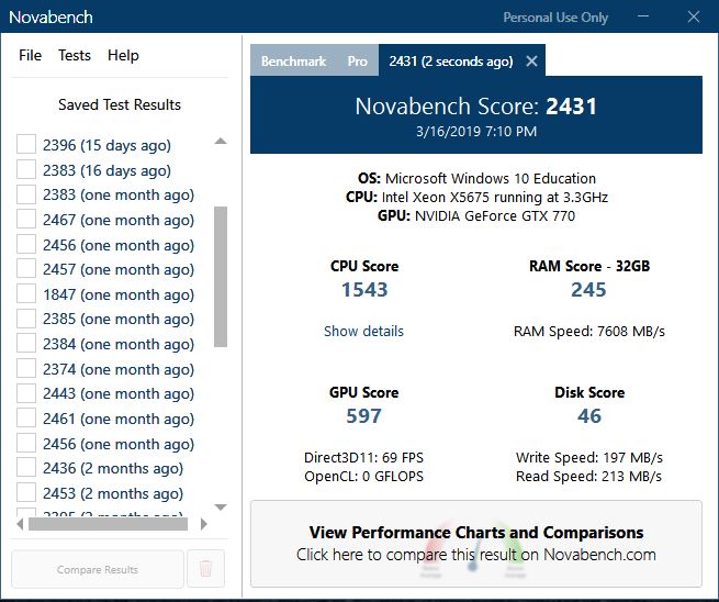

Interesting, I didn't know NovaBench has 2017 version. But anyway, it seems the GPU test still very outdated and unable to measure anything.
I just download and run it with my 1080Ti. Same as yours, shows 1GB VRAM. And obviously the FPS is limited to the monitor refresh rate due to V-sync.
It's the current version to my knowledge, and I'm attempting to use any rendering programs to see which GPU macOS is choosing to use for rendering. Novabench happened to be the first one that natively and solely picked the RX580 in Mojave while only being displayed via the 770. I didn't care what it scored, only that is it uses the RX580 to do it-and it achieved full speed alongside my flashed 770 in Mojave is a bonus.
The pics just show the 770 reporting at start-screen with the 580 being used in the top-left of the render-screen in one, while the other displays RX580 scores while still reporting GTX770 as the display GPU. My GTX would score similar in to my current score in High Sierra and prior, but has Never scored above 30 FPS in Novabench in Mojave, until now. My historical scores support the drop in performance as a result in upgrading to Mojave, I am arguing that this is just as good as web-drivers for me if Apple gets it fully implemented across programs, IF we can only have display in macOS. Adding even more value of having the RX580 in Windows 10 already, which is improved from what I've seen.
Thanks-then I'll presume the 1GB is a Novabench limitation (if I recall my 770 was the same before dropping in the RX580).

Side note, before all the CPU/RAM/OpenCL tests quit working in Novabench in macOS (for me) this machine scored 2220-2430's overall, mostly contributed from the CPU's-but it's got it's perks still. Above are shots reporting success with freely available drivers to anyone with the 770 rendering in Windows-again I don't care about score, I'm amazed it's all working together natively for the most part. Both render approximately the same frame rate in Windows Novabench of ~65-69 FPS on GPU test but the GTX wins marginally.
I am also power limiting these cards currently-so I am expecting some improvement still once I get them powered properly. I'm very interested if a GT120 would work in Mojave the same way since it computes better and peak at only 50w, although I have logged use of up to 25% GPU and 1GB VRAM when utilizing the as a PhysX card in Windows peaking at around 48% power usage. That's around 110w, and the GTX's draw 2:1 so ~73.6w on its booster; the RX peaked at the 70% limiter which is ~129.5w and they draw theoretically around 3:1 ratio which would be ~97.125w (well above spec and in danger zone).

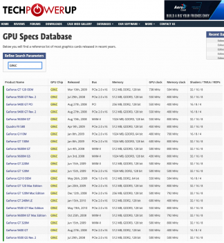

I had a little free time today and a salvaged PC NVIDIA card came into my possession- it was a 9400 GT and after dropping it in place of the flashed GTX 770 and booting into Mojave:
Display was only via the AMD but it leaves one question to be asked-why only Apple/EFI flashed chipset's trigger the AMD's non-display when all setups work fluidly in High Sierra (including the 9400 GT!)? I understand why the older chipset isn't recognized in Mojave, but this is odd-by any angle of attack.

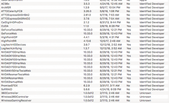

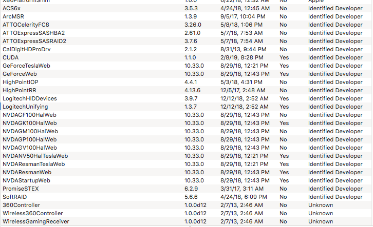

In HS did you have NVIDIA Web Drivers installed, or was this clean OS install?
May want to do a comparison between the hardware extensions in Mojave and HS (clean install) to see what was eliminated and if any NVIDIA products are/were listed in HS that are not in Mojave. If you did have Web Drivers installed, just eliminate any of the ones with Web at the end.
I’ve tried posting selected drivers to Mojave and re-writing for macOS default driver version number without success. Also tried re-enabling the Volta driver from the pulled release with the new driver/replacement set without success. There is something in the NVIDIA “master” files that allows/rejects. Would need to spend massive amounts of time digging into and just not worth it. The hackintosh install route would actually be much easier for this specifically.
FWIW, cards with 9400M have basically been blacklisted from Mojave. Unsure if they were also blocked from HS, but I’m sure code was cleaned up during the Metal requirement.
Reactions: Reindeer_Games
Clean install with restore from Time Machine during initial setup for my recent HS build I threw together; and 10.13.6 (17G4015) works beautifully with or without 387.10.10.15.15.108 web-drivers engaged; with both the 9400 GT or GTX 770 individually, simultaneously, and alongside the RX 580.
Windows 10 had driver conflict with all three GPU's in use, no issues with either the 9400 GT or GTX 770 (not my end-goal but tested for due diligence in exploring single lane GPU architectures).
In regard to the 9400 GT (Tesla), I hadn't found any kext to suggest Tesla architecture would be supported in Mojave (but exploring use) so that I might possiblely use a Apple GT 120 (Tesla)/Quadro 4000 for Mac (Fermi) to run my secondaries I recently picked up while dedicating the RX 580 to the Cinema Display. I understand neither (Tesla) are Metal approved, but both 9400 GT and GTX 770 display Metal quite well that was rendered on the RX 580 in High Sierra.

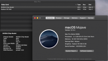

Works like a charm. I need a PC Kepler to test Mojave with to see if it computes but does not display, since drivers are obviously present.
