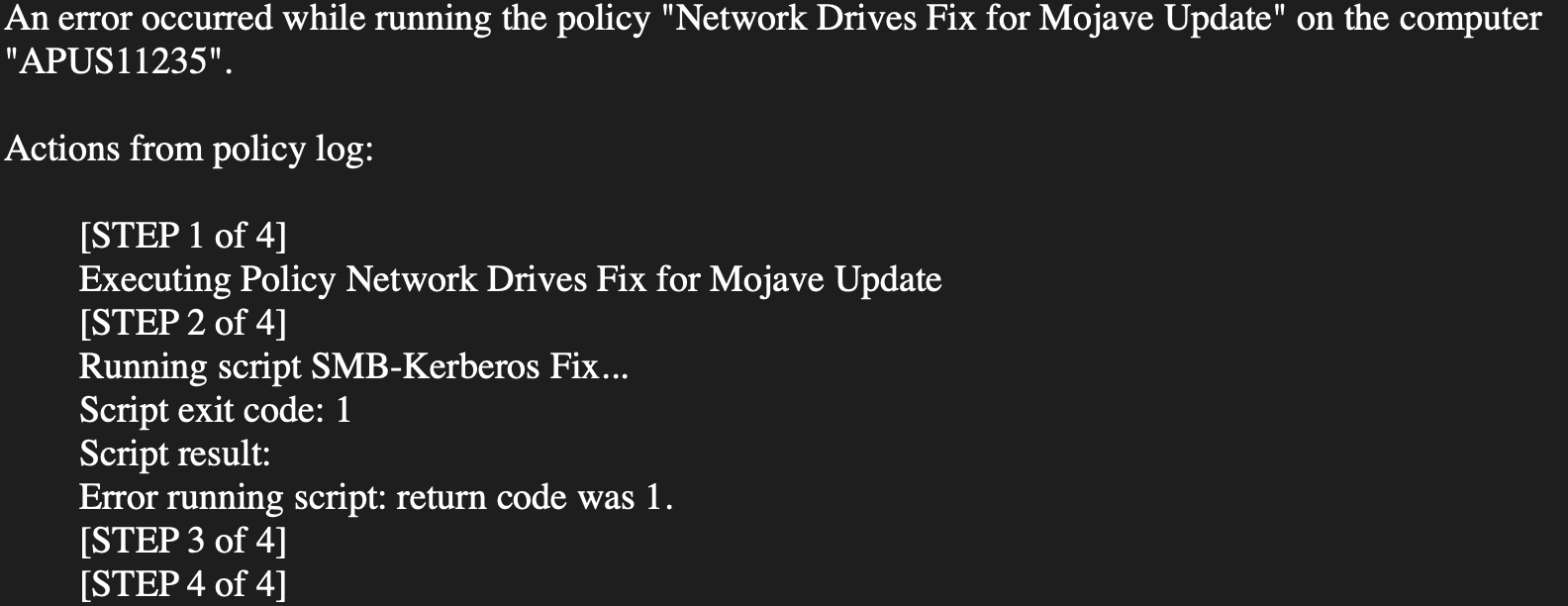

Hi Martin (and others),
I'm attempting to run this in Jamf as a Self-Service item. The script fixes the issue but creates errors every time. Have you seen these errors? If so, were you able to suppress them? Thanks,
