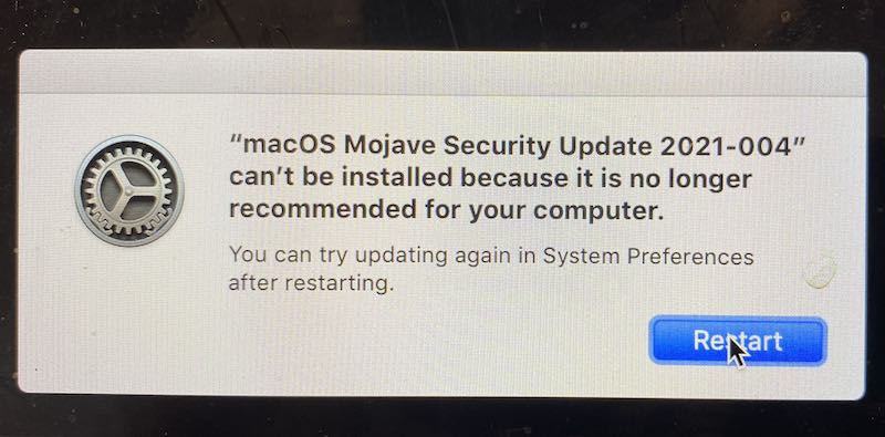

That's interesting - today I restarted 10.14.6 MacBook Air with cached Mojave Security Update 004 and this popped up:
Looks like Apple is blocking this update now on Macs joined to AD.
I've re-downloaded standalone Security Update 2021-004 from Apple, but it's still old version from May 20th.

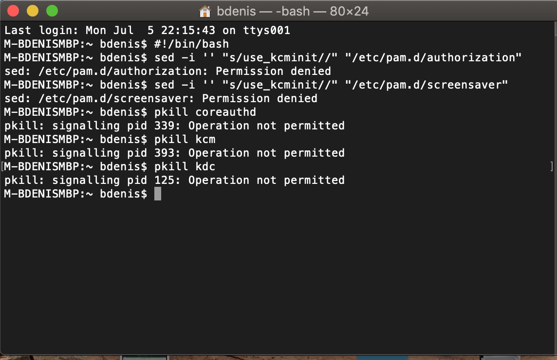

Hello, this might sound silly but how do you run this scrip ? I tried using terminal but I get permission is denied/operation not permitted. Thanks
Thanks a lot "Dacc1234" that did the trick. Extra Thanks to the brilliant ones you found the bug and created the scrip to fix it. Much easier than reloading OS
