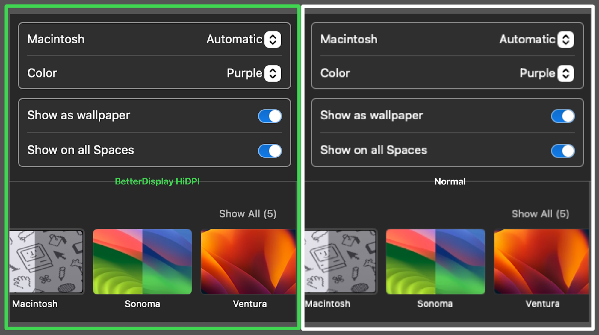

I find using BetterDisplay very helpful too. It would be a shame to just dismiss lower resolution external monitors, without having tried BetterDisplay and its HiDPI settings first.
Below is a simple screenshot showing a comparison of using BetterDisplay vs not using it, on a 2560 x 1440 monitor connected to my MacBook running Sequoia 15.1. The screenshot is zoomed-in by 200 % to magnify the difference. The green framed part is with BetterDisplay. The white framed part is without i.e. normal.
I am not sure if the comparison is technically valid, but it shows the actual difference my eyes are seeing in real life when using BetterDisplay on this setup:
The system setup is:
Resolution: 5120 x 2880
UI Looks like: 2560 x 1440
Monitor native resolution 2560 x 1440 (Lenovo ThinkVision T27hv-20)
Font smoothing: 2 (Default)
200 % zoom:

That is, you do not understand the difference between a program screenshot and a monitor screen. Sad. This program can be useful for internal displays (it was originally created for hackintoshes). It cannot affect the operation of an external monitor, but it can break the interface. If that makes you feel better, so be it. But I don't need it, thanks.
P.S. When you finally understand that this program does more harm than good, another unpleasant moment awaits you: the program does not remove from the computer. Good luck 🙂
Lunar is similar in functionality. But I think it's better not to use it either.

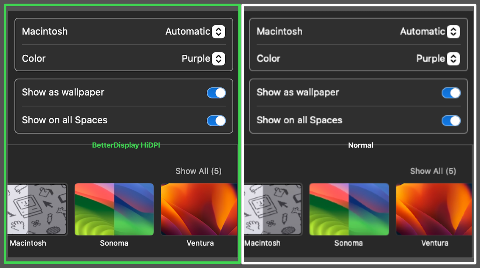

200 % zoom:
I'm guessing your post is directed at me. I was reluctant to post a screenshot, as I do understand (and wrote) it might not be a technically valid comparison, but seeing the same improvement with my own eyes on the external monitor, I decided to post it.
🤔 well ok then...
🤔 well ok then...
I appreciate your post and will give BetterDisplay a try.

It was made clear in the post that it was a screen grab and at 200% to simulate the difference the poster experienced visually.
And not sure what you mean by "more harm than good" .... do you have any evidence, or just trying to be edgy?
