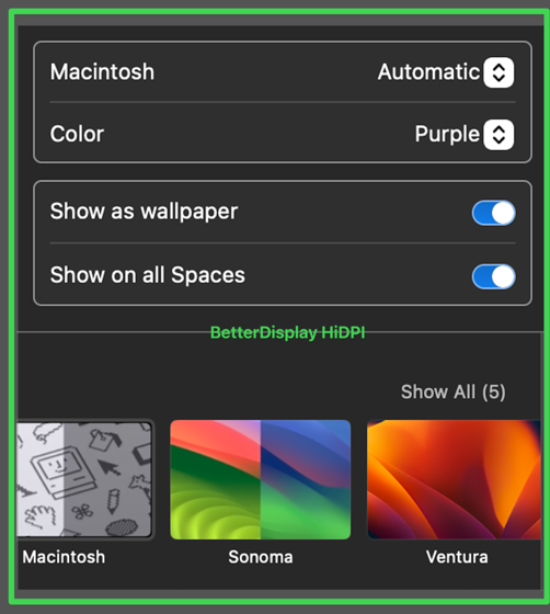

I'm guessing your post is directed at me. I was reluctant to post a screenshot, as I do understand (and wrote) it might not be a technically valid comparison
OK, so I'll try and explain the problem rather than throwing insults...
What effectively happens in the sort of "scaled" screen mode you're using is:
1. Mac OS renders the screen to an internal buffer at the full 5120x2880 resolution you'd get on a real 5k display
2. That 5k buffer is then "downsampled" to the actual physical resolution of your screen - in your case 2560x1440 - and the effect is similar to the "full screen anti-aliasing" that some games offer.
Now, when you take a screenshot in MacOS what you actually get is a copy of that internal 5120x2880 buffer, not the downsampled 2560x1440 image that goes to the screen. So your screenshot is representative of what you would see if you had a proper 5k display and really not at all representative of what is actually on your screen.

@theluggage, that was very helpful, thanks a lot. I'm fairly new to macOS and its scaling concept.

I need to revisit my claim, to make sure I'm not imagining things, possibly by taking a photo of the screen.

Taking a picture is likely to introduce a bunch of other artefacts, moire patterns etc.
Below I've tried to simulate (note: simulate i.e. fake - this is not a hill I plan to die on!) what you'd actually get onscreen, by downsampling your "5k" image to half-size in Affinity Photo - this does proper bicubic resampling, it doesn't just take every other pixel, and I'd hope that MacOS' resampling does something similar. You can zoom in and see that the pixels are much larger than in your original but it still looks pretty good - just with a slight "soft focus" c.f. the crisp 5k version.
As I say - large pinch of salt, this was resampled in Affinity Photo - but I'd say it's clearly better than the "native" 1440p and if you examine it you'll see it is half the linear resolution of your original.
