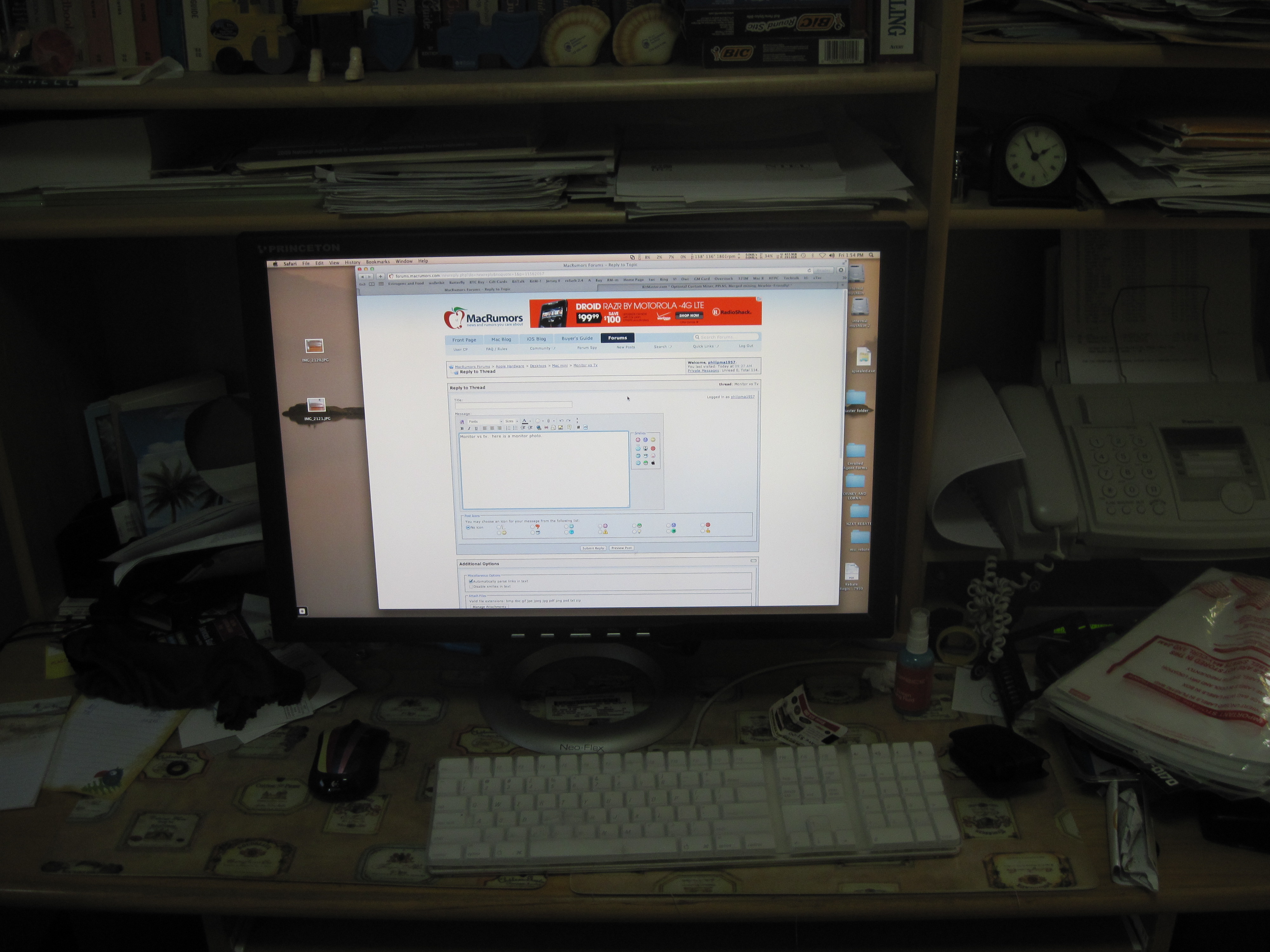

Monitor vs tv. here is a monitor photo. it is a 24 inch monitor 1080p.
no tuner no speakers. I added speakers and a tv tuner.

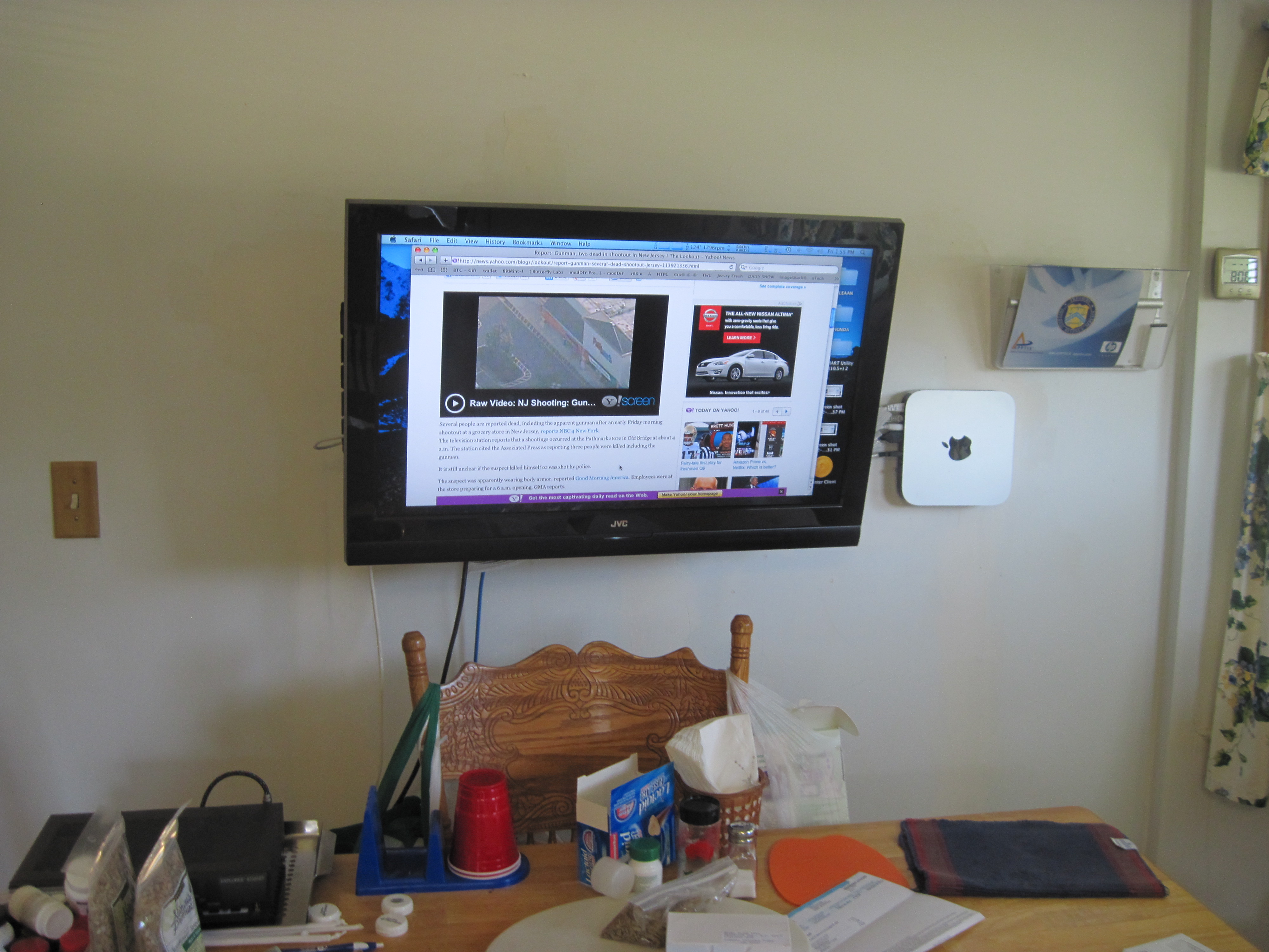

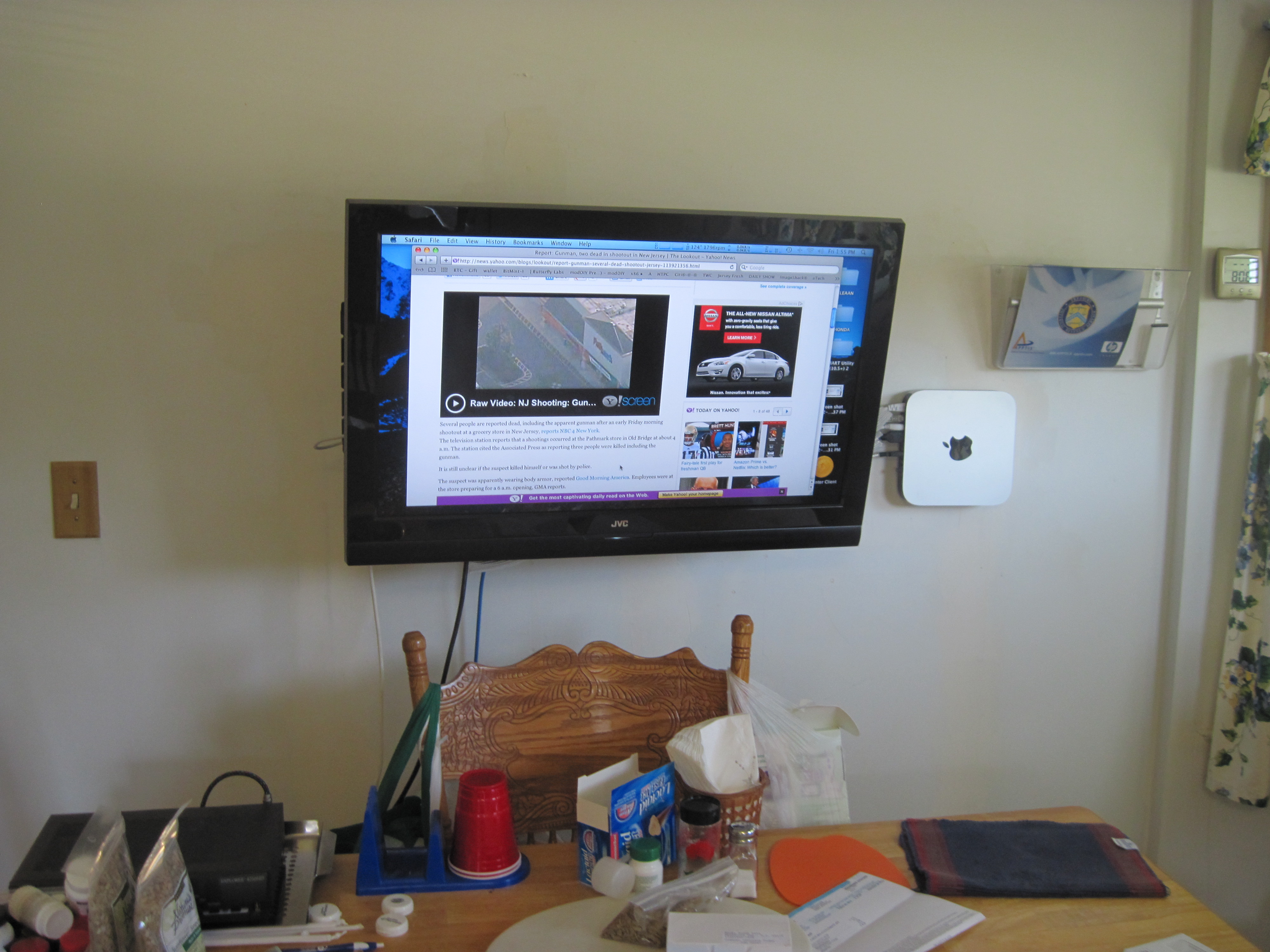

next is a tv photo it is 32 inch 1080p. it has speakers and a tuner.
the 24 inch monitor allows close up viewing .
the 32 inch tv allows distance viewing. I have a 46 inch tv setup it is my preference .
A lot has to do with your eyes. IE if you have good close up vision you may like a monitor even a rMacbook since you will see it clearly. If your vision is good for distance you may like a 46 inch tv from around 9-12 feet. or a 32 inch from 3-5 feet.
If you like to watch a lot of movies a big screen may be what you want.
