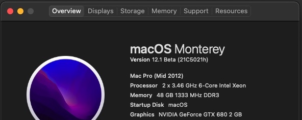

Just updated to OCLP 0.3.2 and am going to try and update to beta through System Preferences on a 12,2 iMac.
WOW, Great job guys!.

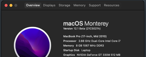

Installed 12.1 beta1 with MonteRand/OCLP 0.3.2 on 2 of my 5,1 machines with no issues to speak of at this point!
Re-patched with OCLP 0.3.1(No network connection needed) of course.
Update:
Macbook Pro GT 330M 2010 17" also updated and running great!!

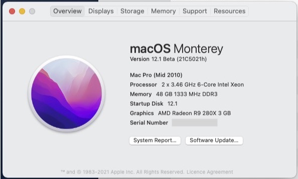

On my Mac Pro 5,1, I tried twice to install 12.1 using the experimental OCLP 0.3.2 Nightly RDRAND Opencore Patcher but each time the installer rebooted to Recovery (rather than the 'xxx min remaining' screen), initially showing the Monterey Recovery selection window in outline only, then (very weirdly) swapping to my Catalina recovery selection window!
I then reinstalled OCLP 0.3.1 and manually added the MonteRand patches (had to use BBEdit, as TextEdit - again weirdly - kept superimposing part of the 'copy and paste' patch text over the top of the SurPlus lines). Although probably not necessary, I used JackLuke's Monterey BaseSystem.fix method to build my USB installer, which unseals the resultant OS. Note: I added the install string AAAAAAAAAAAAAACAAAAAAA== to the CPU1Data and Mask in OCLP, as is my usual method (not sure if it's really necessary but it hasn't failed me yet / remove the string after the OS is up and running, as it apparently causes a 5% reduction in perfomance).
From there, 12.1b1 installed perfectly, with no hard reboots. Everything seems to be working, including BT (which I have feed off an internal USB 2 hub's data wires). So, I'm very impressed and grateful that Syncretic (and any other developers) has come up so quickly with a working fix. We all hope this continues to work with further betas and 12.1+ releases.
This new experimental fix certainly deserves further donations!

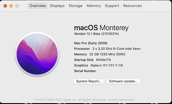

Successfully patched my secondary X58 / Xeon X5675 Hackintosh and upgraded to 12.1 beta seamlessly.
For those manually applying the patch, don't forget to bump your 2 Surplus patches MaxKernel values to 21.2.0 as well in case you still had 21.1.0 there.

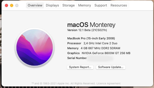

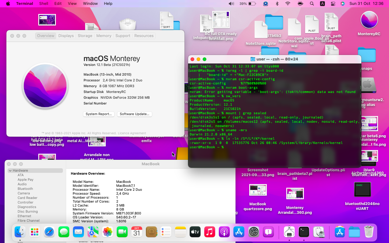

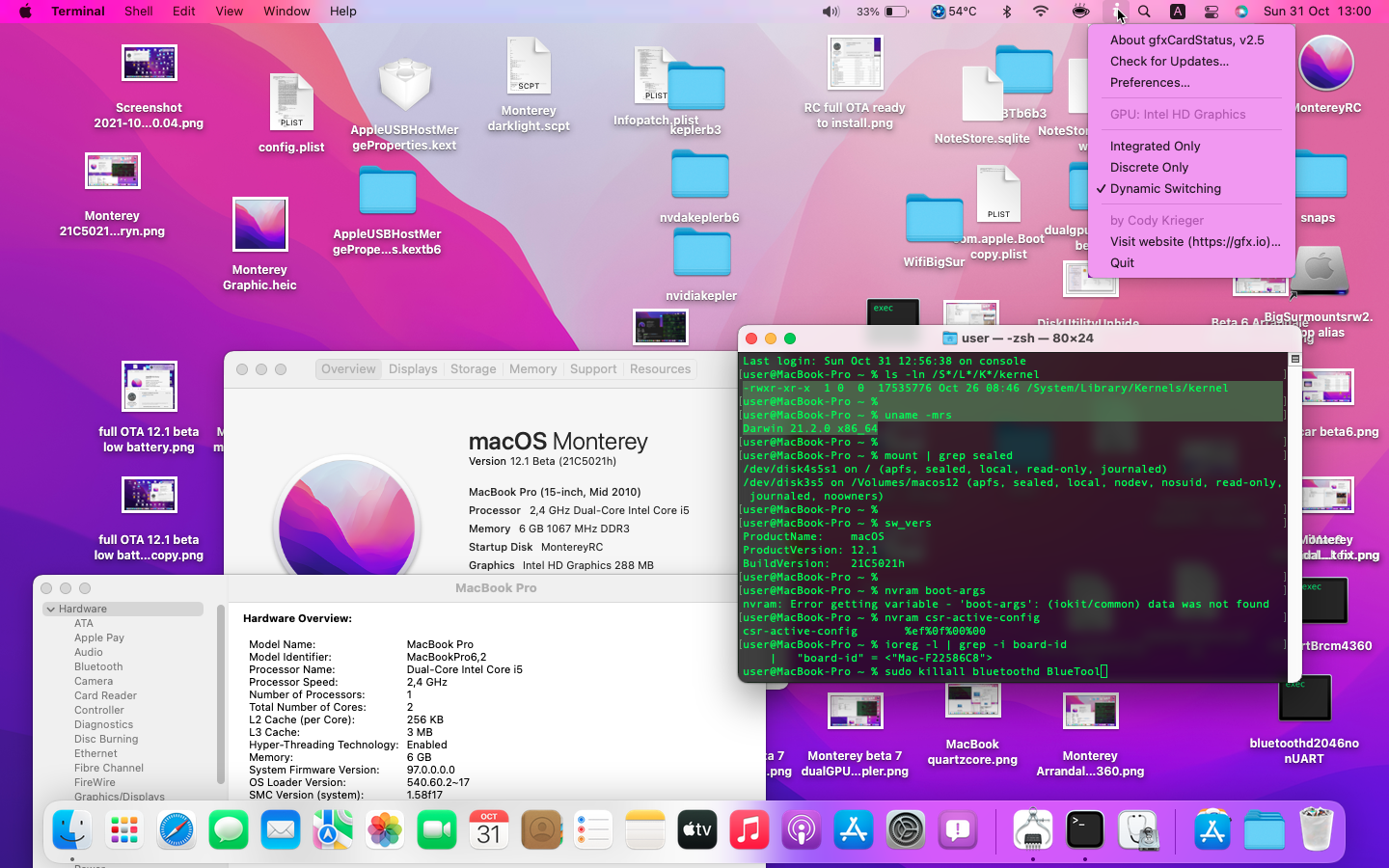

Tested your patch on same external USB disk with MacBook7,1 and MacBookPro6,2 (dualGPUs) and properly worked.
Thanks for your incredible work.
