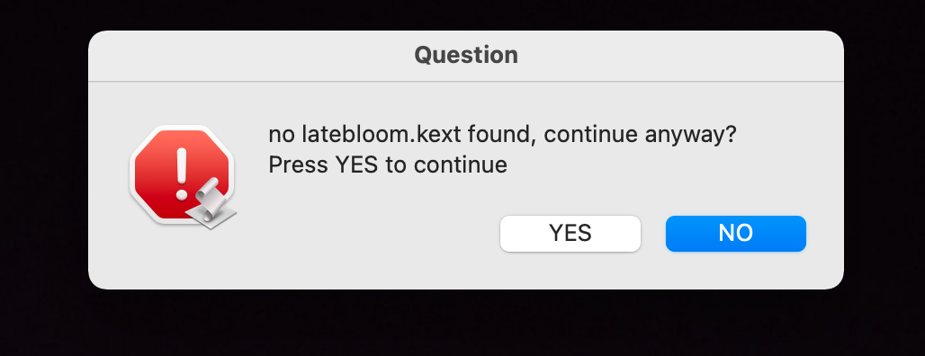

The SurPlus patch works in my computer too, without latebloom and without race condition! Amazing!
On my 5,1 Workstation, using OpenCore Configurator, I disabled (read: unchecked) the LateBloom kext in the Kernel, then using Text Editor pasted the recommended Patch into the config.plist. Reboot to 11.6 was as smooth as silk. Need to test a cold boot, as on cold boots I was having Bluetooth issues (as in, Bluetooth wasn't loading at all), and needed a warm boot following cold to get it to load (sometimes more than 2x warm boots).
So, at this moment, we can safely assume that the drive corruption problems were the results of APFS kext affected by the racing condition between zalloc and corecrypto. And if we apply this patch, drive corruption (which seems happen randomly on unsupported Mac) should not happen anymore (assuming this is the only racing condition that we need to fix).
Is this correct?
