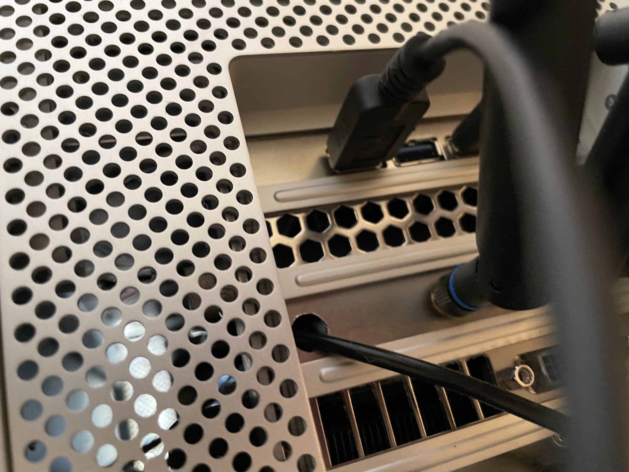

If you don't mind an ugly but very functional fix, I bought this bluetooth/wifi PCI card:
...and this cable:
The Fenvi Wifi card comes with a cable that is supposed to connect to a motherboard USB header. But the MP's don't have one. So you use the extension cable to create an actual USB plug. Then route the USB cable out the back of your computer and plug it into a USB port. You just have to disconnect the internal bluetooth/wifi cards - I just unplugged them and put some electrical tape over the ends so they wouldn't short.
The nice thing is you get bluetooth 4.0 and 802.11ac wifi. The bad thing is you have to drill one hole (I did it in the card itself) and unplug your internal stuff. But it works great. I just airdropped this picture from my phone to the MP to post this.
