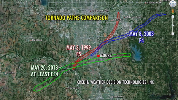

I don't understand one thing here, this is already the 3th time this happens in the same area yet these houses are still built out of wood.

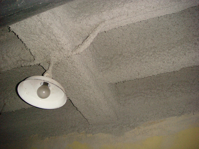

It's not combustible, but it's greatly weakened by the heat. Same with steel. Look on the underside of a concrete slab in a multistory building, you'll often see spray-on fireproofing on the steel and the deck.
Here's an example:
