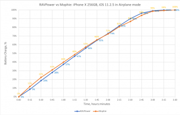

The results are on the graph. The phone was placed on a charger at 0%, and as soon as it turned on (at ~2%) was put into airplane mode. Used the same phone (iPhone X 256GB), same power outlet, and same case (Trianium Clarium) for all tests. RAVPower charged to 100% in about 3 hours and 10 minutes in all tests, while Mophie took from 3 hours and 14 minutes to 3 hours and 29 minutes.

This appears debunks the theory that only the Morphie and Belkin supply 7.5W and that Apple was limiting fast wireless charging to only those two brands, which are the ones it sells in its stores. Sounds like the test was well done.
I did some tests too. When I measured a Belkin, it took 3hr 15min to go from 0 to 100%, although that was not in airplane mode. And when I measured the RAVPower up-right charging stand (Amazon link) that I believe only supplies 5W, it took 3hr 38min. I subsequently returned the Belkin because the difference didn’t justify the higher cost and I liked the up-right design better.
