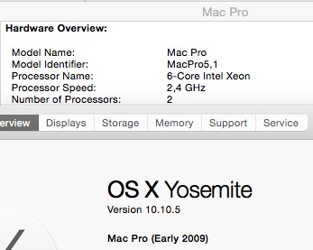

On all of the 'no such thing' comments – sorry for the confusion, I guess I over-estimated how old the computer is, here's a screenshot to sort it out. At least the title of this thread was alright all along.
OK you have a cMP 2009 4,1 that has been flashed to a 5,1 and the stock dual 4 core CPUs have been replaced by a dual 6 core 2.4GHz units, I assume to be an E5645s. That CPU was only installed in the 2012 5,1 DP base cMP.
