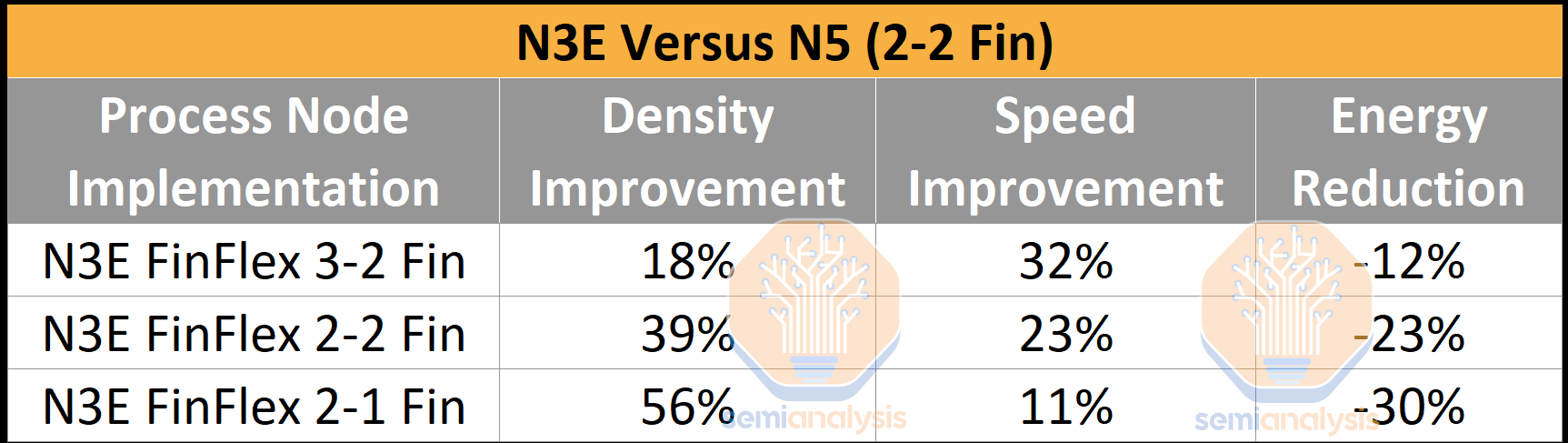

Shrinking finally costs more, Moore’s Law is now dead in economic terms A couple of weeks ago, we were able to attend IEDM, where TSMC presented many details about their N3B and N3E, 3nm clas…
www.semianalysis.com
It's basically an open secret that Apple is the only big (or maybe only-only) customer for TSMC's N3B, which is what's in production *right now today*. N3B is not suitable for phones, it seems, so the phones (Pro line, anyway, the one getting the A17) will go on N3E. That leaves what exactly for all those N3B chips? Most likely the new M3 family. My guess is that we will see M3x Mac Pros by WWDC, probably sooner, and probably new iMac Pros or iMacs as well. Possibly, but less likely, new lower end machines as well, but that would be tough in terms of marketing. Also, perhaps too costly - I would more expect Apple to do basic M3 chips on N3E too.
