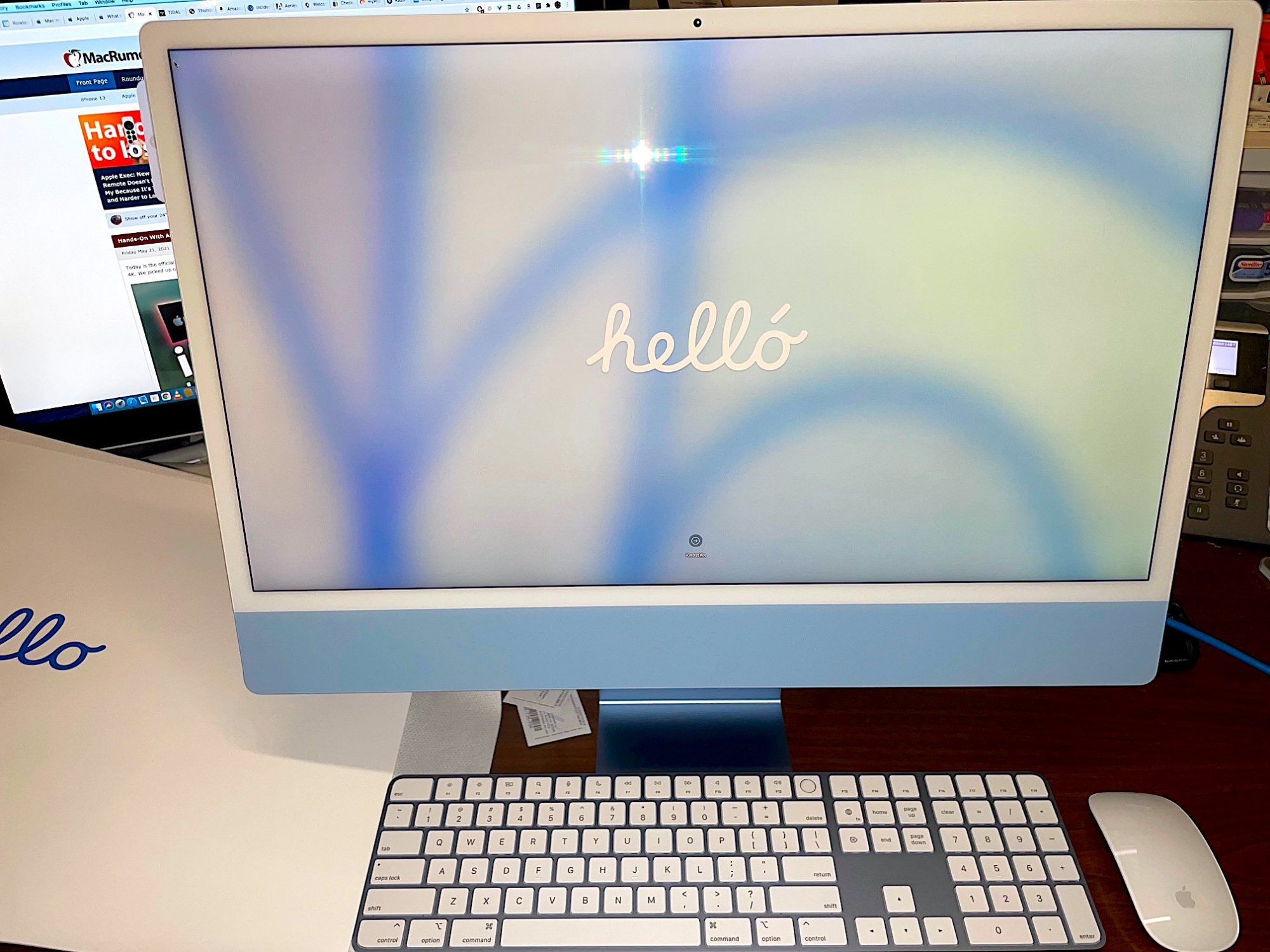

This is correct - having used the new M1 iMac for less than a day, the 4.5K Retina display just overtakes my 24" Cinema & 27" Thunderbolt display from 10 years ago!
The 24" Retina display makes the fonts sharp, crisp, and smoother in transition compared to my old display. It's even more colorful than my 4K 21.5" iMac.
My 24" Cinema display behind the new M1 iMac is connected to my M1 Mini....
