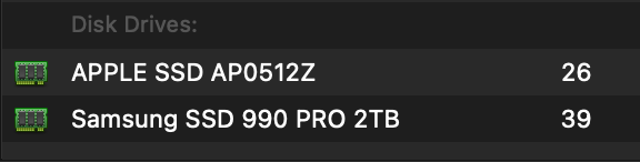

I also use Samsung 990 Pro, but 1TB. This stick is definitely hotter than other SSD like Crucial.
But I also find out the temp is depending on enclosure too.
It seems enclosure with ASM2464PD chip tends to be warmer compared to the ones with JHL7440 chip. But ASM chip provide "faster" R/W.
I own both Satechi TB4 and OWC 1M2 Express enclosure.
Crucial P3 Pro SSD on OWC enclosure is about 10 degree cooler compared to Samsung 990 Pro on Satechi enclosure when idle.
I then switch them up. Samsung 990 on OWC enclosure is about 5 degree cooler compared to when it's on Satechi.
Crucial is about 5 degree warmer on Satechi compared to when it's on OWC.

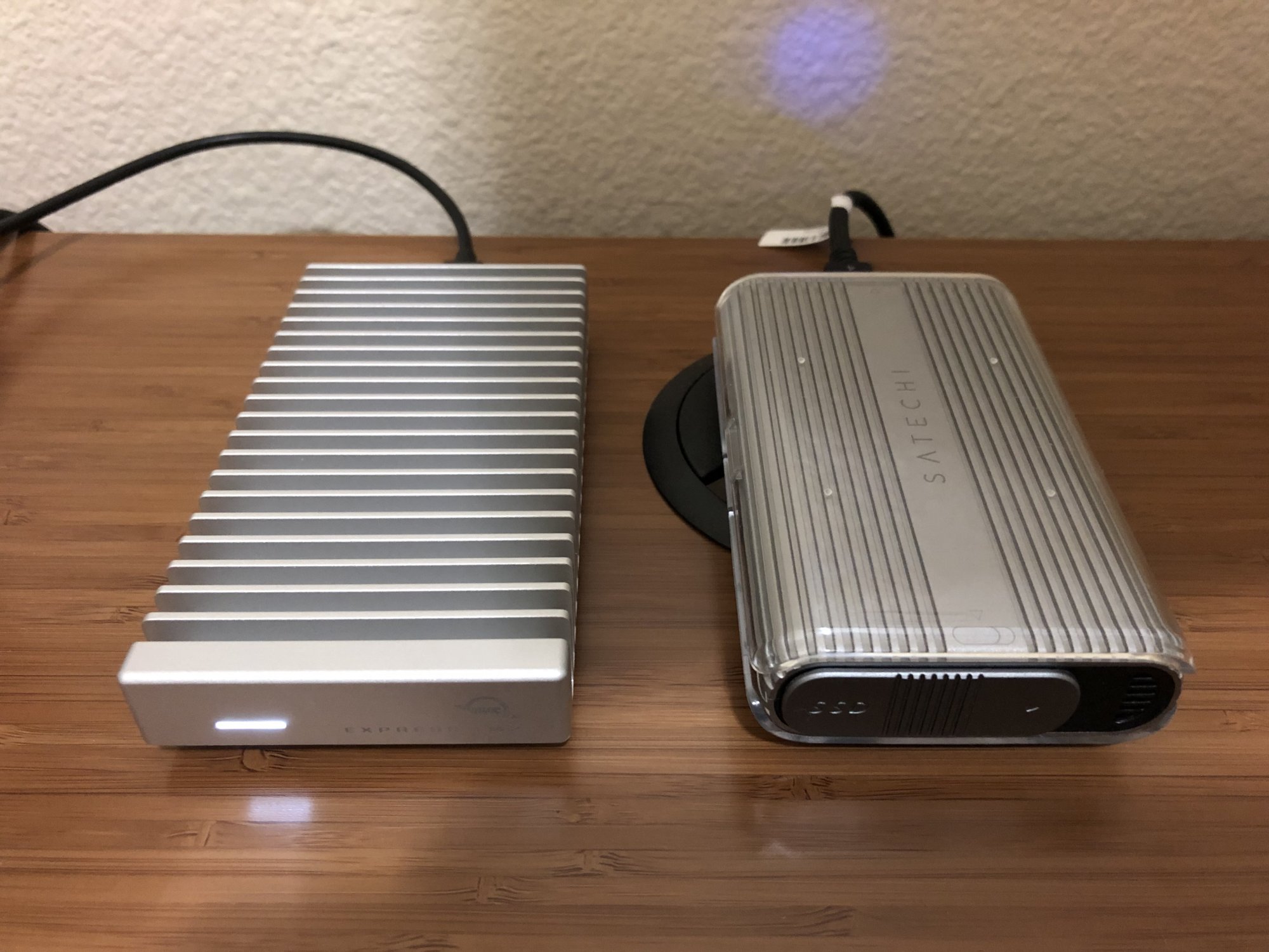

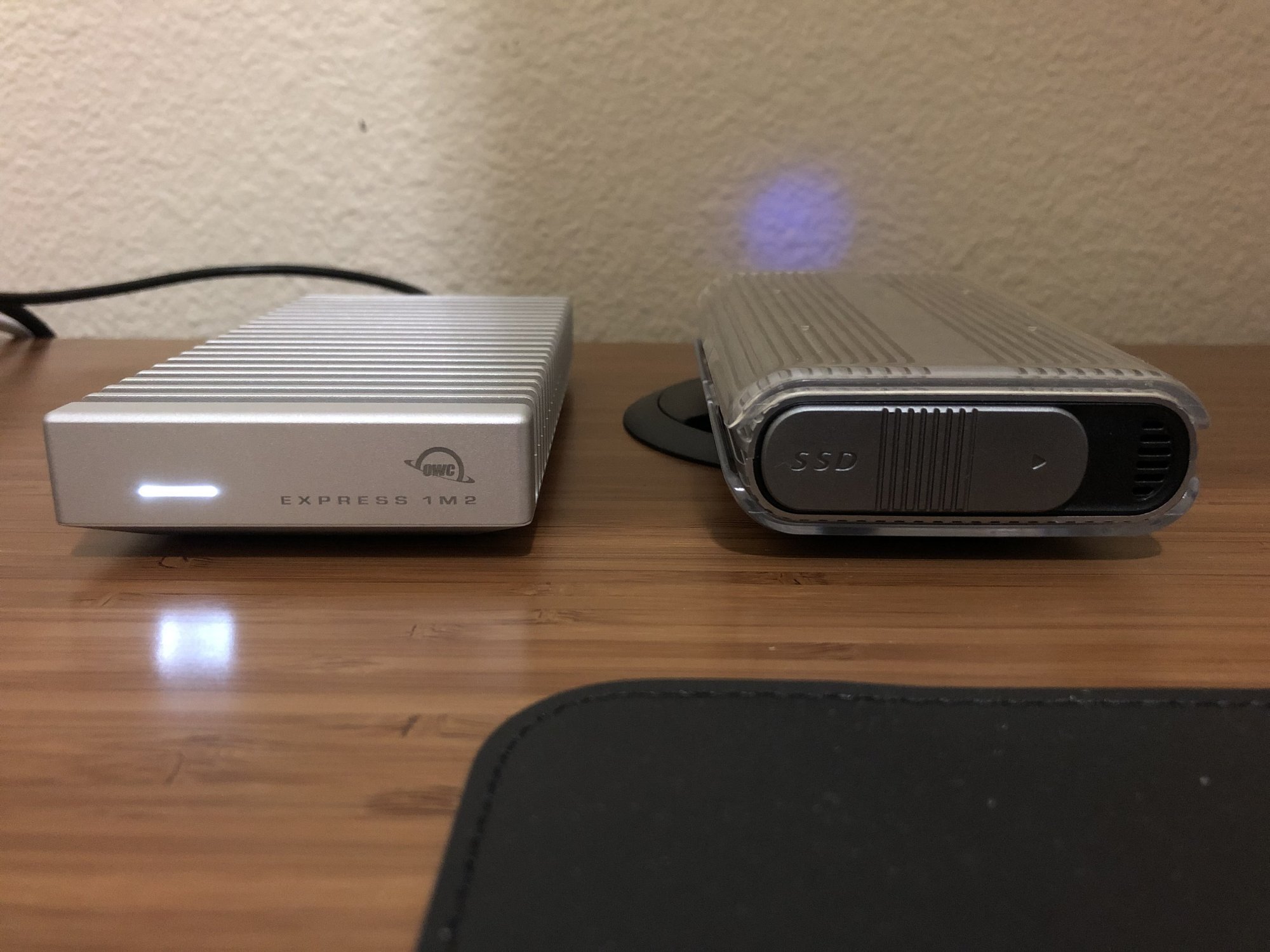

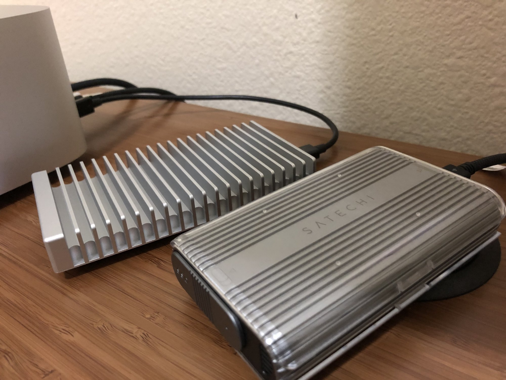

Here are the OWC on the left, and Satechi on the other side. Hopefully these pics help.

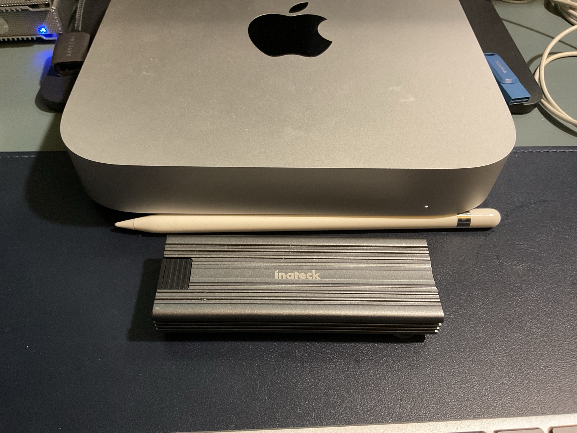

I use a InaTeck encloser cost under $30 last year and works well with the macmini m1.
mostly the MNVe drives are only Time Machine back ups for both m1 computers.
I would upgrade this to a OWC or Satechi one, but my Macs needed other things instead.

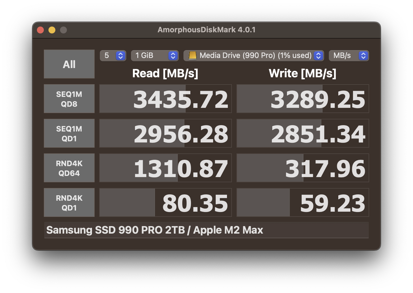

I went with a cheap USB4 NVMe enclosure from Maiwo based on the Asmedia ASM2464PD controller chip. They have the K1695 and the K1717. It set me back $70 with taxes and shipping in EU.
This is the performance I get from it, which I would call very cost effective.

Ok got ya. The Satachi isn't that much smaller. The OWC looks just so much cleaner. Anecdotally, I immediately thought the look akin to the wall radiators here in the EU. Nice.

I've "calmed" down a bit with fomo as I see that the OWC's, as cool as they are, quite substantially larger than the Acasis. Have the 1M2 measured about the size of an 13 Mini with the height of a MagSafe battery attached lol.
I'd love them on a desk but my enclosures will be exclusively for backups as DAS, on the go and rotating to offsite locations. No cooling fins to catch on, light, small. Again, on a desk these (OWC) would definitely be my first choice.

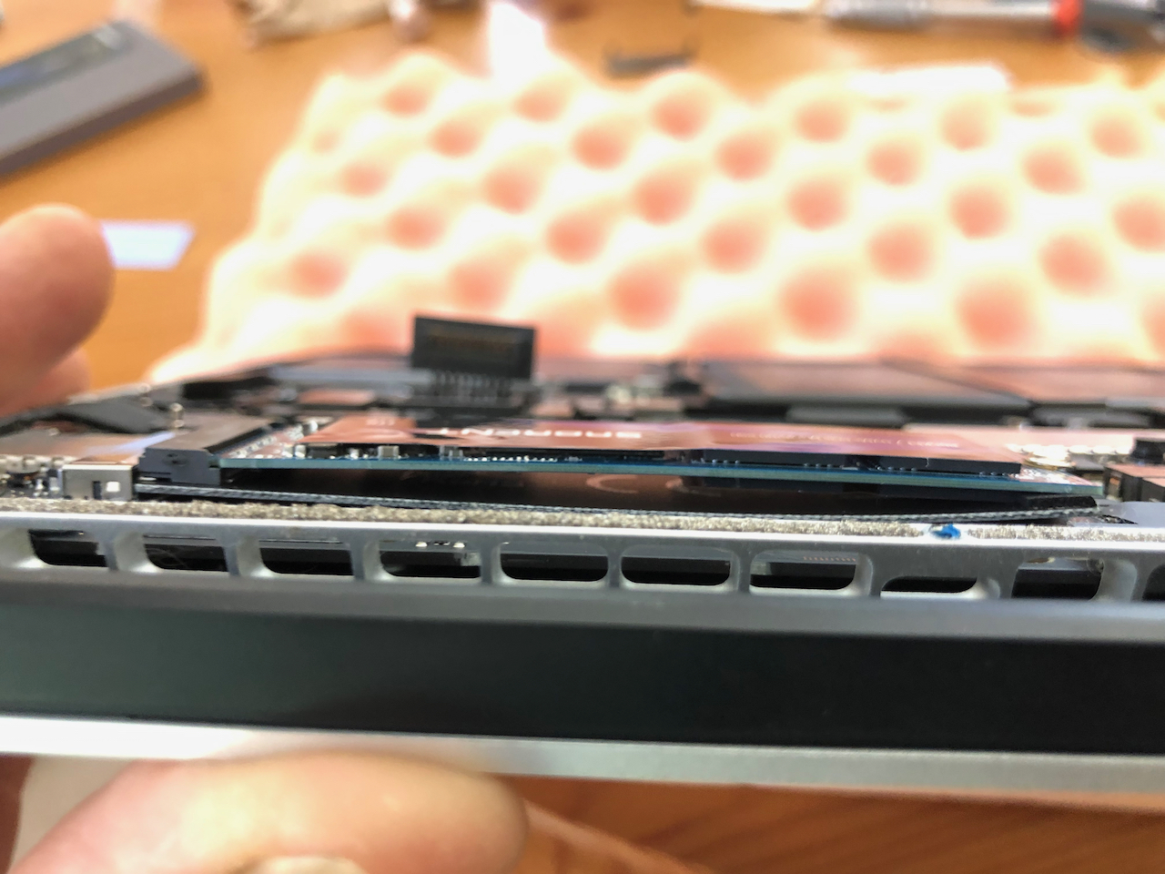

I {infamously} installed a Sabrent 2080 m.2 to a Syntec 'long-adapter' with discernible 'bowing' in my 2015 13" MBP with no thermal pad, with much cringe along-the-way:
It performs just fine ;)
