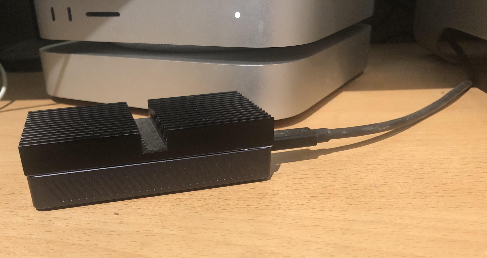

So at 01:30 this morning, I ordered this heatsink. It said Sunday delivery when I ordered but it turned up at 14:00 today. Superb service by Amazon.
I've fixed it to the enclosure nice and tightly with just a couple of cable ties, I don't have any thermal pad between them.
My Studio is mounted under my desk and the drive is plugged into the back and sitting on some stuff stacked up under my desk. It's not visible.
The difference is incredible, that extra heatsink means it's barely warm to the touch at idle and during a large copy, it warms up by three or four degrees, nothing more. I have an IR thermometer gun which is what I used to check the temperature.
It's not pretty but as I can't see it, I don't care. For the sake of less than six quid, this was well worth it.

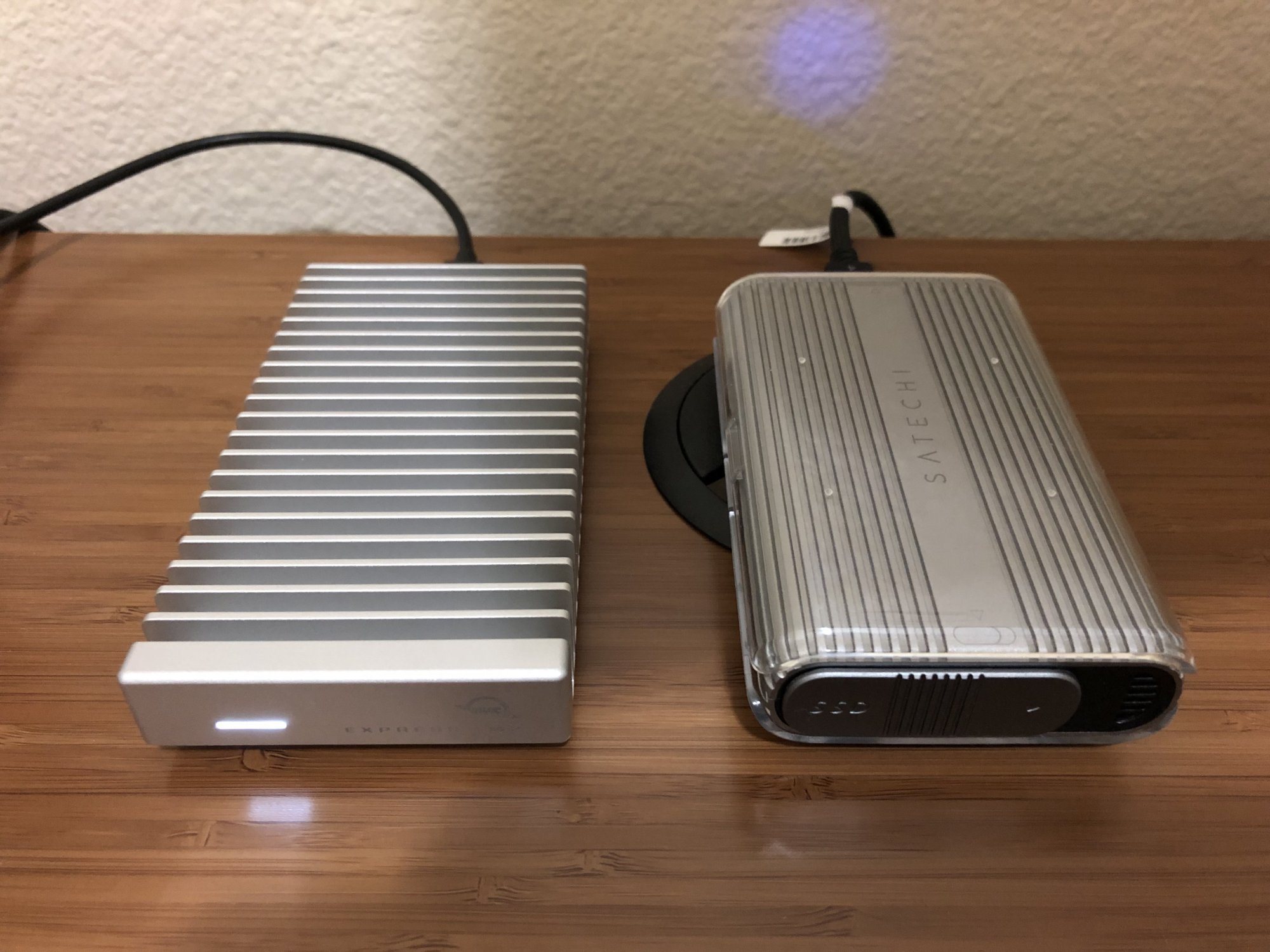

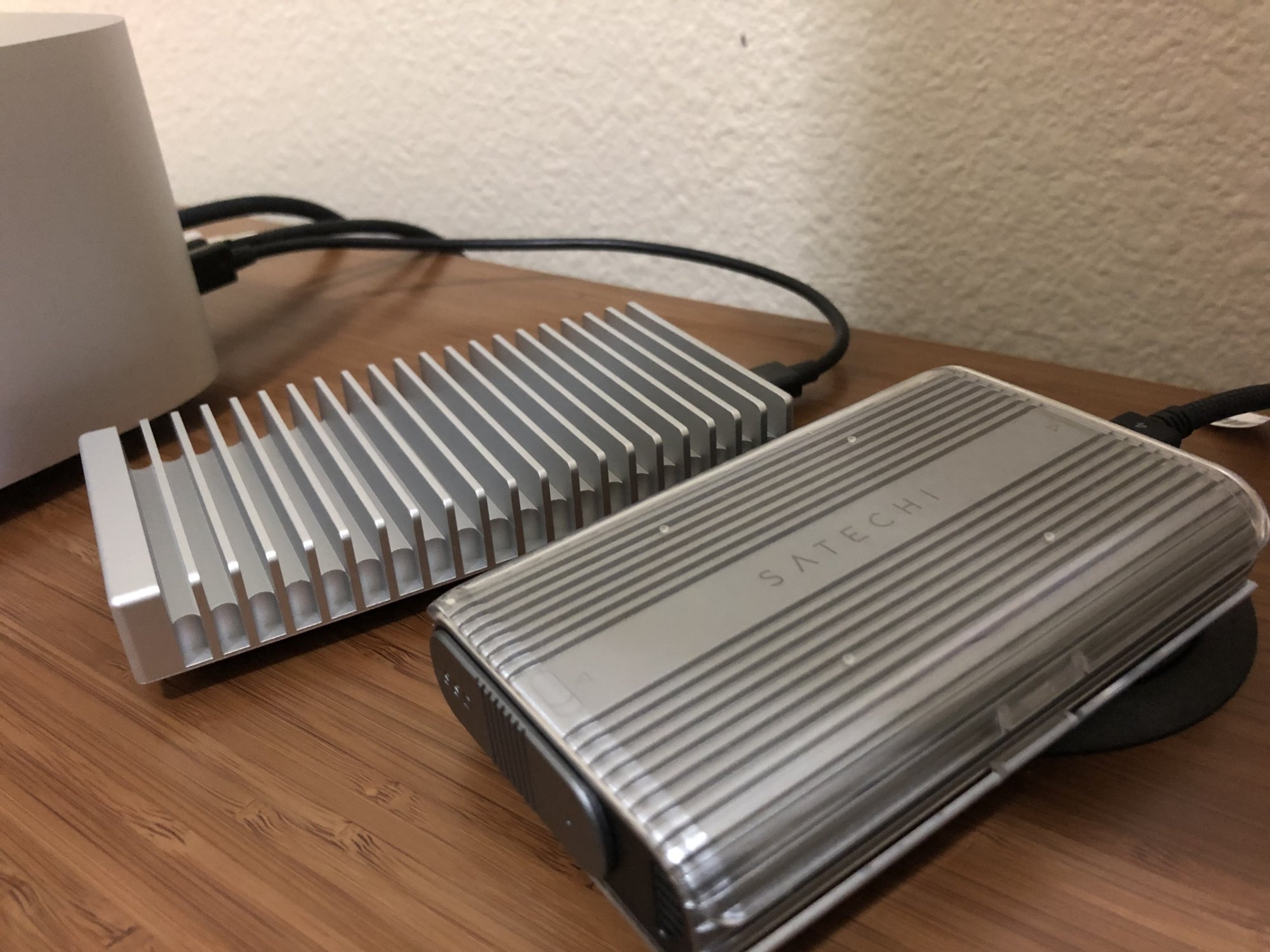

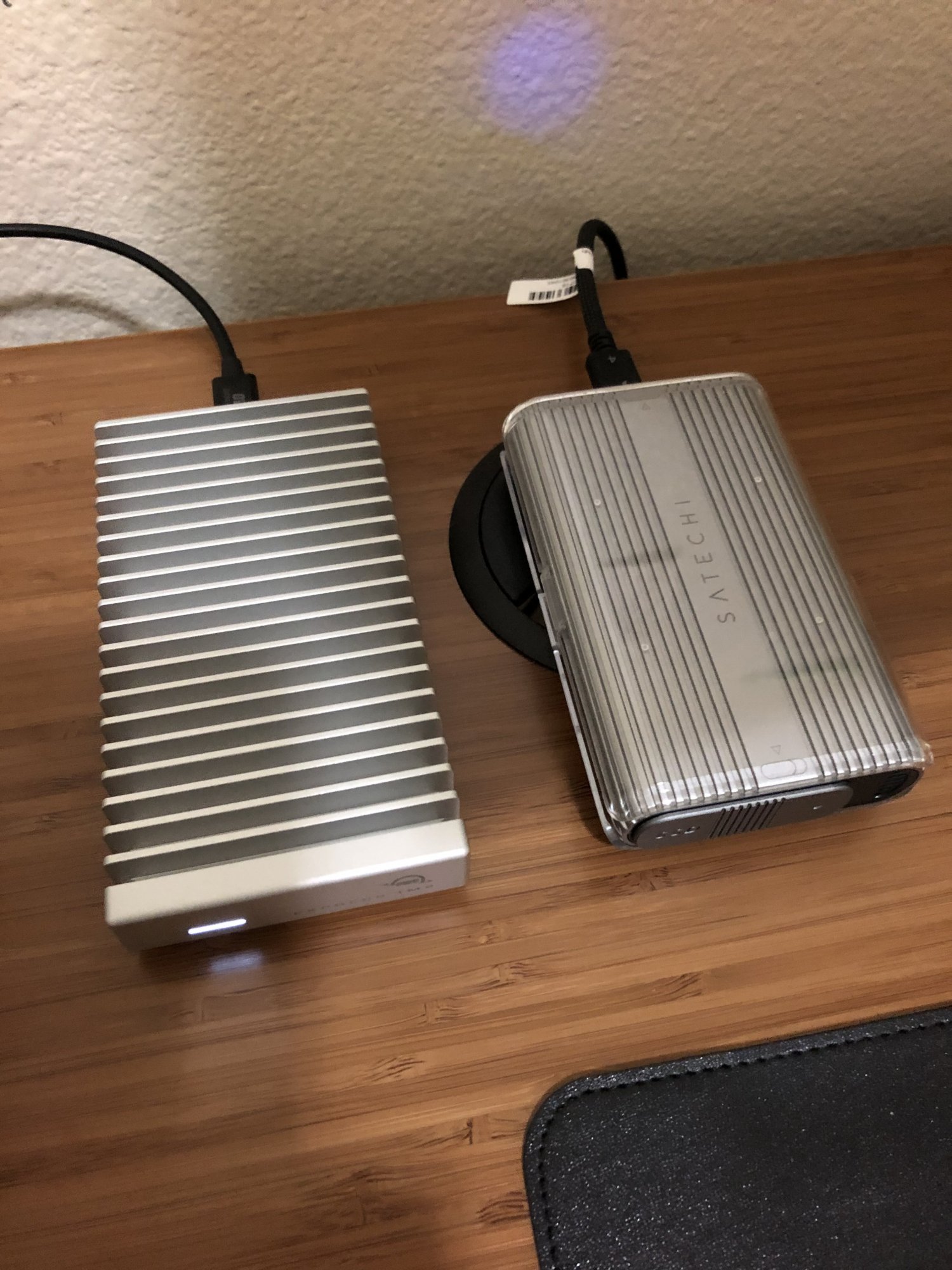

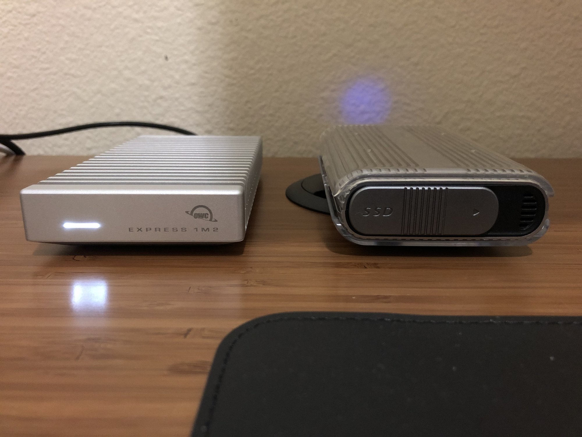

I own Satechi, not Acasis.
I bought the OWC directly from their US site.
Here are the OWC on the left, and Satechi on the other side. Hopefully these pics help.View attachment 2325571
You've said already not having an Acacias but Satachi instead. Are you finding the OWC 1M2 enclosure running quite noticeably cooler?
