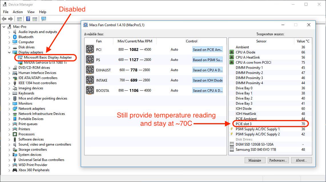

However, I wonder if there is any way to stop the GT120 seats there at above 70C which is not even enabled.
I think this surprised me the most. Even with the card disabled in device manager it still drives a display just fine. I wasn't expecting that.

No, I didn't get the display from it if disabled. However, MacsFanControl can still read it's temperature sensor's reading.

Update 1: I can actually get display from the disabled GT120. 100% sure. I just tested it. You may try it yourself.
If I didn't connect the display to the GT120 during boot, then after I boot to desktop, I won't get anything if it's disabled.
But if I let the GT120 display the boot screen from the very beginning. The card actually can continue display even I boot to desktop. And I can use the GT120 to display the device manager to show that itself is disabled. Very interesting. I bet that's because of the EFI still working. In fact, the screen is accelerated as well.
Now it make sense. The card always working, never stop (even disabled). And due to lack of proper driver support, it's actually operating in high power setting (even at idle). Therefore, the temperature sensor still working and transmitting temperature to MacsFanControl. And stay at about 70C.

And once the card is disabled. I can remove all the auto update block. The card will keep disabled on the next boot. And I don't need to worry about other hardware's driver update.
I am now wonder if we will get this in 10.14 as well. As long as the EFI is working, we can get the normal accelerated display (but UI rendering may be a problem if METAL is really required).
