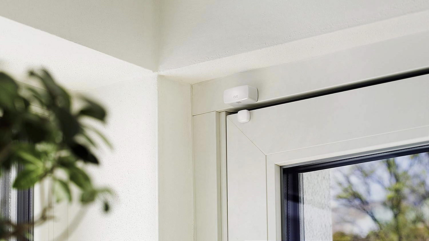

Just get a door sensor, no need to fiddle around with motion sensors and their direction or maybe find a new home where people don’t sneak in while you are sleeping, creepy. Wyze makes cheap door sensors as well as a motion sensor if you prefer that.
Reactions: Jay-Jacob
I didn’t consider door sensor. Forgot they exist. Was focusing on Philip hue cos of my lights. Thanks for tips. Will look at door sensor before decide what get.
