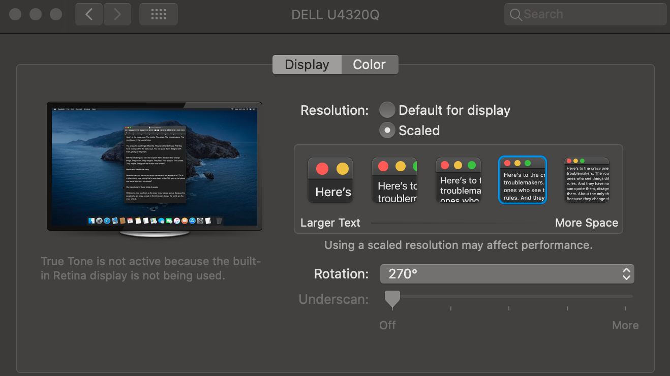

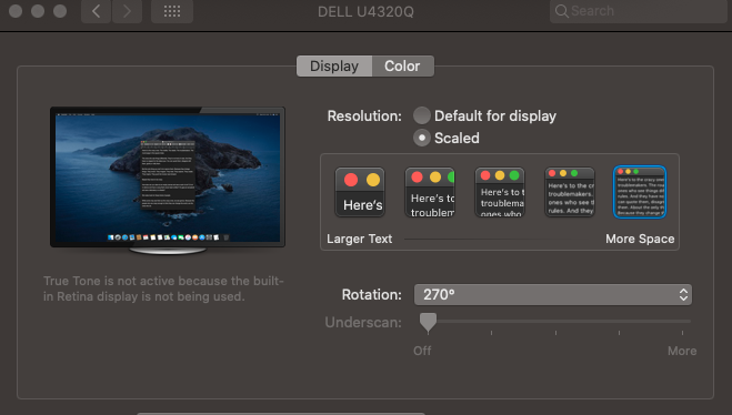

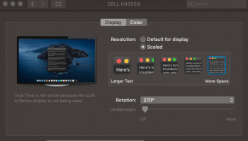

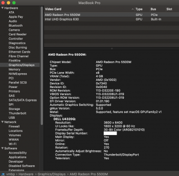

Think I figured it out... I have a 4K monitor portrait rotated (270 deg), and I was having issues with the mouse clicks being offset at the bottom of the screen. While gathering specs to post on this thread, from "System Report -> Graphics/Displays", I noticed the reported resolution was way off from my actual 4K resolution: 3600 x 6400. So I instantly got the idea that this was a bug with UI scaling.
I went to System Preferences -> Displays, my resolution was set to "Scaled" and under that are 5 boxes, from "Larger Text" on the leftmost, to "More Space" on the rightmost. While having the problem, I was set to the 4th box, the one before the last. When I set the box all the way to the end, "More Space", my display and UI went into true 4K resolution, and the offset problems were gone. Reopening System Report showed a much more sensical number, 2160 x 3840 (4k, backwards, since it's portrait). But for many people, this means the text is too small.
So while it's not a fix for those who need scaling, the point is that it pinpoints the problem, so we might get some attention to this matter.
I didn't check each scaling option, but I am assuming any scaled option (other than Most Space) in Portrait mode is going to be affected by this bug.
Confirmations of the same behavior might help. I am including some specs below.
Newer monitor with USB-C port, directly connected to Macbook Pro 16" with USB-C to USB-C cable.
To shorten this post I've placed screenshots and System Information within Spolers.
Scaled - 4th box, one from More Space
DELL U4320Q:
Resolution: 3600 x 6400
UI Looks like: 1800 x 3200 @ 60 Hz
Main Display: Yes
Rotation: 270
Connection Type: Thunderbolt/DisplayPort
Television: Yes
Scaled - 5th (last) box, More Space
DELL U4320Q:
Resolution: 2160 x 3840
UI Looks like: 2160 x 3840 @ 60 Hz
Main Display: Yes
Rotation: 270
Television: Yes
10.15.7 (19H2)
MacBook Pro (16-inch, 2019)
2.3 GHz 8-Core Intel Core i9
16 GB 2667 MHz DDR4
AMD Radeon Pro 5500M 4 GB
Intel UHD Graphics 630 1536 MB
