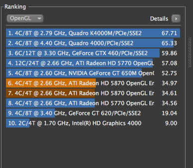

Evening Amigos !
... put in some work an was running that 5870 !
Here the facts :
  • flashed my PowerColor 5870PCS+ with the vervet_netkas.rom got bootscreen and native regonize in OSX *yeay*
  • After flashing the MP 1.1 detects and powers the card in slot 1 !
  • My mistake was not running the 5870 in pic-e 8x in slot 2 just on 1x *dummy me*
  • After running on slot 1 in 16x i benched it again in cineb

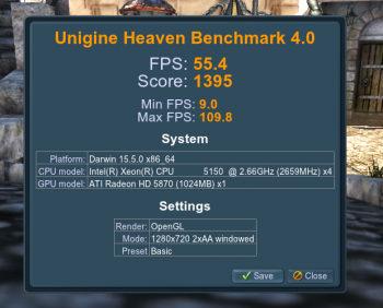

[doublepost=1466722730][/doublepost]... and one more score with Uningine latest version, i think a quite good score cheers !
