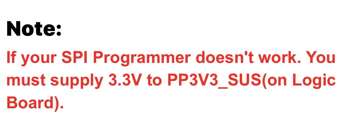

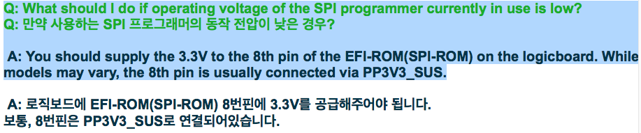

Sharing info from an eBay vendor selling flash gear for flashing efi from the diagnostic port. The same should apply using a Pomona clip.
This may not have the correct connector. You need one from the 2009/2010 MacBook Pro. It’s the same as the one near little frank.
[NEW] EFI-ROM Converting board for Apple MacBook J6100 SPI-ROM EFI ROM https://rover.ebay.com/rover/0/0/0?mpre=https://www.ebay.com/ulk/itm/323225409462
First, thanks for bringing the external programmer for J6100, I've only knew the chipmunk ones.
Like I suggested before on the thread, inject 3V3 on VDD, GND on VSS and use the Pomona clip + Pi with flashrom.
BTW, you don't need a bench variable power supply to do this, you can use 3V3 from a ATX PC power supply. If I ever need to do this again on a high drain device, I will power the Pi and the SPI flash from the ATX power supply, to have common ground on everything. It'll be a lot easier than desoldering, flashing on my external programmer and soldering again, plus not needing to remove the logic board, just the processor cage.
