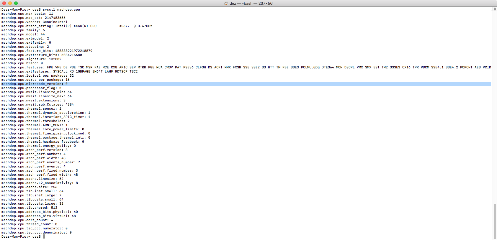

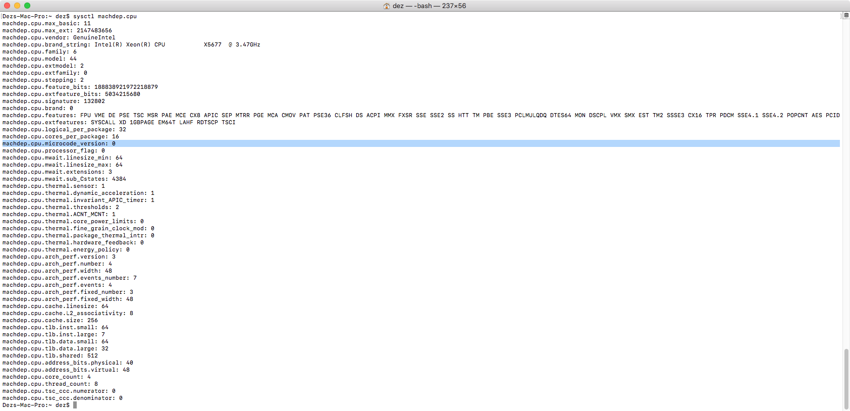

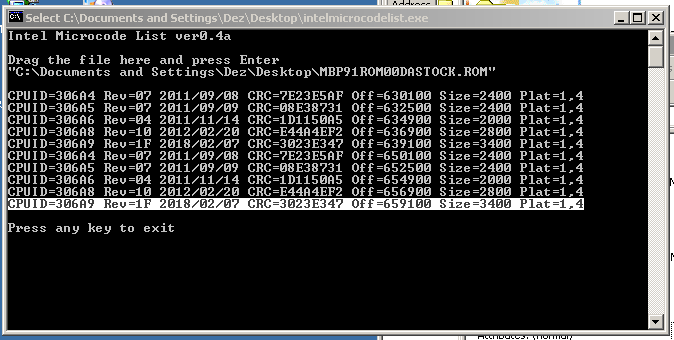

Just a heads up guys theres a New BootROM update in 10.13.5
interestingly I was curious if this update contained any new Microcode, strangely the intel microcode tool reported that there where no microcodes in the Firmware file
and indeed after installing the new Firmware OS X is reporting no microcode version as-well (also it installed very quickly much quicker then other firmware updates have)
it seems like Apple REMOVED all microcode from the Mac Pro EFI in 0087...
I wonder why they did this... I wonder if its a bug or something. (note iv not yet installed 10.13.5 it self yet)

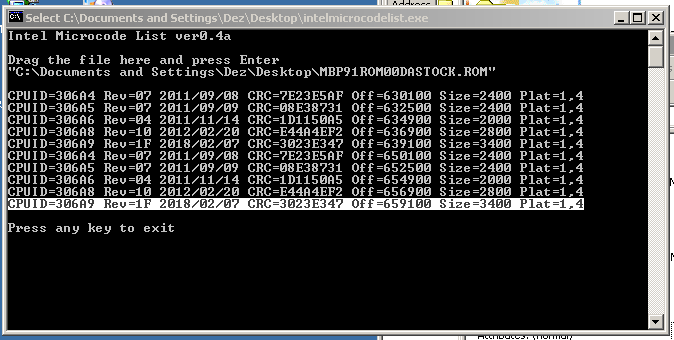

[doublepost=1527879871][/doublepost]quick update: it looks like my MBP9,1 which also got a FW update, does have updated microcode for its CPU.
I suspect Apple may of messed with the Mac Pros BootROM? but im not sure how to submit such an issue to apple...

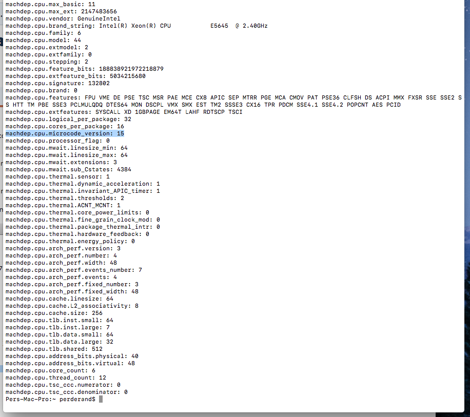

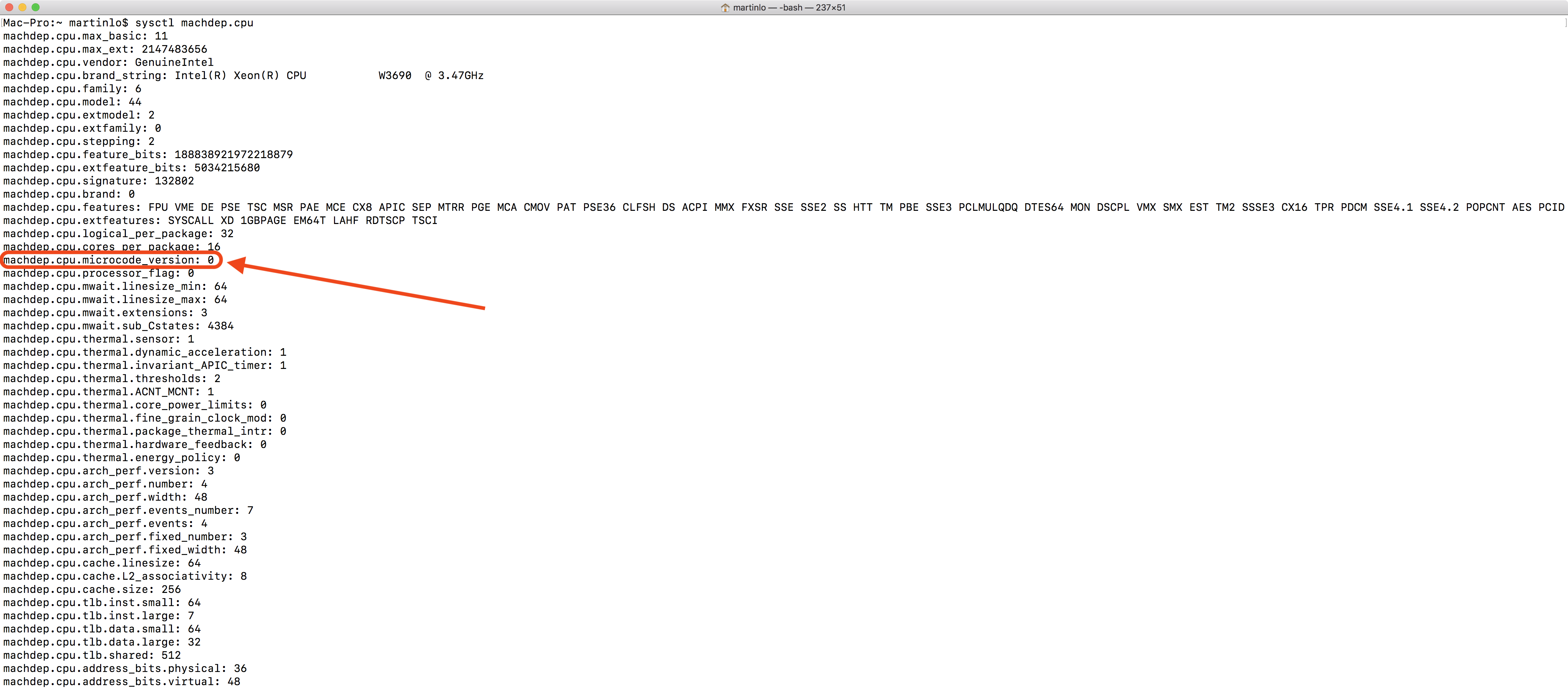

What is the microcode version suppose to be? Have you submitted a report with Feedback Assistant?
it should show "15" rather then 0 there (if its running the non-patched microcode) if it shows a 0 it means no microcode is loaded.
as for FeedBack assistant, im not running any Betas at the moment so i dont have the App sadly and im not sure if I can use it outside of a beta?
considering this firmware version has no microcode at all I wonder if changes the behaviour of X5687s... cc @tpivette89 (although if what I suspect is stopping the X5687 from booting is true, then Microcode or no Microcode would not change that sadly)

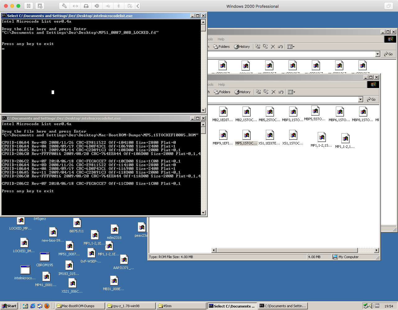

OT - this is all good fun! Can someone point me at a link, or links, which provide details of digging around in BootROM and the tools available to do this digging? Preferably tools that will run in macOS (GUI or CLI). I downloaded the EFIgy tool from github and I'm hooked. TIA.
for checking the microcode version im using intelmicrocodelist.exe its a small windows CLI that checks any file for intel Microcodes and if it finds them it displays some info about the microcodes.
Thanks - any native macOS tools that will run in Terminal? Or in Linux for that matter as I have Linux VMs (or a Linux tool might be recrafted to work under Darwin).
