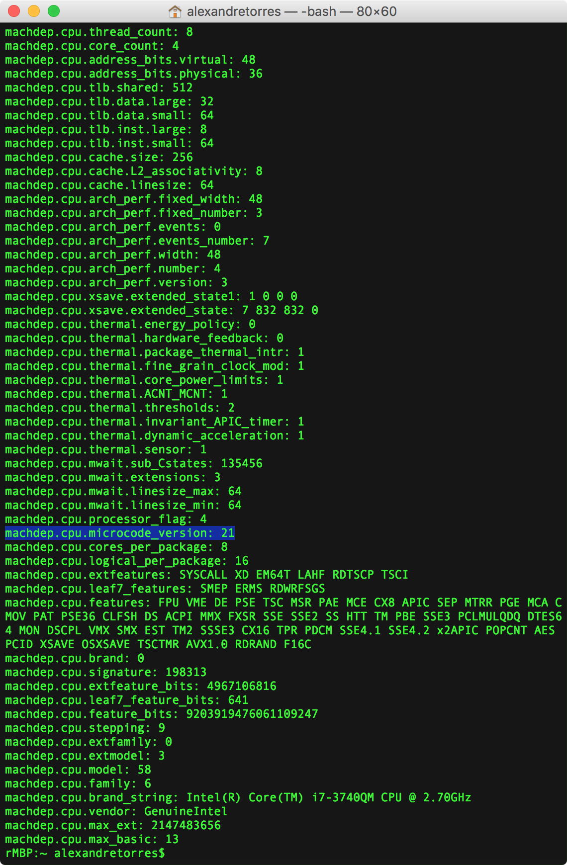

10.13.5 updated the firmware on my MacBook Pro too with i7-3720QM CPU. From MBP91.00D9.B00 to MBP91.00DA.B00. The microcode version is 31. I forgot to see what it was before the update.
On my MBP10.1, still on 10.12.6 and with previous BootROM, the microcode is 21.

It seems that every supported mac got a microcode update with 10.13.5 except the mac pro towers.
On my 2010 macbook pro, the microcode went from 4 to 6.
Only the mac pro towers went from 15 to 0, meaning no added microcode and using the original one inside the cpu.
It has to be a mistake.
