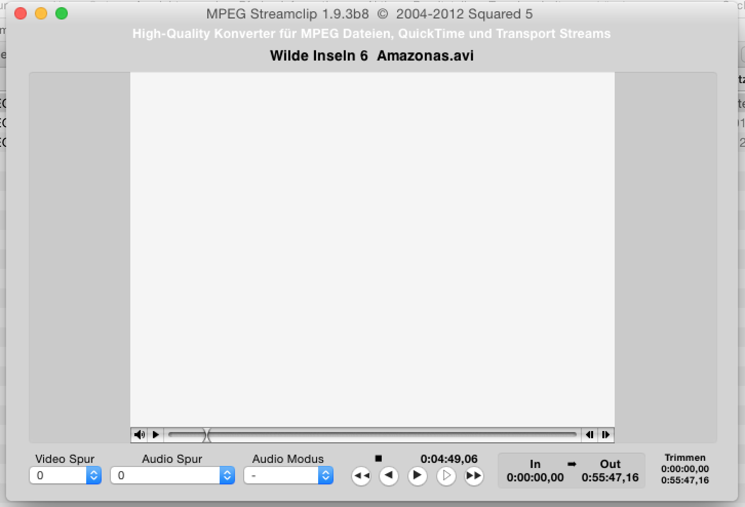

By simply defining the bit rate to 2 mbps I was able to export the trimmed video to a reasonable size (slightly less than the untrimmed original) WITHOUT using any compression and WITHOUT further reducing the quality.

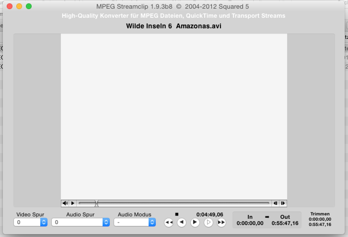

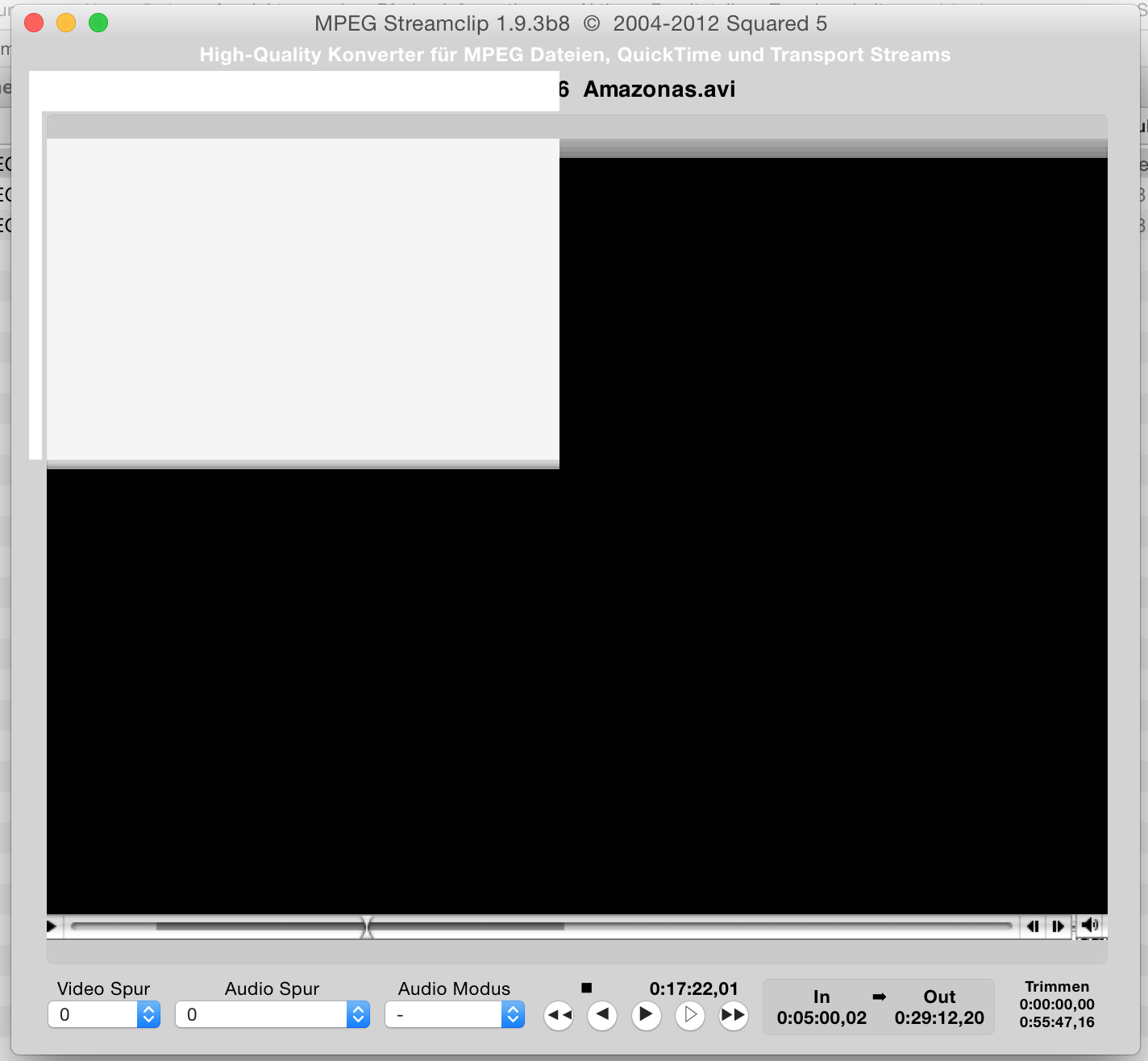

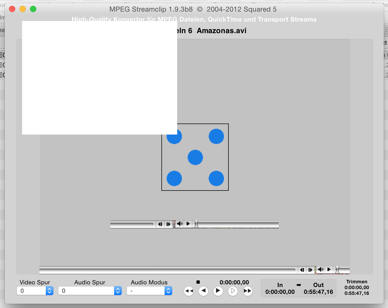

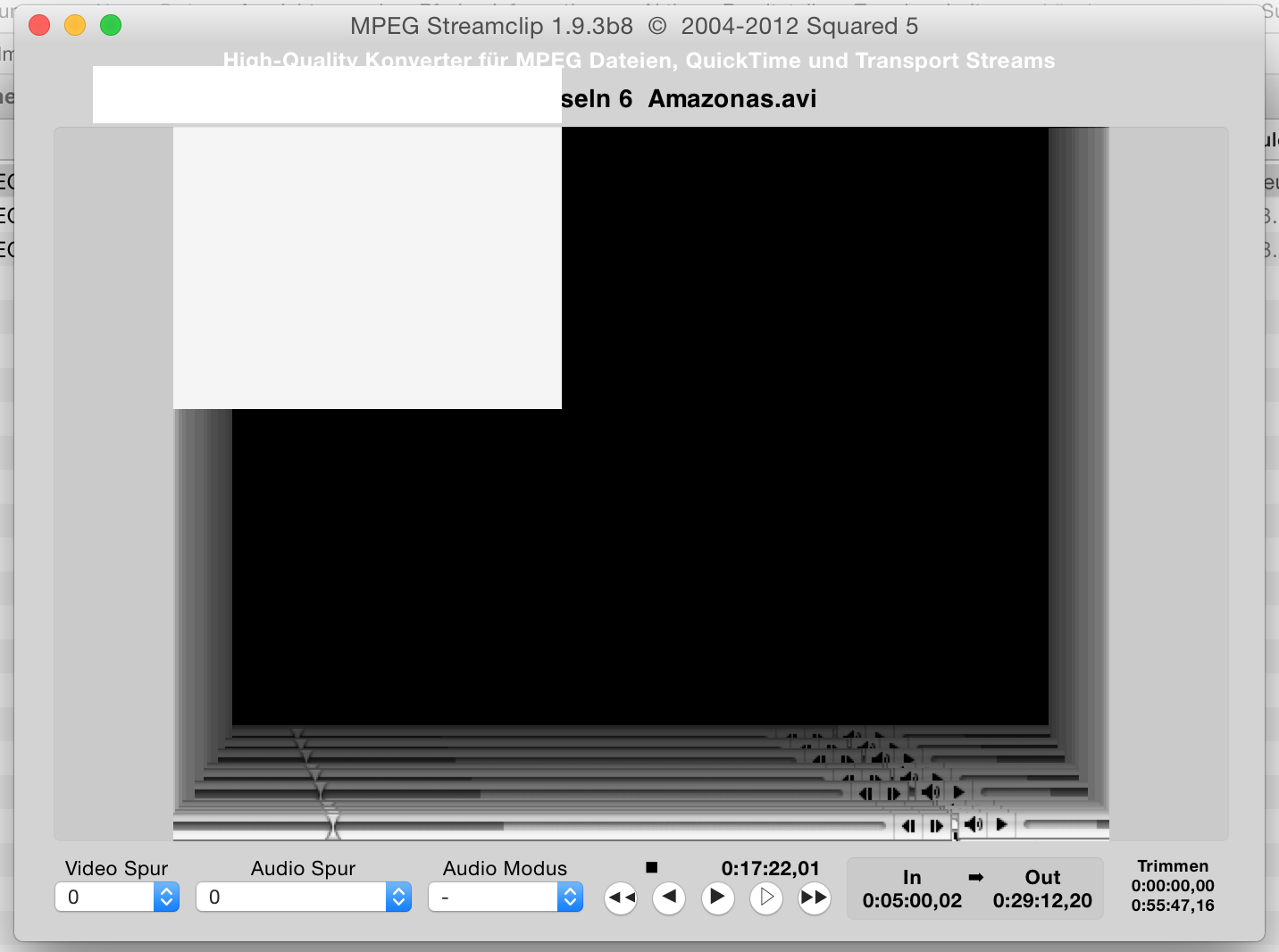

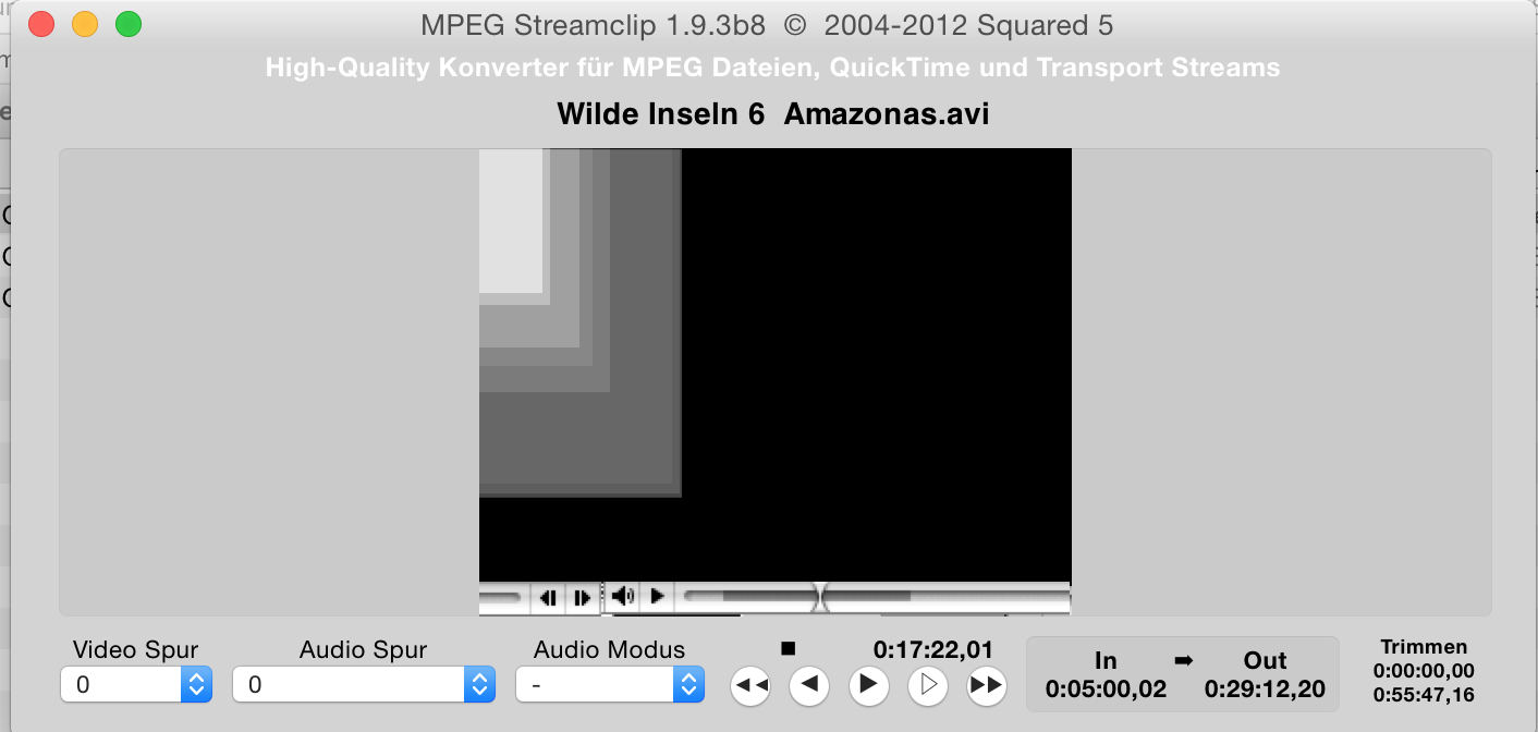

The problem now is that the program window is somewhat screwed up after a few exports, on my MBP 13" retina and Yosemite the window is either unusably scrambled or, when setting the program to "start in low resolution" it is pure white, no video pictures show, I an scroll and hear the sound, but no picture. Crappy app altogether it seems...
No problem, I try here. The ones here are all taken with the app NOT set to "open in low resolution", I only resized the windows several times...

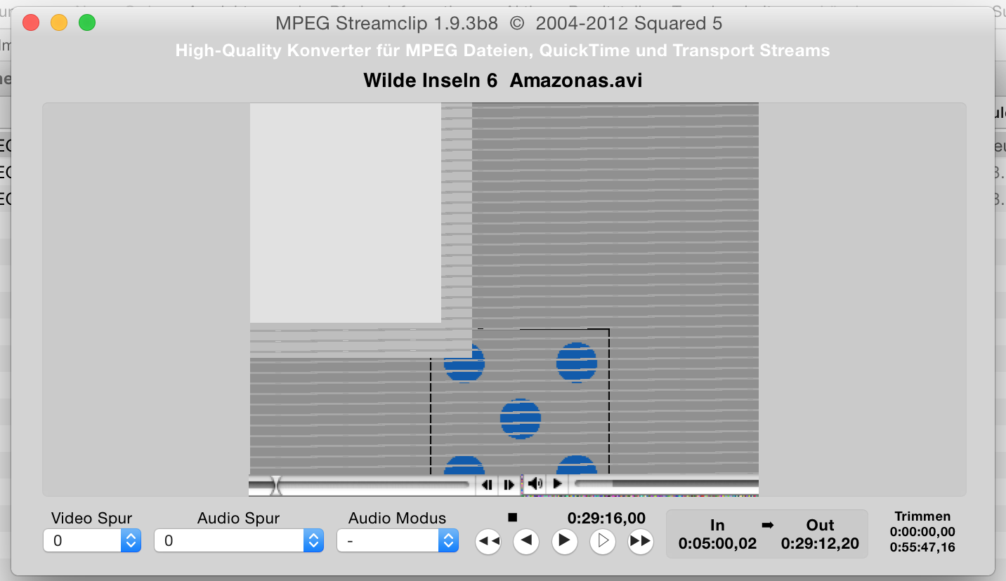

And this is how it looks when I start the app with "open in low resolution". The main window stays white in whichever size I choose. I can play the video and I can hear the sound alright, but simply no image will appear.
Where is the "open in low resolution" setting? I can't find it on the latest version of MPEG Streamclip... This seems to be bugging quite a lot.
I think MPEG streamclip is still less professional as a tool than premiere pro or after effects... I would love to see what happens if you place it in Premiere Pro (the trial version is free)
This is not a setting in the app but in OSX, right-click on the program file and show the app information, there you will find the open option (German OS: In niedriger Auflösung öffnen = Open in low resolution).
