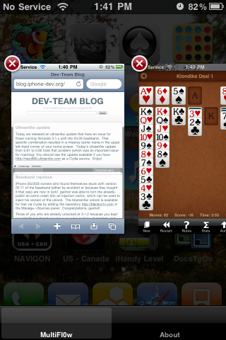

You should update to the latest version. Now you can close out individual apps from within Multifl0w, without opening the app back up:

As much as I loved trying Multifl0w, I had to uninstall it for now. For some strange reason it kept backgrounding the first page after you tap the Contacts Icon when I didn't even touch the Contacts icon as seen in the following screen shot.
It also (and you can't see it obviously in the screen shot) would background the first page after you tap the Mail Icon when I didn't even touch the Mail icon (I would have posted that screen shot also but it listed all of my email information). This screen shot was taken when I had nothing backgrounded and simply invoked Multifl0w.
I'm not sure what is going on but it also wouldn't free my memory back. After closing everything (red "X" all my backgrounded apps) I would be down to 56 MB with nothing running on a 3GS. When I would attempt to Free Up Memory" from SBSettings, I would get a "soft crash" to the Springboard (meaning it would free the memory, but it wouldn't come back to SBSettings, it would crash to the Springboard).
This doesn't mean I'm giving up, I just wanted to mention this in hopes it helps the dev if I happen to not be the only one. I'll keep trying and watch these threads for additional help or info.
Good luck to the rest of you...

I thought a picture would be worth a thousand words but I guess I'm not making myself clear or I'm really missing something here.
What would be the purpose of those apps always being in the "window"? If your screen doesn't look like my screen shot then you're missing what I'm trying to explain.

Ohio,
When the iphone is restarted, by default the phone application is always run. Depending on your mail settings as well (like push, etc), your mail app will always also be running as default. I did some testing and used the terminal app to see all the processes running on the iphone in real-time. For the experiment I am using SBSsettings and Multifl0w to test compared to the terminal of running apps.
I make sure multifl0w shows 0 backgrounded apps and then I powercycle to start clean.
After reboot, running apps in terminal:
Phone and Mail
Running apps according to SBS:
Phone and Mail
Backgrounded Apps according to Multifl0w
None
Now I open up Mail, Phone, Safari, and Tweetie. I close the first three outright and background Tweetie.
Running apps in terminal:
Phone, Mail, Safari and Tweetie
Now I go into SBSsettings and kill safari and tweetie.
Phone, Mail
Phone, Mail
Phone, Mail
Now I reopen Safari and Tweetie, and then proceed to close them via Multifl0w.
Phone, Mail
Phone, Mail
Phone, Mail
Now I kill Phone and Mail via SBSsettings (and repeated by opening them back up and killing by Multifl0w - same result)
Phone, Mail
Phone, Mail
None
SO in this test, even when you kill Phone and Mail, they automatically restart. I can see this happening in the terminal. They close briefly and then reopen. However, you will not see them in multifl0w once you kill them until you click on each one time. After that, they are present in multifl0w as cards to switch between.
Also note that if you do not kill these multiflo0w cards before a restart, such that in multifl0w you see a mail card and phone card, even when you restart, they will be present after the restart is finished. HOWEVER, if you kill these two processes such that there are 0 cards in multifl0w, then restart, they will not automatically show up after the restart, you will have to click on each once to have their cards show up.
Vandam, I am not sure if this is intentional or not, but my first thought at this would be that the multif0w should mimic the processes and therefore these cards can be "X" out but as soon as multiflow is invoked again, they are automatically recreated? Not really sure how to handle it but thats something to think about. Anyone know how this is handled within Kirkae?
Hopefully this helps people understand the processes a little more.
