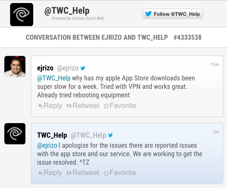

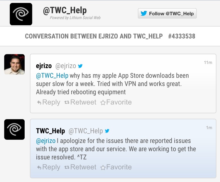

Check out my the reply I got back from TWC
I found this too

When I VPN to work I download fine. When I use my TWC connection it's super slow.
This actually tends to support the idea that the problem is related to the way the carrier(s) is(/are) routing traffic to the specific address(es) involved.

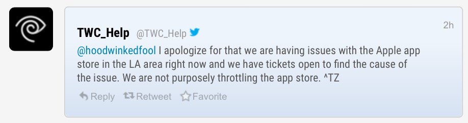

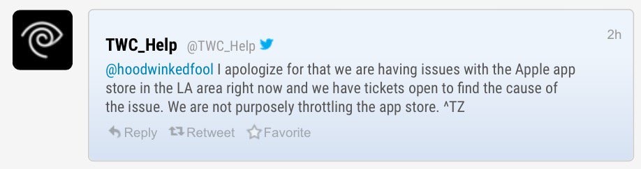

Just got off the phone with TWC. Issue has been affecting them since Thursday PM. There is an issue between Apple's server and their own server. Apparently Apple issued an update to their server on Thursday that caused a disconnect between Apple and TWC. There is no ETA on the fix. This is good and bad news. Good, because now I know whats wrong, bad because its already been almost a week and they still don't have an ETA in sight. They are working directly with Apple. Joy.
So look at that - Apple is partially at fault.
