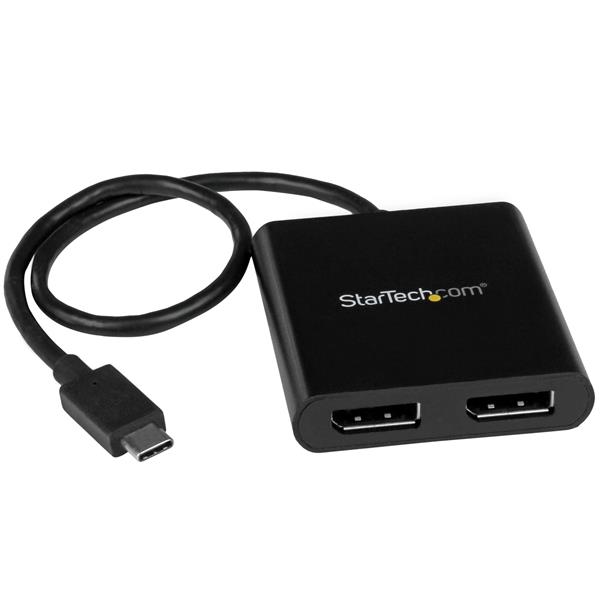

S steve.dix macrumors newbie Original poster Dec 26, 2017 #1 I need to connect a 2017 MacBook to two external monitors via the one USB-C. Is there a way this can be done? Thanks

Apple fanboy macrumors Ivy Bridge Dec 26, 2017 #2 steve.dix said: I need to connect a 2017 MacBook to two external monitors via the one USB-C. Is there a way this can be done? Thanks Click to expand... With an adaptor like this.

F Freyqq macrumors 601 Jan 1, 2018 #4 Apple fanboy said: With an adaptor like this. View attachment 743761 Click to expand... That adapter will not work, as the macbook does not have thunderbolt. I think you can use the apple hdmi, usb, power adapter for one of the monitors, and you'd need a USB 3 to video adapter for the second one.

Apple fanboy macrumors Ivy Bridge Jan 1, 2018 #5 Freyqq said: That adapter will not work, as the macbook does not have thunderbolt. I think you can use the apple hdmi, usb, power adapter for one of the monitors, and you'd need a USB 3 to video adapter for the second one. Click to expand... That adaptor is usb c not thunderbolt.

M Mike Boreham macrumors 601 Jan 1, 2018 #6 Apple fanboy said: With an adaptor like this. View attachment 743761 Click to expand... How would the MacBook be charged with that ?....I don't think HDMI will pass power through to the MacBook. BTW, specs here https://www.startech.com/AV/usb-c-video-adapters/usb-c-dp-mst-hub~MSTCDP122DP#dnlds

ZapNZs macrumors 68020 Jan 2, 2018 #7 Apple fanboy said: With an adaptor like this. View attachment 743761 Click to expand... I was under the impression that because macOS does not support multi-stream that this will not work with Macs?
