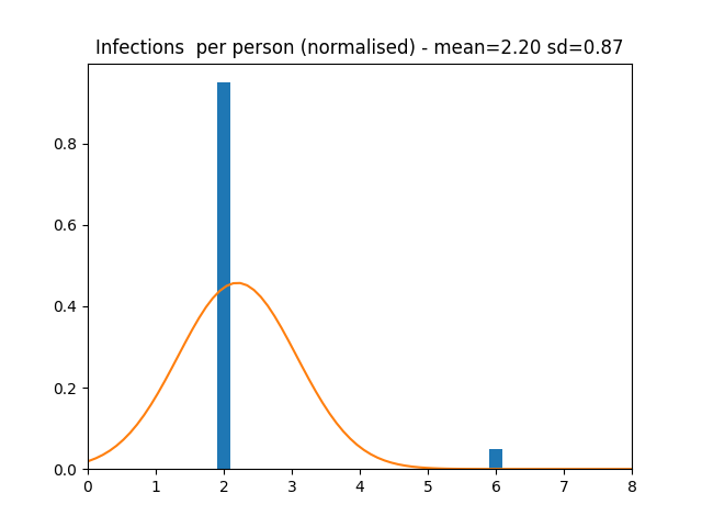

So, let's take your super-spreader model. I'm going to tweak it a bit to actually get an epidemic with R>1. So, let's have 95% of the infected passing it on to 2 others, and 5% passing it on to 6.
The blue histogram shows the actual distribution of the data. If you ignore that distribution, and just take the mean and standard deviation of the data, what you are doing is modelling that distribution with the orange curve (a normal distribution with mean=2.2 and std. dev. 0.87).
Aside: It doesn't actually matter whether that data is the whole population or a sample of it: as long as that sample is >> 100 you'll get approximately the same output. You'll just get less accurate measurements of the population mean and SD. and, yes, of course those means (and the deviations) will be normally distributed - and the SD of the distribution of those averages is not the population SD (although I'm guessing it's related somehow). The CLT will give you nice, accurate measures of the mean and SD, but, as soon as you try and interpret those, you're assuming that orange curve and ignoring the blue one.
So, for starters, if you disregard the real distribution and just look at the orange model, you'll deduce that the chances of anybody infecting 6 others are precisely zip - it's way outside the 99% confidence range. Yet there's actually a 5% chance of that happening.
Here's what happens if you use the "normal model" to measure R and plug it into the herd immunity formula p = 1-1/R (from the Lancet article).

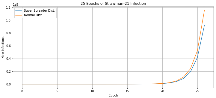

plt.figure(figsize=(12,5))
plt.plot(ssExp,label="Super Spreader Dist.")
plt.plot(nrmExp,label="Normal Dist")
plt.title("25 Epochs of Strawman-21 Infection")
plt.xlabel("Epoch");plt.ylabel("New Infections")
plt.legend();plt.grid(True,which='both');
Note: vertical scale is in the billions.
In this case, the normally distributed population wound up with the larger numbers, but that's mostly because of the first few people randomly infected. Sometimes the super spreader distribution will end with the larger numbers if you randomly infect a 6 in the first few epochs.
After the first few epochs though, the virus is spreading at the same rate through both populations, regardless of their underlying distributions. This is the same data plotted using a log scale on the vertical to better indicate the exponential rates of growth:

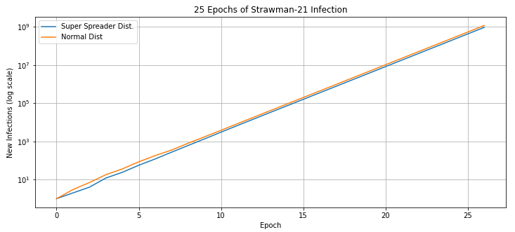

Python:
plt.semilogy(ssExp,label="Super Spreader Dist.")
plt.semilogy(nrmExp,label="Normal Dist")
plt.xlabel("Epoch");plt.ylabel("New Infections (log scale)")
You can see the small variations in the lower left that lead the normal distribution to have higher total values at the end of this simulation, but the parallel lines from that point indicate that the virus is spreading at equal rates in both populations.

What you've come up with is literally just an obfuscated way of calculating the mean of the bimodal distribution.
Yes, you can find R by fitting the data to the model of exponential growth. For the record though, I didn't come up with an obfuscated way of calculating the mean-- after several posts saying "typically you'd fit the data to a model and read out the value of R from the model", I showed you how it would be done.
We know that covid spread is strongly correlated with where you live, socio/economics, variants etc. so the reality is going to be more complicated than your model.
Wait. It was your model...
The point is not the math that you're doing, but the undeclared assumptions you are making before even getting started. That's why you should look carefully at your data - its distribution, any correlations, possible systemic biasses etc. before throwing it into the statistics sausage machine - because that will turn anything into a sausage with 95% confidence.
I feel like there's a weird role reversal going on. You presented a model, then started calling it my model. Then you started making the unsupported assumption that your histogram can be neatly partitioned into two groups of people. I'm simply pointing out that assumption has no basis in the data. The point I'm making isn't about your assumptions being wrong, but the math you're doing.
I don’t disagree with any of this in principle, though the numbers are a bit fast and loose.
