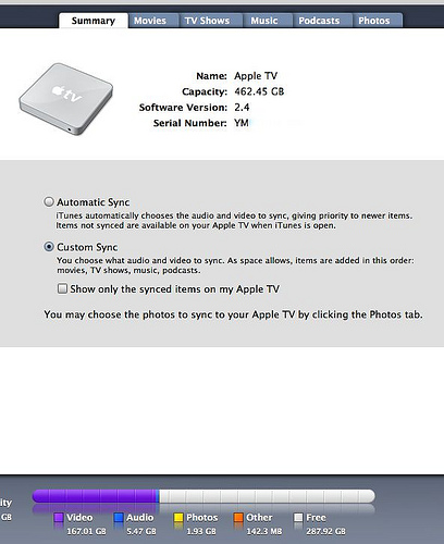

Here's my setup:
Ah, finally got around to getting a 3.5 1tb sata hard drive. I ordered a few IDE to sata adapters off of eBay to test out and I’m happy to say that out of the 4 I got, only one did not work... (And that one was the bi-directional one!)
Anyways, here is a listing that I got my IDE to sata adaptor: http://cgi.ebay.com/ws/eBayISAPI.dll?ViewItem&item=300342322119&ssPageName=STRK:MEWNX:IT
They also have a few other shops on eBay that are named differently because out of the 4 adaptors i bought, 3 came from the same address (though, different store names on eBay and one from Hong Kong.). And they confirmed with me that they have more than 1 store on eBay so pretty much you get the same product like I did, ha. But for $6.50 shipped in the US, I can’t complain any.
