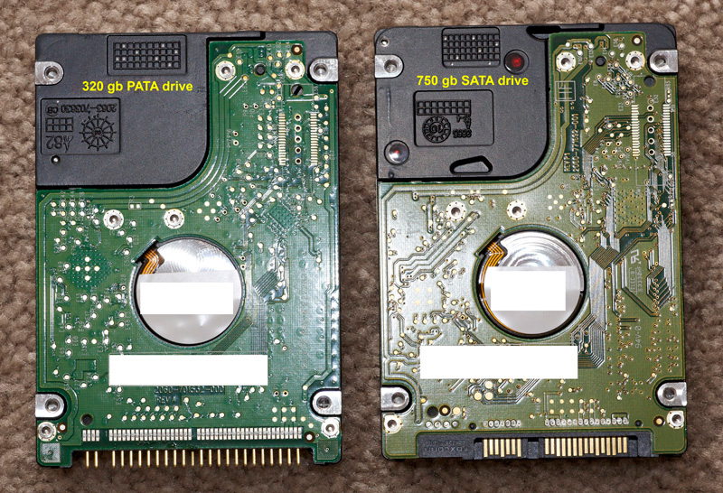

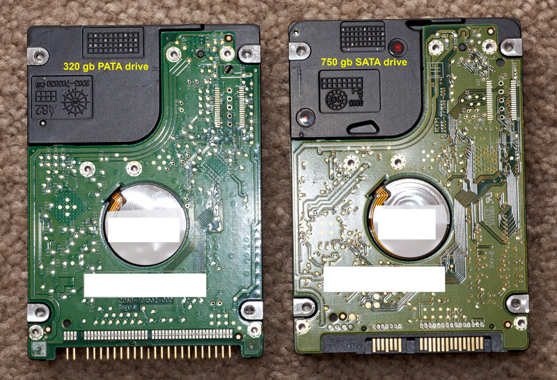

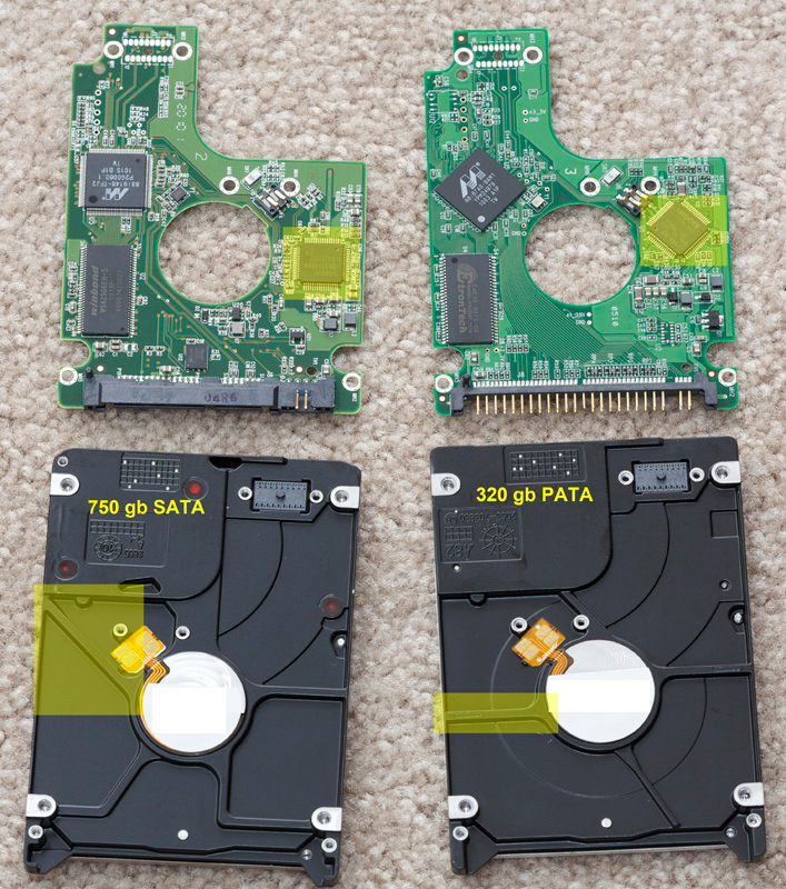

OK, I had a new crazy idea. I was thinking about the lack of PATA drives larger than 320 gb and while looking at the WD 320 gb PATA images on the web, I noticed that its controller board look just about the same as the board on my WD 750 gb SATA drive. So, I bought one and removed the controller boards. Sure enough, almost everything is the same - except for a couple of things, most notably the chassis. As you can see from the yellow boxes below, there's one chip on the boards that are in a different orientation. That appears to be necessary for accommodating the chassis, where on the 750 gb SATA drive there's an angled part of the chassis and on the 320 gb PATA drive it is horizontal. This prevents the PATA controller board from seating properly on the 750 gb drive, thus I cannot put the screws back in to fit the interconnect between the drive and the controller board. Bummer.
Any ideas? Is it possible to swap the drive chassis to put the 750 gb platters in the 320 gb drive controller? Anyone have a dead 2.5" drive who can take it apart to see if it's doable? If this controller can be made to fit the 750 gb drive, then we should be able to get even the 1 TB drive to fit in the Apple TV with a PATA interface.

I would just try and file down that divider that's sticking up which would allow you to fit the controller board on. It's a bit risky though I guess!

I just pulled my Apple TV's original 160 gb drive and it also is a WD. I removed its controller board and it's exactly the same as the 320 gb drive's controller. I wish there were an easy way to get it to mate with the 750 gb drive.
While I could be wrong here, I don't think what you're proposing to do by swapping driver boards will work. While the driver board may look and be exactly the same component wise the firmware loaded on to them will be different depending on the capacity of the disk. The firmware contains the geometry information for the disk including the number of platters, how many track are on the platters and so on. This information is needed so that when data is read/written to and from the disk the disk knows where to position the read heads and which platters to access.
Like I said I could be wrong, but I would be very suprised if it did work. If you're brave enough to try it then I'd love to know if it works😀
I have previously swapped controller boards between same-model disks of different capacities without issues, so this may not be the case.
