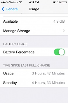

My iPhone 4S's battery life is terrible!, it barley even lasts. I got this iphone in September of 2013 from online so it doesn't have warranty anymore. Is this normal or not? And any tips to make the battery life better? I have most things turned off like Bluetooth, the brightness is slow, only using wifi.

what exactly are you doing for those 3 hours? video playback? looks like pretty heavy use for only 4 hours of standby
No videos, I'm usually just on social networks or texting! I do go on twitter and whatsapp a lot but I don't see how it would use that much battery
Looks like you don't have the greatest cell coverage in your area. That could easily eat through your battery.
Otherwise, usage numbers are virtually useless since we can't see exactly how you're using your phone.
Turning a phone to airplane mode, setting a song to play on repeat, and turning off the screen will count as usage and give you days.
Likewise, playing an intensive game, brightness on high, and a gps running in the background will also count as 'usage' and likely only give you minutes.

The first self made check you could do is to download iBackupBot and check your battery info. If it is below 1000 mAh like I strongly suspect, your battery need a replacement. If it is in the 1100-1200 range the reason could be a very spotty network coverage (but you said it was mainly wifi) or some apps working in background.

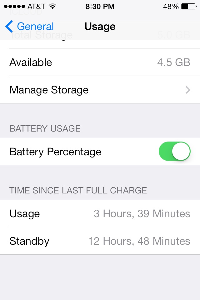

I have a 1 year old iPhone 4 I have never changed the battery in it but I think it's pretty good.
