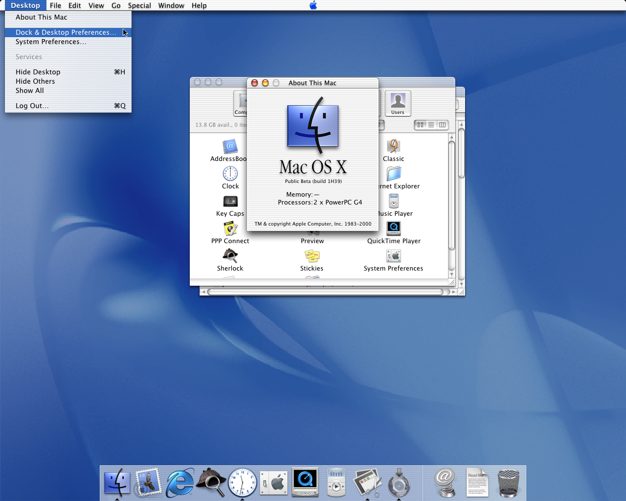

I installed Public Beta on the Sawtooth and imaged it over using a G5's IDE connection and the GigE in TDM. The GeForce 4MX gets stuck on the happy Mac, so I found a GeForce 2MX and put it in. Boots in a wonky resolution, gets stuck on the blue screen. Put in the Rage 128 Pro and...
Success! 😀 Mac OS X Public Beta on a dual 500 MHz G4 with 128 GB SSD and 2 GB RAM (so much RAM that About This Mac won't even show it, apparently).
I'll have to play around with the OS some more. I have already noticed its unfinished nature somewhat, like @bunnspecial said a while back Command-Shift-3/Command-Shift-4 does not work.

And you didn't believe me when I said Command+shift+3 didn't work 🙂 . I don't think it worked until 10.1 or 10.2.
You're right, when I tried in 10.0 it didn't work as well. Grab.app has worked fine for me though in both versions.
