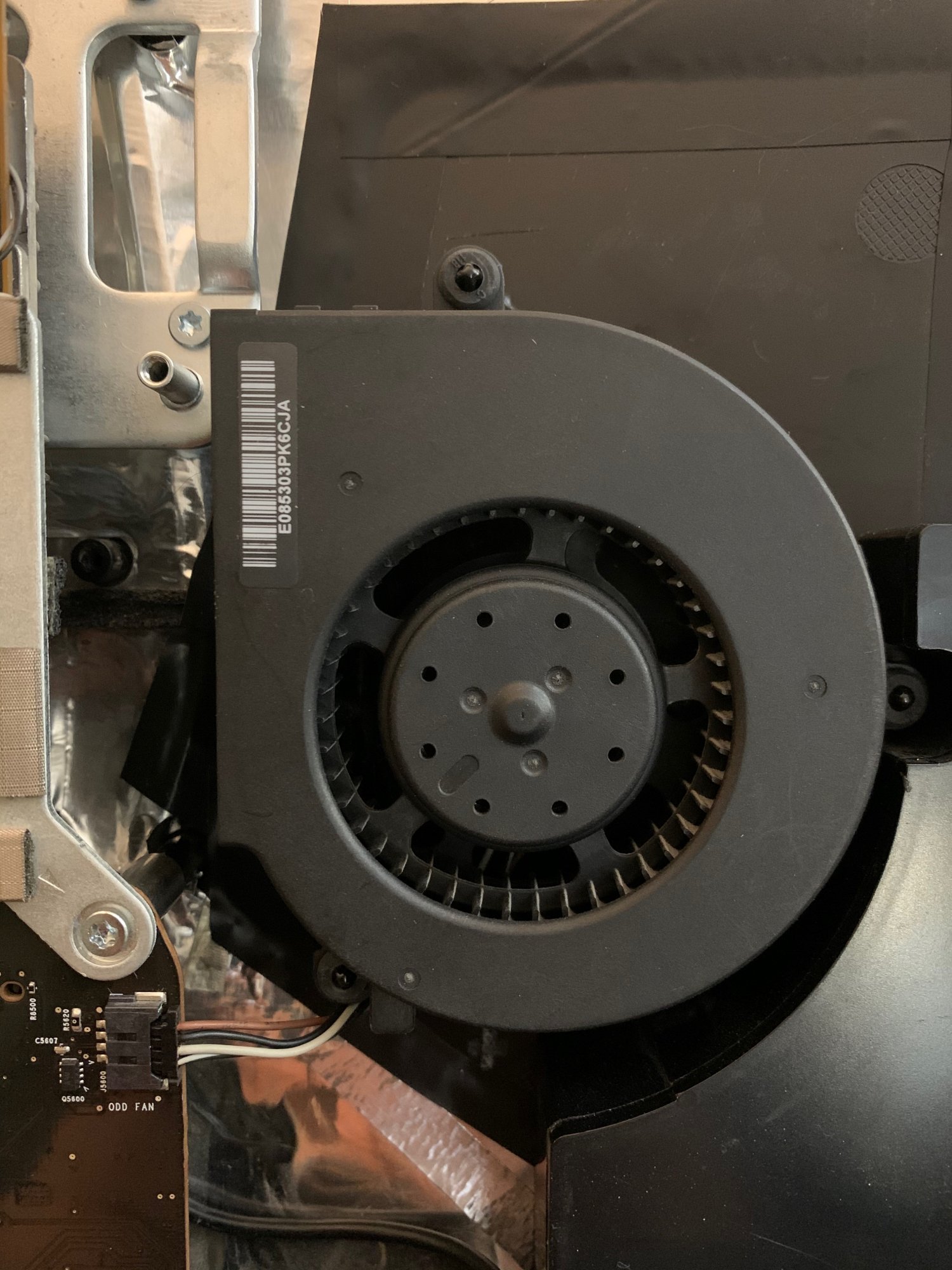

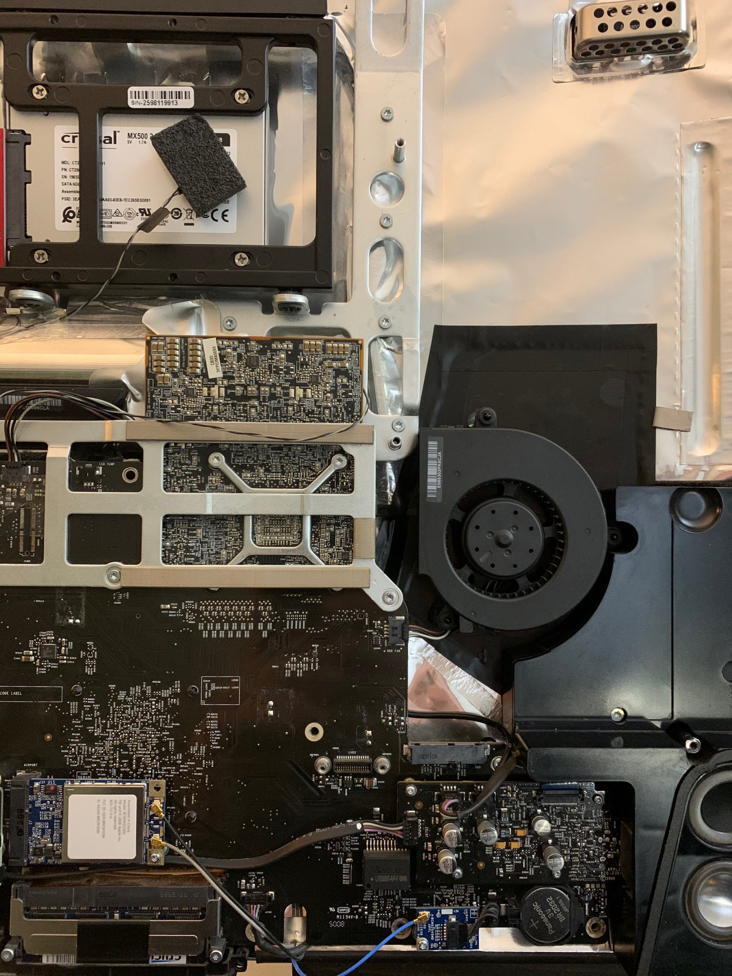

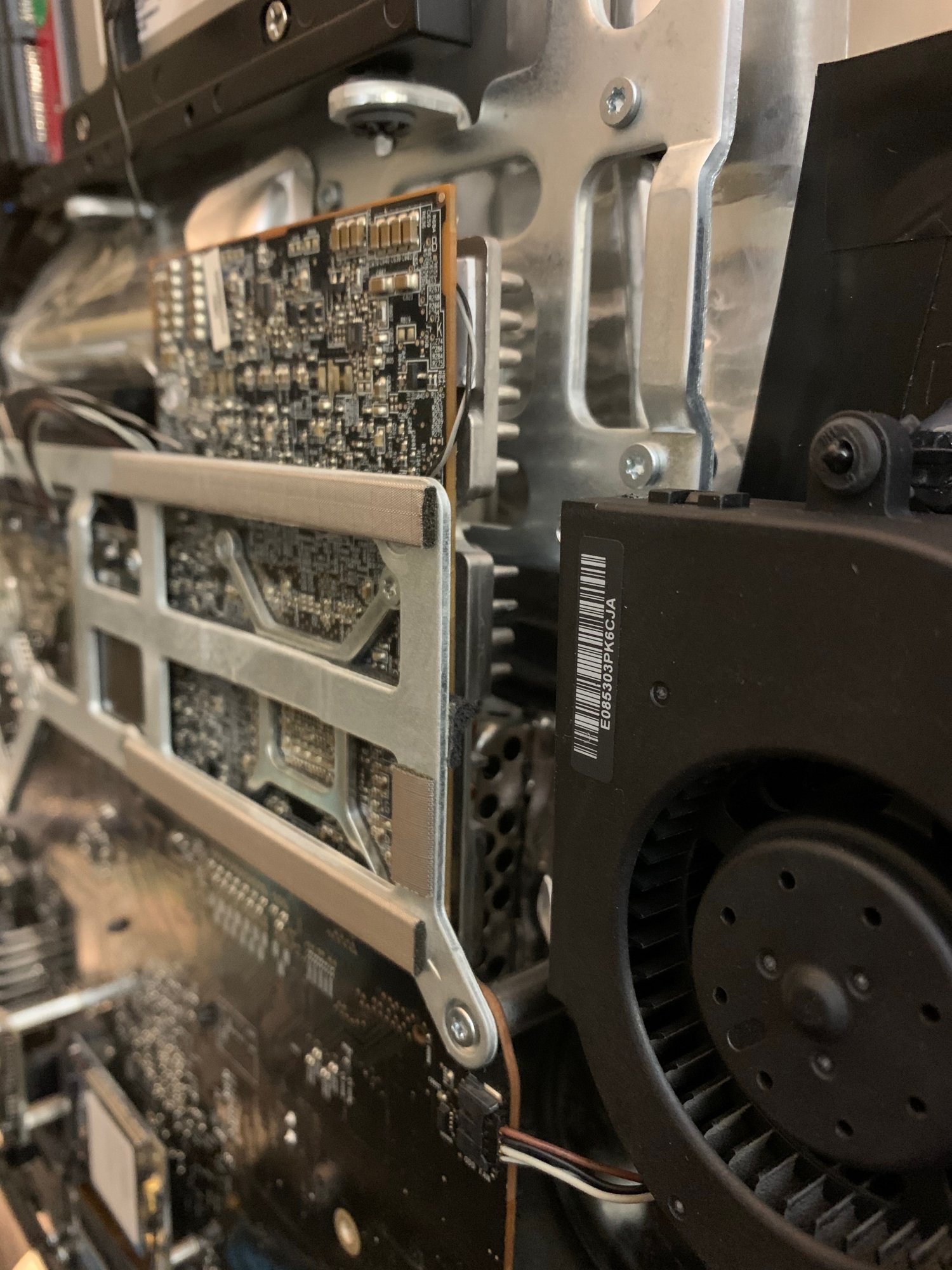

Update as of writing this; GPU came in a day early, so it's installed and working fine. Actually, I modified the cooling to work better. A quick description of what I did was remove the DVD ROM... because, well I have no use for it. There was a fan to cool it, so I rotated it to face the GPU. I had to cut 2 of its mounts and use high strength hot glue to place them into the new position. The DVD ROM heat sensor was then wedged in-between the GPU and heatsink as a way to automatically control the new-found GPU fan. The heat pipe and cooling fins still exist, but are placed after the cpu cooling fins. I believe this posed two problems;
1. The GPU cooler runs hotter and the heat had to travel further to cool.
2. The hot air from the CPU being cooled was the same air that was supposed to cool the GPU, so I believe that the GPU heatsink was heat-soaked and just couldn't effectively cool. A fan blowing on the GPU heatsink attached to the card (not the fins) allows for cooler overall operation. Furthermore, you can control all this with a fan controller app.
